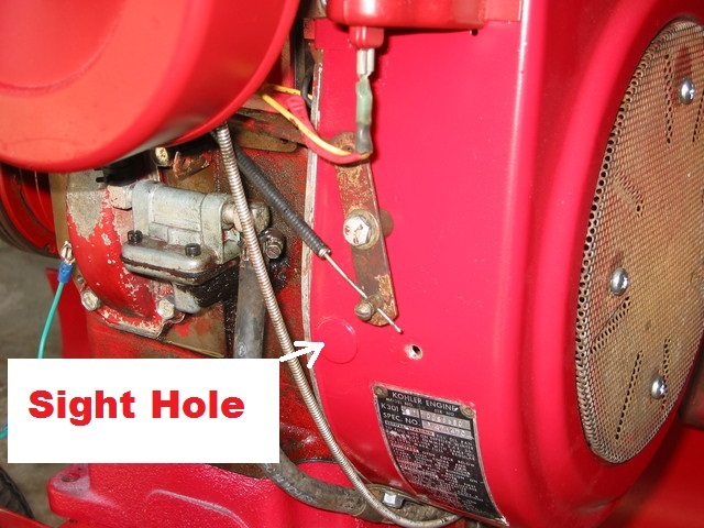

953 nut 63,106 #2 Posted May 3, 2017 Install the points and turn the engine over bu hand. Observe the points and the plunger that opens them, when the plunger reaches the furthest open position you will be able to set them at .020 to.018". This static timing will set them for proper timing. Kohler static_timing.pdf 4 Share this post Link to post Share on other sites
