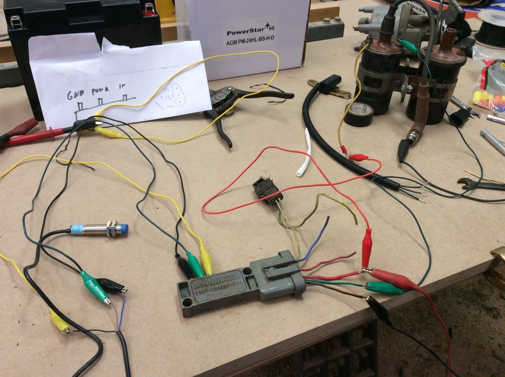

Actually the TFI system is full electronic, using a reluctor wheel and pickup unit inside the distributor. It came after the EEC IV system which was Fords first electronic ignition system. That system used a box that was fender mounted, also with a reluctor and pickup in the distributor. The TFI came later and was mounted directly to the side of the distributor. I have experimented some with crank trigger ignition using both the original Ford module and the TFI, using an npn style prox sensor as described on Brian Millers site. I was trying to use it on the P224 on my skid loader, but never could get the timing where I needed it to be. Since I really needed to use the machine and was tired of fighting with it (and SWMBO was running out of patience), I finally bought good used stock parts from Boomer and gave up for the time being. I still have all the pieces laying around here and may try it again at some point. The only reason I tried it to begin with is that I already had everything on hand here except the pickup, and I was facing replacing both the module and coil on the P224. A lot of money that I was trying to avoid having to spend. Oh well......
This was my test bench when I was experimenting with the TFI unit.

Looking at your sensor I'm wondering it that could have been the problem because that type is slower in that the part I posted. Your sensor is more suited as a industrial counting device.
