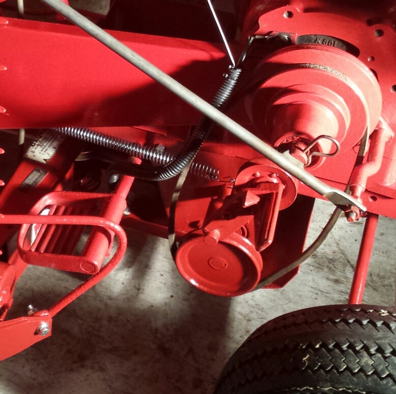

hcminis 1,762 #13 Posted May 10, 2017 Well, after working on it a little more, found out it is the early SMS-425. This was for the Round Hoods....so....may be trying to mount it on the 701. OH..... additionally, if anyone has pics of yhe engagement pedal setup I wpuld greatly appreciate it 4 Share this post Link to post Share on other sites
Thegearhead0324 1,361 #14 Posted May 10, 2017 Here's a pic of mine... not sure if it's the same set up.. 1 Share this post Link to post Share on other sites
hcminis 1,762 #15 Posted May 11, 2017 14 hours ago, Thegearhead0324 said: Here's a pic of mine... not sure if it's the same set up.. Thank you sir. That does help. So the foot control on your setup is just a tensioner pulley and not serving as the PTO since you have to engage the PTO with a handle correct? Share this post Link to post Share on other sites

WHX?? 55,094 #17 Posted May 11, 2017 I would think you don't even need the pedal since you are running right off the PTO? Not an expert by any stretch but the foot pedal was just for the round hoods? Nice patina BTW 1 Share this post Link to post Share on other sites
Racinbob 12,782 #18 Posted May 11, 2017 Early square hoods still used the pedal like the round hoods. You're right about hcminis not needing it though since he can disengage the pto. 1 Share this post Link to post Share on other sites
oliver2-44 11,226 #19 Posted May 11, 2017 Nice find , double jealous Share this post Link to post Share on other sites
hcminis 1,762 #20 Posted May 12, 2017 I will be installing the sickle bar on my 701. So I need the pedal. Now the task of taking the hack drive pulley extension off. Found thr pedal and other arms needed. Share this post Link to post Share on other sites
Thegearhead0324 1,361 #21 Posted May 12, 2017 To answer your question about my pic, couple reasons I have the pedal with the pto. 1 cuz I wanted the tension on the belt and not try a bunch of belts. 2 it's nice for safety reasons. The pto and pedal have to be engaged. If you can find one it just slides on the shaft and hook a spring to the frame. 1 Share this post Link to post Share on other sites
