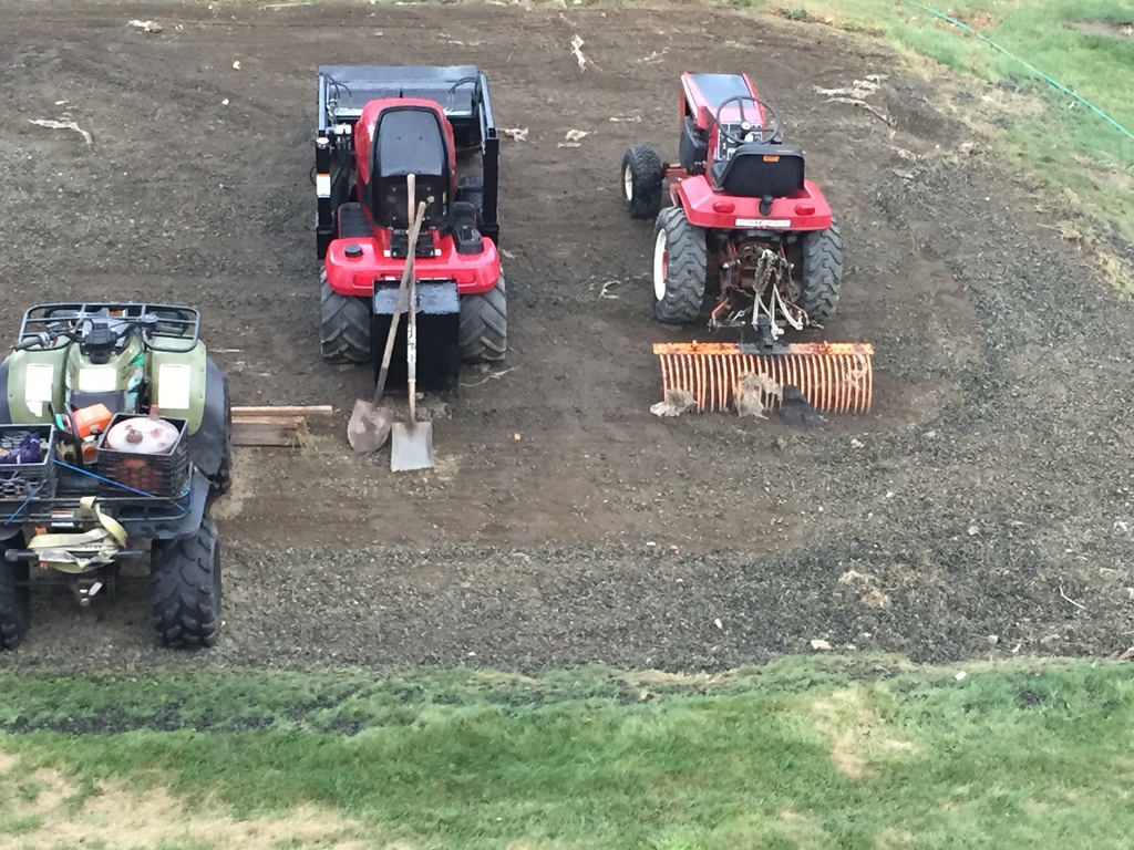

Stike 204 #1 Posted May 1, 2017 Hello everyone, spring is finally here and I think it's time for lug tires on my c195 (a lot of wet muddy ground), my problem is I can't find 27x9.5x15 tires and am at a loss as to where to go, anyone with suggestions (tire source, alternate tire or rim size etc.)would be greatly appreciated. Thank you, can't wait to get back on the horse. Share this post Link to post Share on other sites

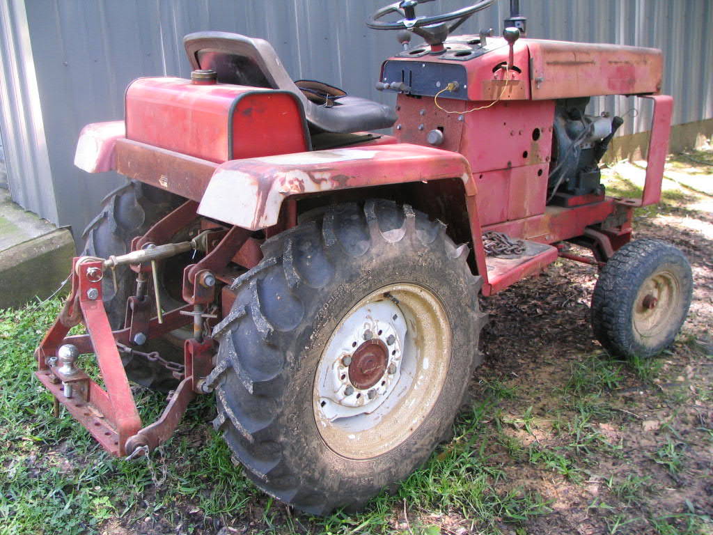

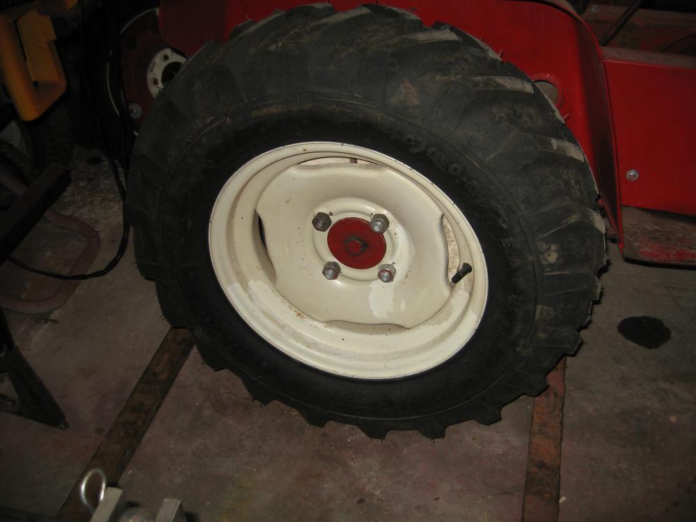

stevebo-(Moderator) 8,601 #2 Posted May 1, 2017 Sorry but this is the best picture I have. These skidsteer type tires work great. 3 Share this post Link to post Share on other sites

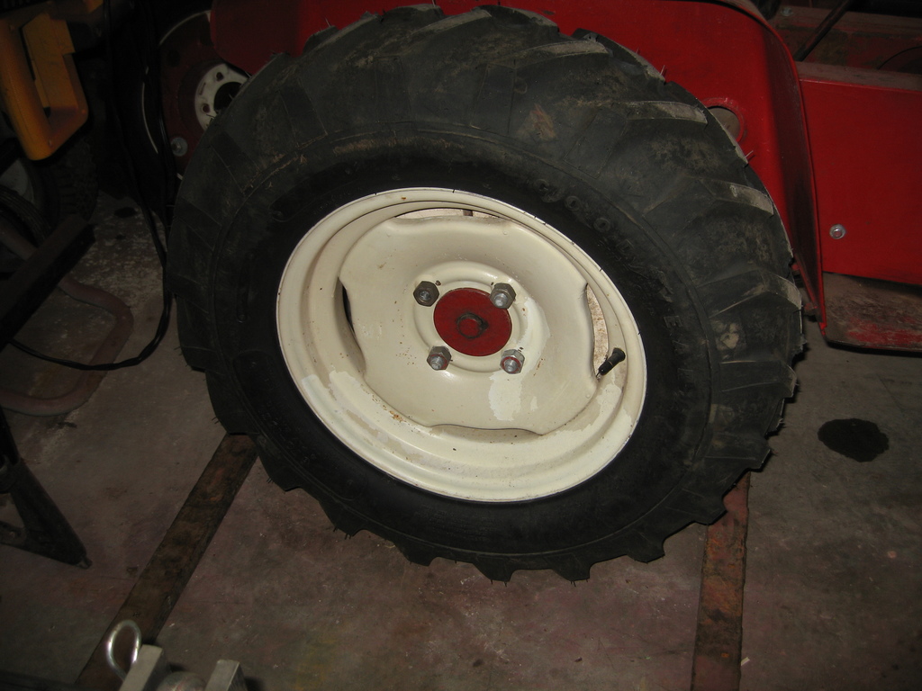

Aldon 4,828 #3 Posted May 2, 2017 15 inch Ag's are elusive and rare and old stock if and when you find them. Other than at stop and go tire. I think it's either a 6.7 or 7.6 wide Ag they sell. Kind of narrow for my taste. i swapped out Hubs to D series and bought a rim blanks and centers from miller tire to fit 29x12.5-15 AG's on. Had to do minor mod work to get clearance fit... 2 Share this post Link to post Share on other sites

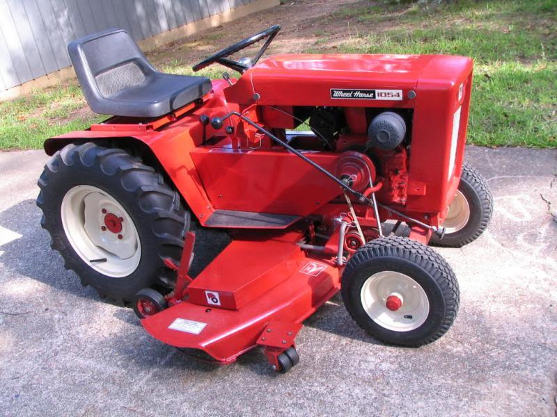

pacer 3,177 #7 Posted May 3, 2017 And I'm sure you noticed the price too -- $88!! and as I recall his shipping was very reasonable also. Another tidbit of info - the tire is exactly 33 inches tall which will be of interest to you T-Mo. On my 1054 it was pretty close to the fender, something like 3/4-1" but that was enough. The D has a good bit more room than that.... 4 Share this post Link to post Share on other sites
T-Mo-(Moderator) 4,691 #8 Posted May 3, 2017 2 hours ago, pacer said: And I'm sure you noticed the price too -- $88!! and as I recall his shipping was very reasonable also. Another tidbit of info - the tire is exactly 33 inches tall which will be of interest to you T-Mo. On my 1054 it was pretty close to the fender, something like 3/4-1" but that was enough. The D has a good bit more room than that.... That is a nice looking 1054. Real nice. 2 Share this post Link to post Share on other sites

Stike 204 #12 Posted May 12, 2017 Well I decided to go with carlisle Trac chief 27x8.5-15, could've gone with 28x10.5- 15 after seeing them but they work great in deep mud plus they weigh about 3 times what the turf tires did at 38lbs each but putting 6 ply tires on with portable tire changer is not easy. Share this post Link to post Share on other sites
Stike 204 #13 Posted May 12, 2017 Had to renew membership to upload pic, didn't realize it expired. 2 Share this post Link to post Share on other sites
Adams94 1,069 #14 Posted July 23, 2017 On 5/12/2017 at 7:36 PM, Stike said: Had to renew membership to upload pic, didn't realize it expired. I have these on my c195 and I like them a lot Share this post Link to post Share on other sites
