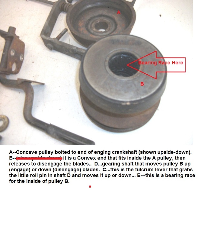

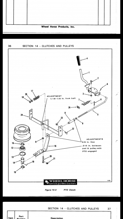

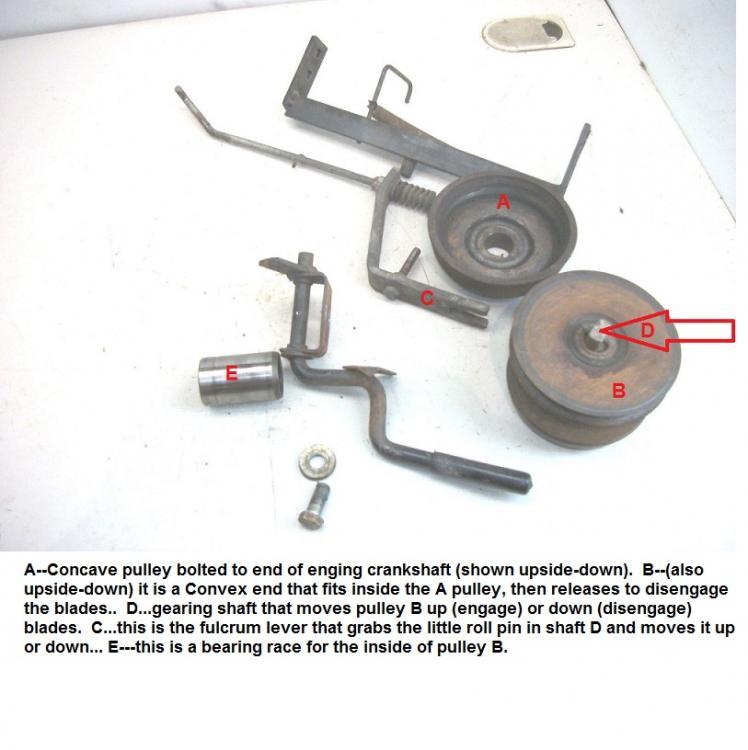

Could someone explain to me how the clutch assembly works to engage the mower blades? My blades spin constantly and the only way to stop them is to shut the tractor off. On part 16 I'm missing the brake pad. Part 14 I think is missing all together. If someone could explain how this assembly works it will help me better understand what is broken/missing. Also any insight on replacement parts would be great. This is my first horse. Thanks alot
daveoman1966
#14 is a 'plunger' that moves the convex shaped PTO bell up to engage / disengage the engine concave pulley to disengage the blades.  Part 16 is a fulcrum point that moves # 14 up / down.  Thi9s is REALLY TUFF to explain is isn't a very good design, but I have part 14 ifd you need it...  maybe a few other partgs too.

Without haveing this in hand, it is almost impossible to show how it works.  Try to soak up these pics....best I can do.
That fulcrum lever rocks back / forth and moves the convex pulley up / down to engage the cocave pulley that is bolted to the engine crankshaft.
