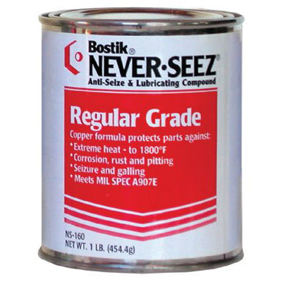

Tankman 3,528 #13 Posted May 6, 2017 (edited) On 5/1/2017 at 8:23 AM, 6bg6ga said: Unfortunately there are some around that swear off any type of anti-seize mention. I use it on any bolt now. Small can on Never-Seez and an acid brush last years. Every bolt gets a dab! Edited May 6, 2017 by Tankman 2 Share this post Link to post Share on other sites
