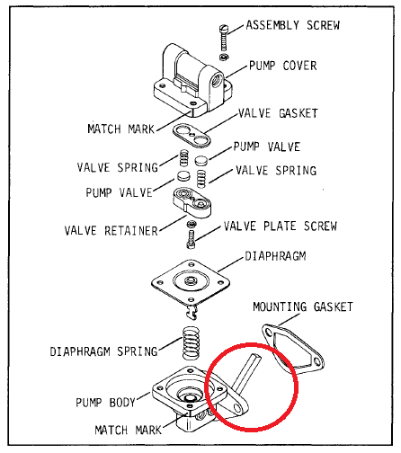

rmaynard 16,495 #2 Posted April 26, 2017 Could be the carburetor. If you haven't taken it apart to clean it, the float valve may be stuck closed. You can also take the hose off from the pump to the carburetor, have someone turn the engine over and see if gas is spurting out of the pump. If not, be sure that when the new pump was installed that you placed the lever on top of the camshaft and not under it. 3 Share this post Link to post Share on other sites

rmaynard 16,495 #5 Posted April 26, 2017 Take the pump off and watch the lever as you put it in. Also, don't install it upside down. Lever needs to point upward. 1 Share this post Link to post Share on other sites

howell1000 35 #7 Posted April 27, 2017 Thanks guys for all the help took pump off checked everything out made sure the pump lever was above camshaft and now I can mow thanks guys for all the help 1 Share this post Link to post Share on other sites
Ed Kennell 42,830 #8 Posted April 27, 2017 So, was the lever below the shaft? Share this post Link to post Share on other sites
howell1000 35 #9 Posted April 27, 2017 yes lever was below the shaft Share this post Link to post Share on other sites
