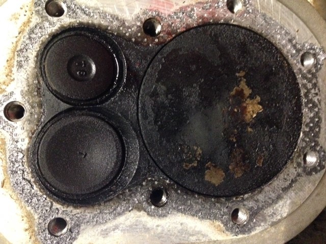

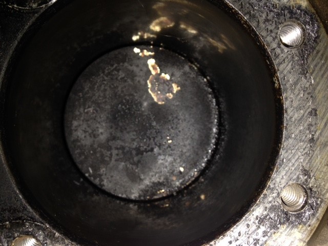

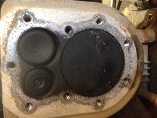

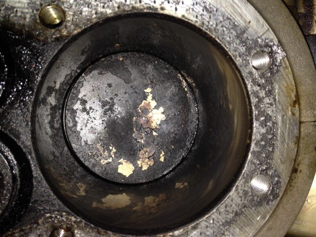

soofoodude 6 #1 Posted April 25, 2017 Greetings - It's springtime in the northern prairie and I am fighting with my 520H. Five foot into my first pass of the season I got a medium sounding clunk, followed by a heavy, steady stream of blue smoke and loss of 95% of the power. I limped it back to the barn. Now, I can build you a house or a bridge - but significant wrenching is not my forte', so my very charitable little brother did a quick autopsy on it tonight and sent me the following photos. The engine still idles (with plenty of smoke) and has 680 hours. Other than regular oil lube & filters and blowing out the cooling fins from time to time, it has had no preventive maintenance (valves, etc.) or overhaul. I am thinking about a Honda or Vanguard Repower. Any insight from the real mechanics out there? 1 Share this post Link to post Share on other sites

Achto 30,819 #7 Posted April 25, 2017 I noticed that both pic's show the pistons are at TDC. Do both pistons move when you turn the crank? If they both move then I doubt that a rod is broken, you could still have a damaged rod though. It looks like your failure happened to the side in the first pic. Mass amounts of blue smoke is usually a oil burning issue caused by bad rings, same issue will cause oil to be forced out of the breather into the air cleaner. The nice carbon build up on the pistons shows that this was not an issue that has been going on for a while, it happened all of a sudden. My guess will be broken rings / damaged piston. Share this post Link to post Share on other sites
