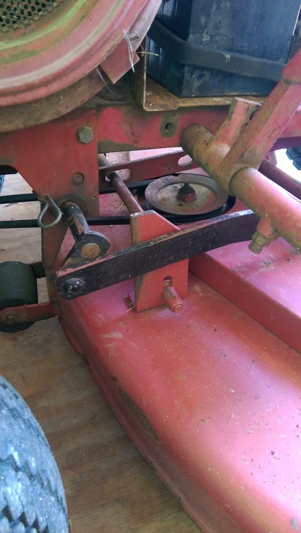

sdhdcouple 133 #1 Posted April 24, 2017 (edited) I put a newer style deck on my 1267. pretty nice deck but it seems to pitch left and right when mowing in rough ground. makes the grass look choppy and uneven. I thinks I might have something not right. does anyone have a picture of a 48" deck. looking for the area around the area where it attaches to the attach point under the motor. I think something not right. can't lift it either with the left lever. so I am sure I have something upside down or inside out. Edited April 24, 2017 by sdhdcouple Share this post Link to post Share on other sites

sdhdcouple 133 #4 Posted April 24, 2017 (edited) ok try this, here is the way it is on the tractor now Edited April 24, 2017 by sdhdcouple Share this post Link to post Share on other sites

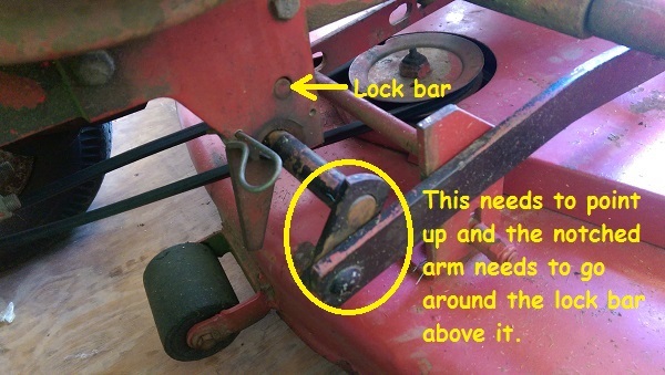

953 nut 62,356 #5 Posted April 24, 2017 The shaft that engages the mid mount needs to be turned up, not down as you have it. Also, there is a notched arm that needs to be over the round lock bar. Don't know if this is the exact mower you have but the attachment is the same. 1 Share this post Link to post Share on other sites
sdhdcouple 133 #6 Posted April 24, 2017 If I turn that up my notch will be down Share this post Link to post Share on other sites
