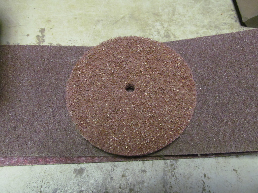

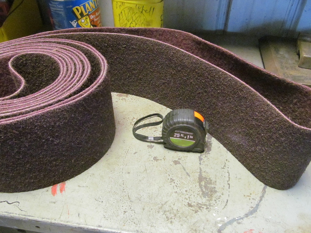

Ed Kennell 43,799 #1 Posted April 24, 2017 Does anyone recognize this or know what it may have been used for? It is the medium grit maroon 6" wide x 26' long x 1/8" thick. I bought it for cheap with the intensions of cutting out pads for sanders and angle grinders. But before I cut it up, I thought it may be worth some big bucks to the person that has the machine it was designed for. 4 Share this post Link to post Share on other sites
rmaynard 16,699 #2 Posted April 24, 2017 Interesting item Ed. A Google search finds similar belts that are not cheap. You might want to do some more research before you cut it up. Where did you acquire it? I buy maroon and gray Scotch Brite pads for body work on the horses. 1 Share this post Link to post Share on other sites
Ed Kennell 43,799 #3 Posted April 24, 2017 I use the round maroon pads on 4.5" angle grinders and on bench grinder. They really work great for removing rust and paint and I use the finer green pads for polishing SST and chrome. I was about to try cutting pads on the band saw when I did realize this is probably worth some big bucks. I picked it up at the local auction. Share this post Link to post Share on other sites
DennisThornton 4,772 #4 Posted April 24, 2017 Somebody somewhere wants that far more than you want a few disks. 1 Share this post Link to post Share on other sites

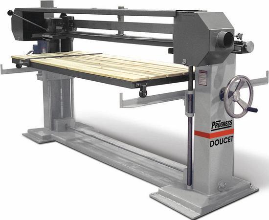

gwest_ca-(File Mod) 11,848 #5 Posted April 24, 2017 I have a 8' stroke sander that uses a 6" x 22' belt so 26' would fit a 10' model. Garry 1 Share this post Link to post Share on other sites
ohiofarmer 3,383 #6 Posted April 24, 2017 Please show us piccs of the stroke sander and tell us what it is used for. 1 Share this post Link to post Share on other sites
AMC RULES 37,250 #7 Posted April 24, 2017 https://www.google.com/search?q=10'+stroke+sander&rlz=1C1CHBF_enUS731US732&espv=2&source=lnms&tbm=isch&sa=X&ved=0ahUKEwiMnL2o6bzTAhXGSCYKHc1yCZAQ_AUIBygC&biw=1920&bih=950#imgrc=_ 3 Share this post Link to post Share on other sites
gwest_ca-(File Mod) 11,848 #8 Posted April 24, 2017 Stroke sanders have a table that can be raised and lowered to accommodate the height of the object to be sanded. It also travels on rollers so the object can be pushed into or out of the machine. The object is raised to a point where it just clears the belt. Inside the loop of belt is a travelling bar that has a graphite covered pad that can be raised and lowered by a lever to push the belt down to the object being sanded. Simultaneously the bar allows the pad to be rolled on bearings from one end to the other. One hand on the pad lever pushing the belt down to the object and the other rolling the table in and out as you work from one end to the other. The object on the rolling table and/or the pad needs to be constantly moving to prevent gouging. I can do about 30" of a 8' sheet of plywood and turn the sheet around to do the remaining 18". My main use has been to sand book-matched slabs with the edges joined to make 5' x 8' table tops. One was 6" thick and that is when I motorized the table elevator. Garry 2 Share this post Link to post Share on other sites
Ed Kennell 43,799 #9 Posted April 24, 2017 So Garry, Your sander uses smooth paper or cloth backed sanding belts for wood finishing, correct? I assume this scotch brite belt would be used for metal polishing, but it is not smooth on the back side and would probably abrade a backer pad. Share this post Link to post Share on other sites
gwest_ca-(File Mod) 11,848 #10 Posted April 24, 2017 Yes cloth backed like the small 6" x 48" belts or 3" x 24" for portable sanders. I will guess the backer for the pad material is just a plain metal pan. Wonder if that is what they use to get the uniform scratch pattern in stainless steel. Garry 2 Share this post Link to post Share on other sites

gwest_ca-(File Mod) 11,848 #12 Posted April 25, 2017 Bought this one from a small company that neither the owner or any of his 5 employees could use it without gouging the wood. Took the gamble. Set it up and had it wired. Turned it on and realized they had it running backwards. They were trying to push the belt across the surface to be sanded. Reversed the motor and bingo. Garry 2 Share this post Link to post Share on other sites

gwest_ca-(File Mod) 11,848 #14 Posted April 27, 2017 Lots of cameras with pics but no software or hardware that will work anymore. Found this 5 footer online but mine is 8 ft. Garry Adding - just realized this one has no belt on it. It runs under the pad at the far end. That lever is used to lower the pad that pushes the belt down to the surface being sanded and that assembly runs on bearings along the flat bar in the center the full length of the table. 1 Share this post Link to post Share on other sites
