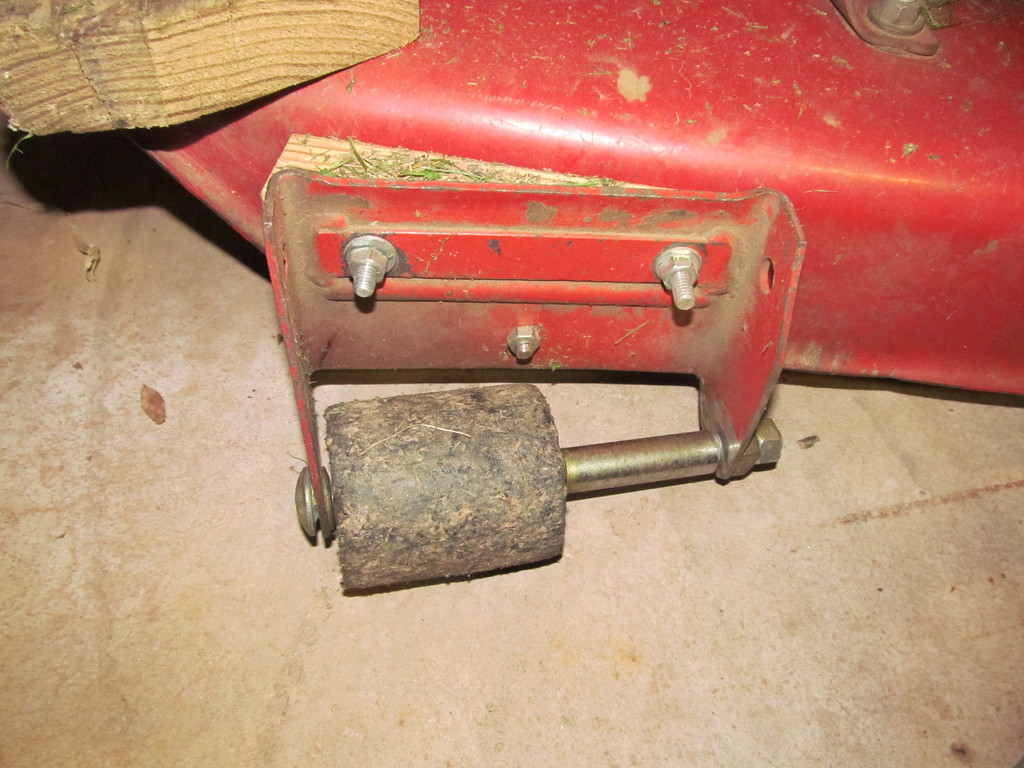

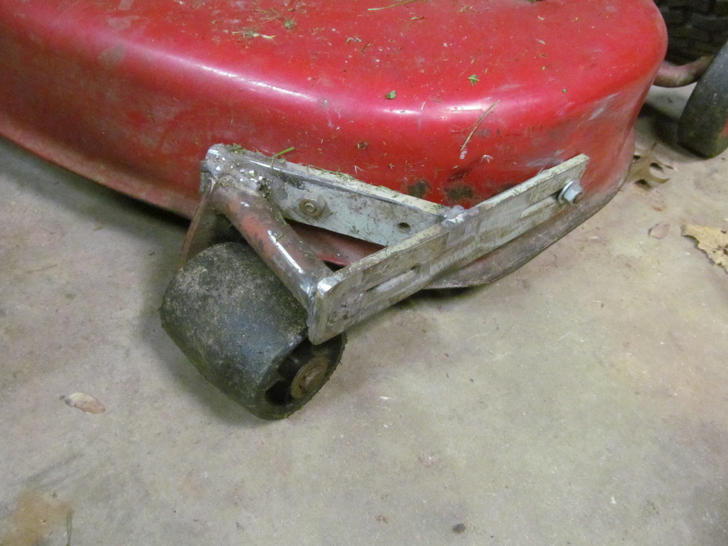

Ed Kennell 45,027 #1 Posted April 24, 2017 There was a recent post on the 42" deck scalping problem. My deck worked fairly well on good flat turf, but the unsupported front corners did dig in and scalp when turning into a slope. I added a roller at each corner and it made a world of difference. It even cuts smoother on the flat level areas. 7 Share this post Link to post Share on other sites
