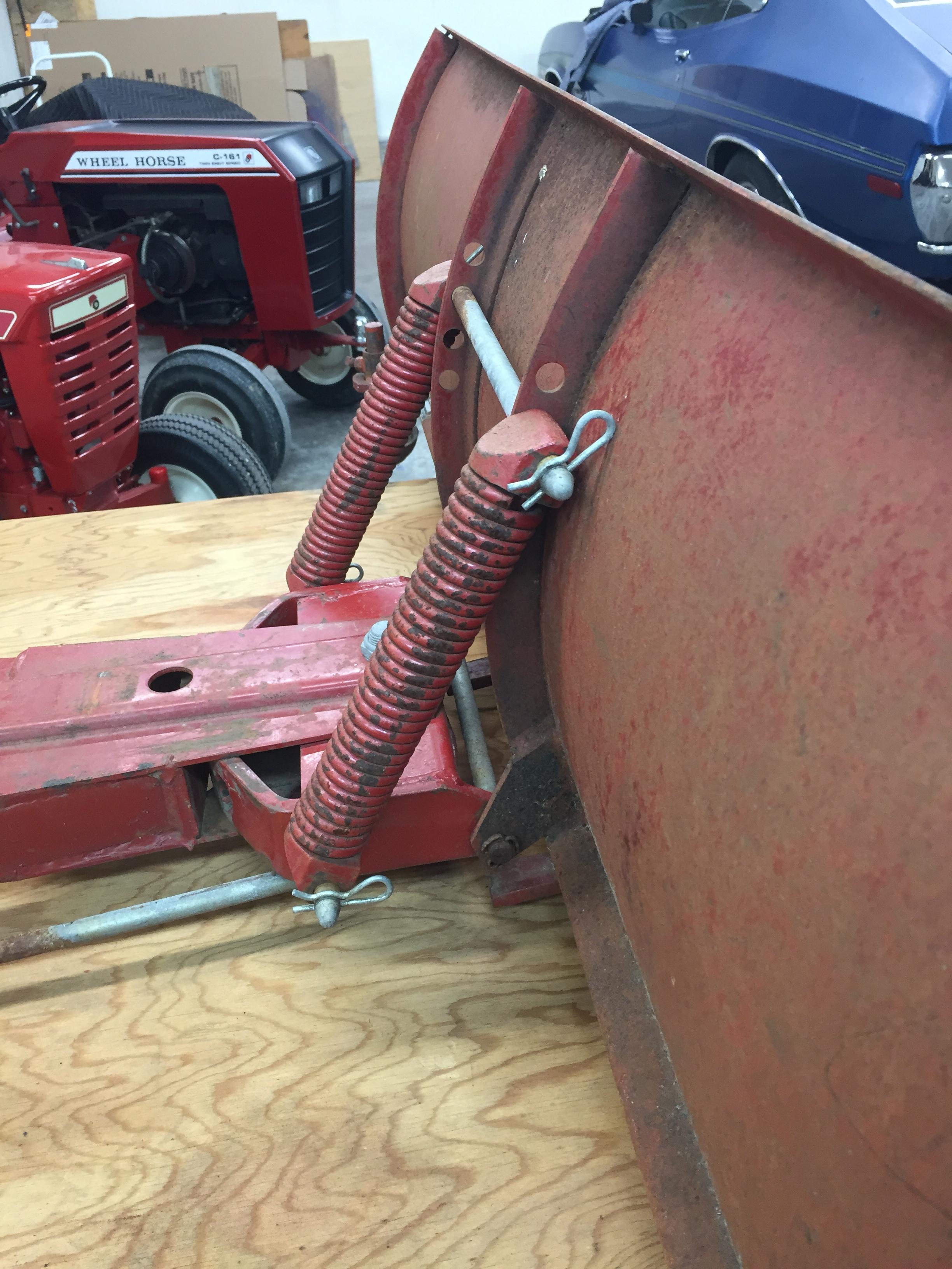

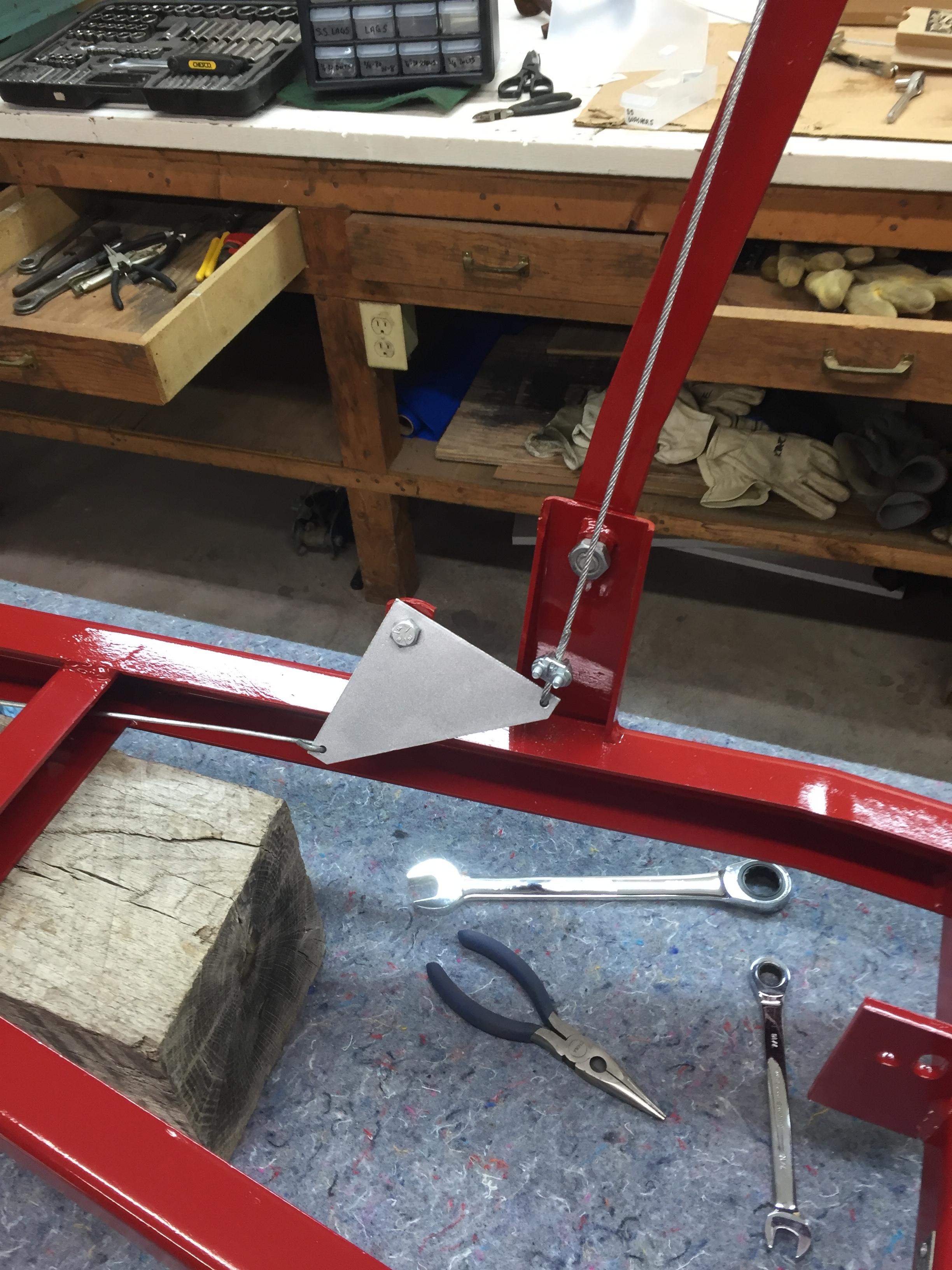

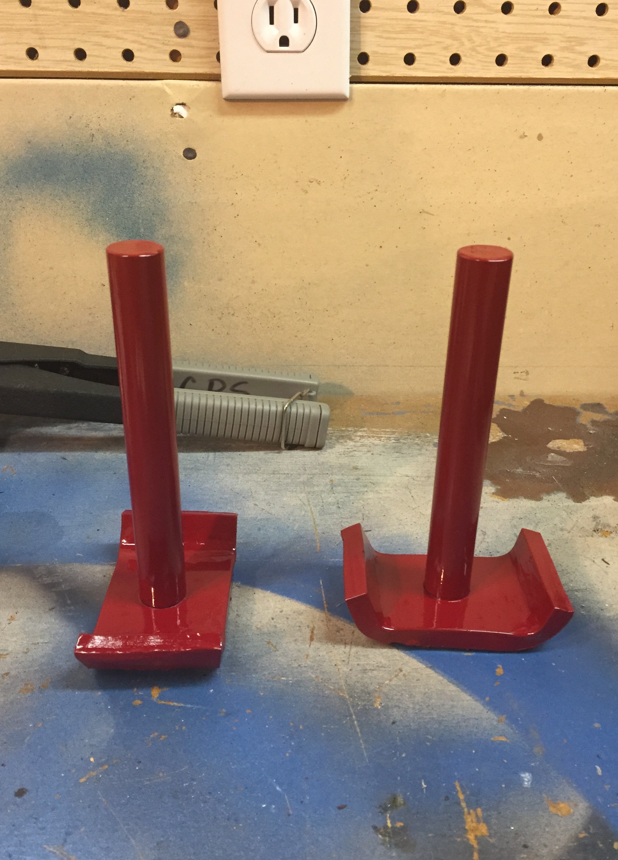

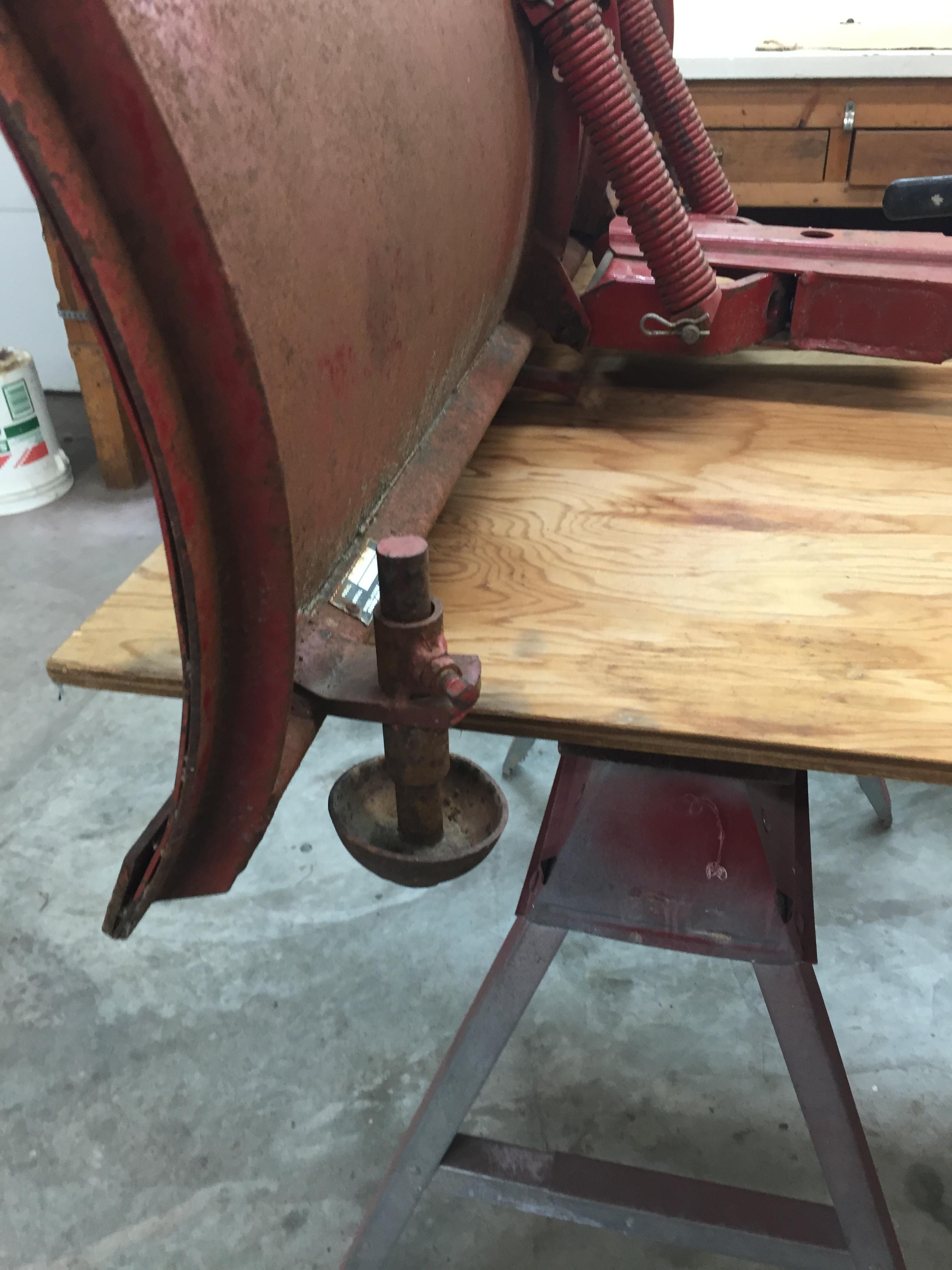

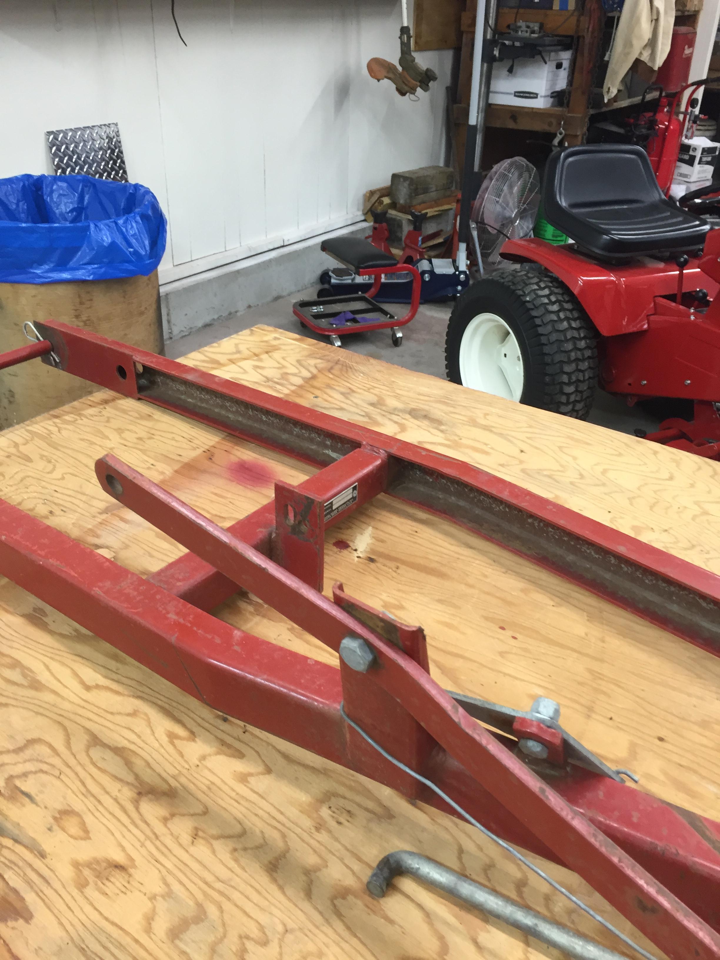

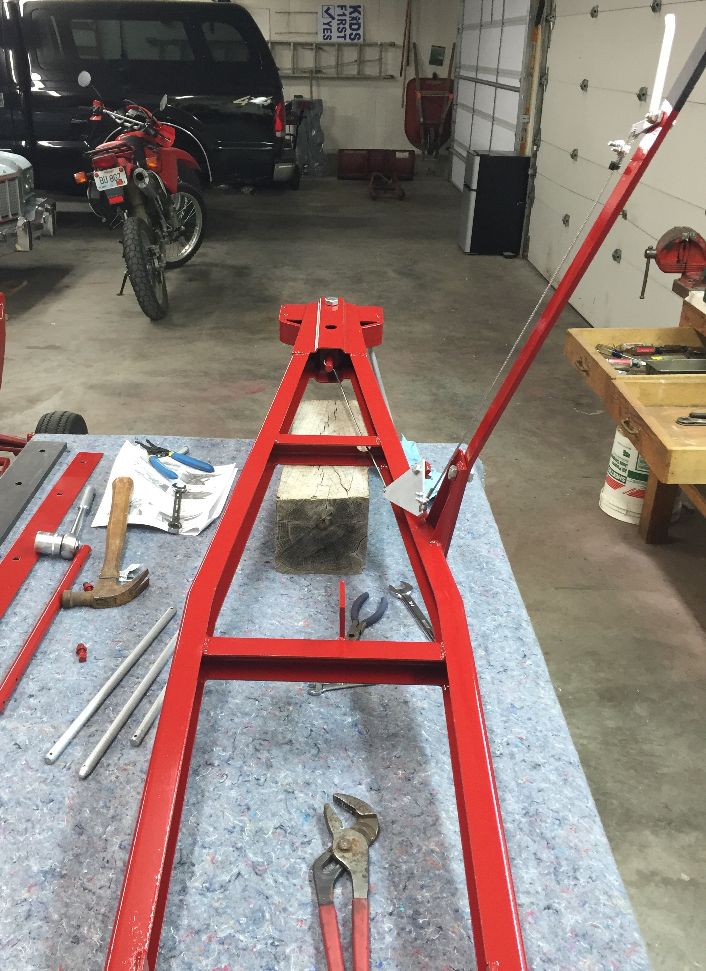

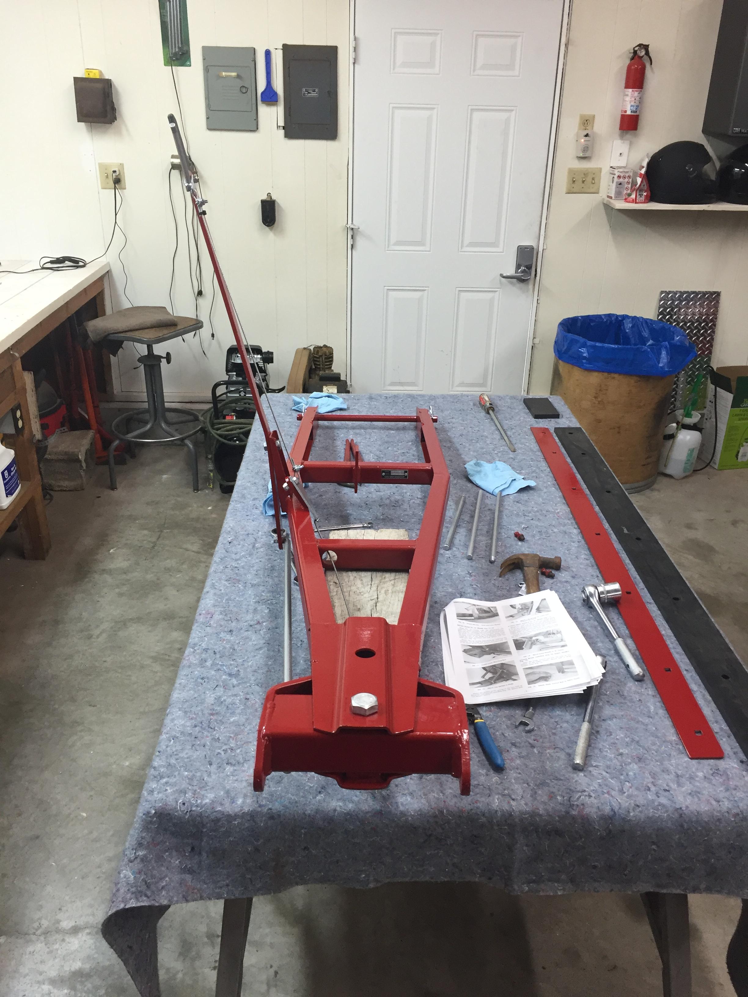

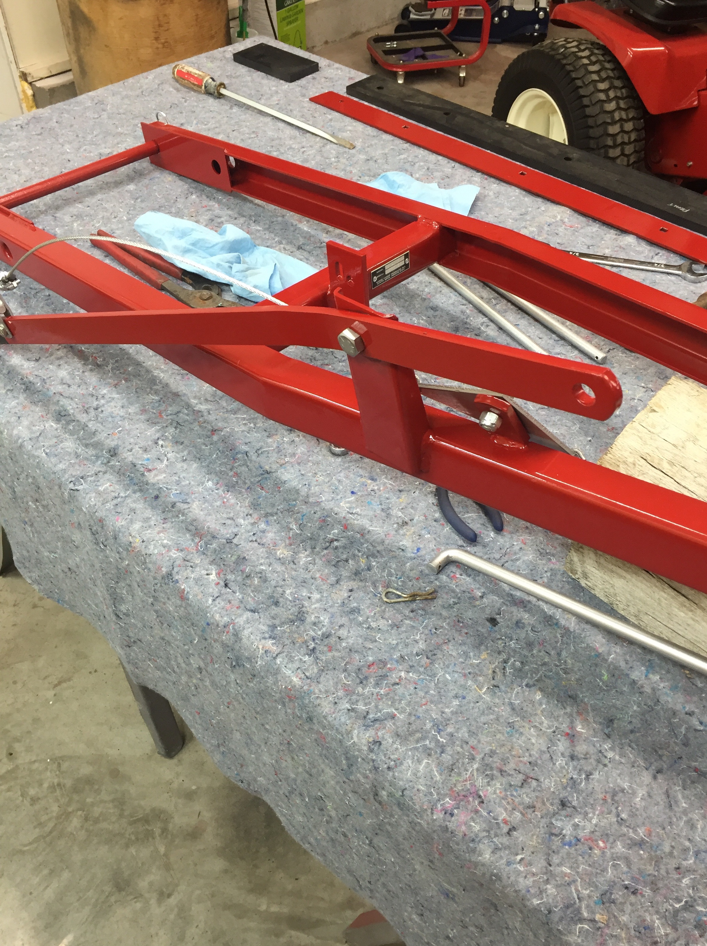

cschannuth 3,819 #7 Posted April 22, 2017 43 minutes ago, Tankman said: I'm guessing, the 54" blade fit right on your existing frame? 54" blades seem short in supply, even somewhat rare. Guess at 70, getting lazy, I siill have one blade on a Horse. Great reasoning, "A Horse for all seasons." If, IF I ever find a 54" blade locally, I'm going to jump on it. Might be me but, when I think "plow" I think "turn earth." Snow, push dirt, level driveway, "dozer". It would have fit my 42" frame but the 54" came with the complete frame and setup. All I had to do was swap the lever to clear the foot rest on my 161. I plan to put the lever from the 54 inch on my 42 inch blade because I believe it will work well on my older tractors they don't have the full foot rest. The 54 inch will only be used for snow since I am freshening it up a bit and I will use the 42 inch for dirt and gravel if necessary. I added a few pictures below of the 54 inch unit before disassembly and a couple of the frame only after cleaning and painting. The blade and springs are being sandblasted so I haven't gotten them painted yet. I also fabbed another set of blade shoes so that the originals won't need to be used and I can keep them in good condition. They don't look the same but they will function the same. 2 Share this post Link to post Share on other sites
