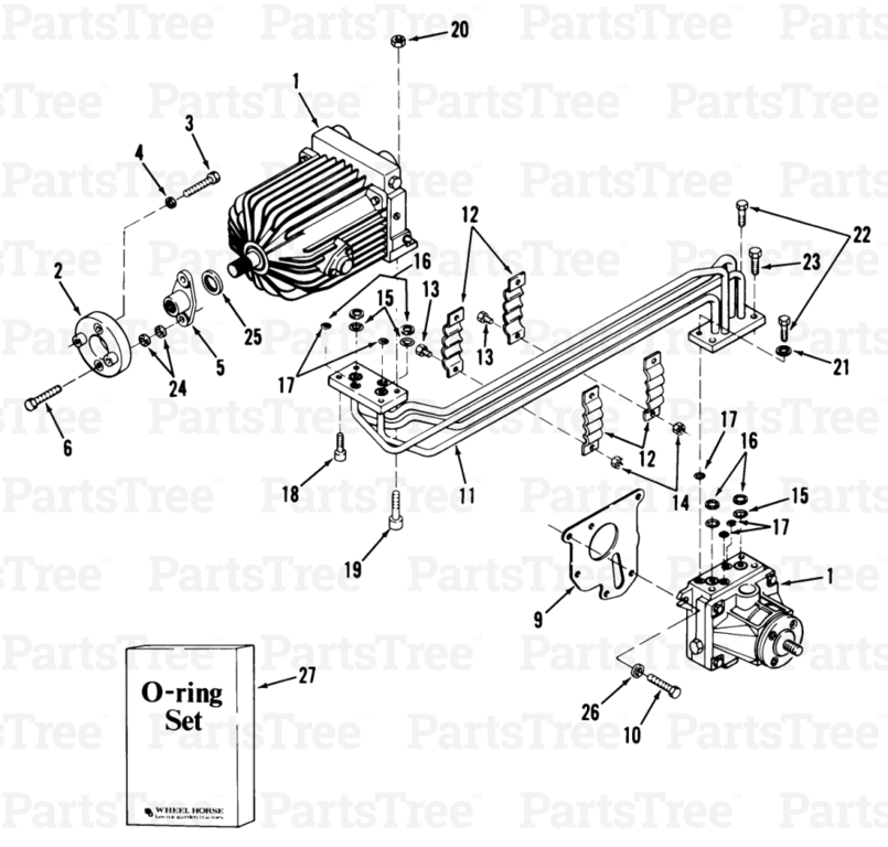

pacer 3,177 #1 Posted April 20, 2017 My D-180 has developed a leak at manifold to motor. I have located all the O rings but cant find the "seal washer" that goes under the 1/2" bolt head (part # 102817) Item # 21 in the pic. I think this is probably called (at least I think) a "crush" washer" usually made of brass that will compress when tightened - and I imagine is critical to prevent a leak.... I cant determine just where/what the leak is from, oil seems to pool all around the manifold. Obviously once I disconnect it, all the O rings etc will need to be replaced 1 Share this post Link to post Share on other sites

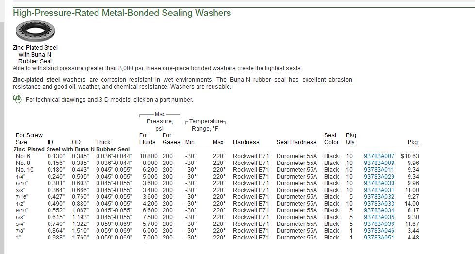

pfrederi 18,593 #5 Posted April 21, 2017 Copper crush washers are also used in automotive brake line fittings. I have used sealing washers like this with no leaks. Share this post Link to post Share on other sites
pacer 3,177 #6 Posted April 21, 2017 Well Paul I think you have solved my 'quest' -- shoulda known McMaster would have them Course it helps to have the proper name for them "sealing washers" instead of 'crush' washers. I'll get them on order and they should be here mon or tues. By golly the forum has solved another problem!! Gotta love it when you can get an answer on something like this and go on about your business. Share this post Link to post Share on other sites

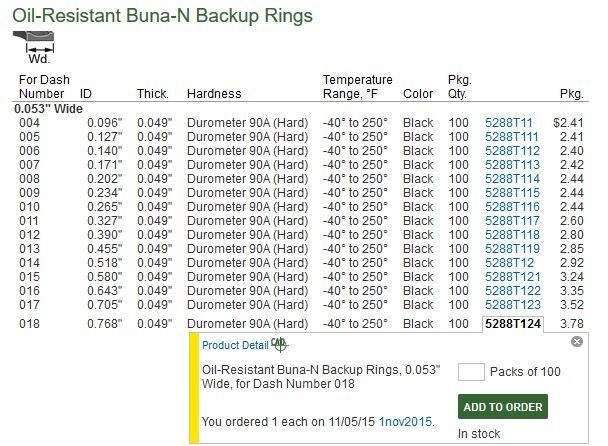

pfrederi 18,593 #9 Posted April 21, 2017 (edited) 50 minutes ago, pacer said: Paul, I went ahead and made up an order from Mcmaster - I usually have a few items on a "next time I make an order" list and I added a couple other things while I was at it. But that is an awfully nice offer you made and I thank you for it - and for identifying "sealing washers" Ive got the O rings coming from Jacks so next week I get to tear into it - not really looking forward to it ... nasty/messy! No problem...Too bad you ordered from Jack's. i figured out the standard Dash # for the two size of O rings and bought bags of 100 from McMaster for less than the price for 4 rings...have a "few" left.. Edited April 21, 2017 by pfrederi Share this post Link to post Share on other sites
pacer 3,177 #10 Posted April 21, 2017 Yeah, the 'conventional' O rings arent a problem and have found them locally, but the flat 'spacer?' ring I wasnt having much luck with and Jacks had them soooo. Last time I was into this tractor I reused the flat ones and also reused the sealing washer -- and, well thats probably where/why I got a leak! Share this post Link to post Share on other sites
