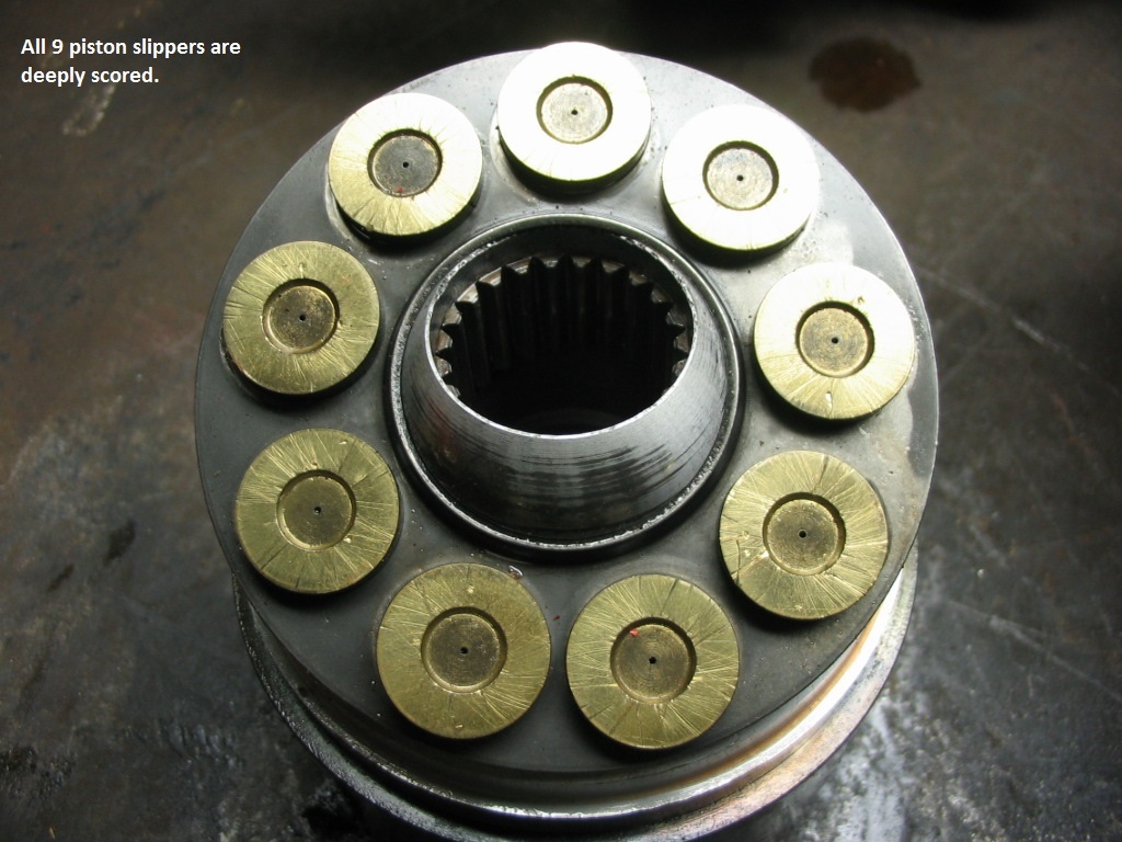

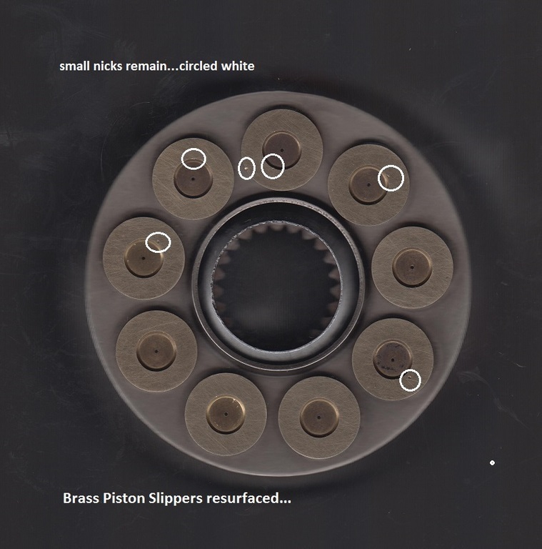

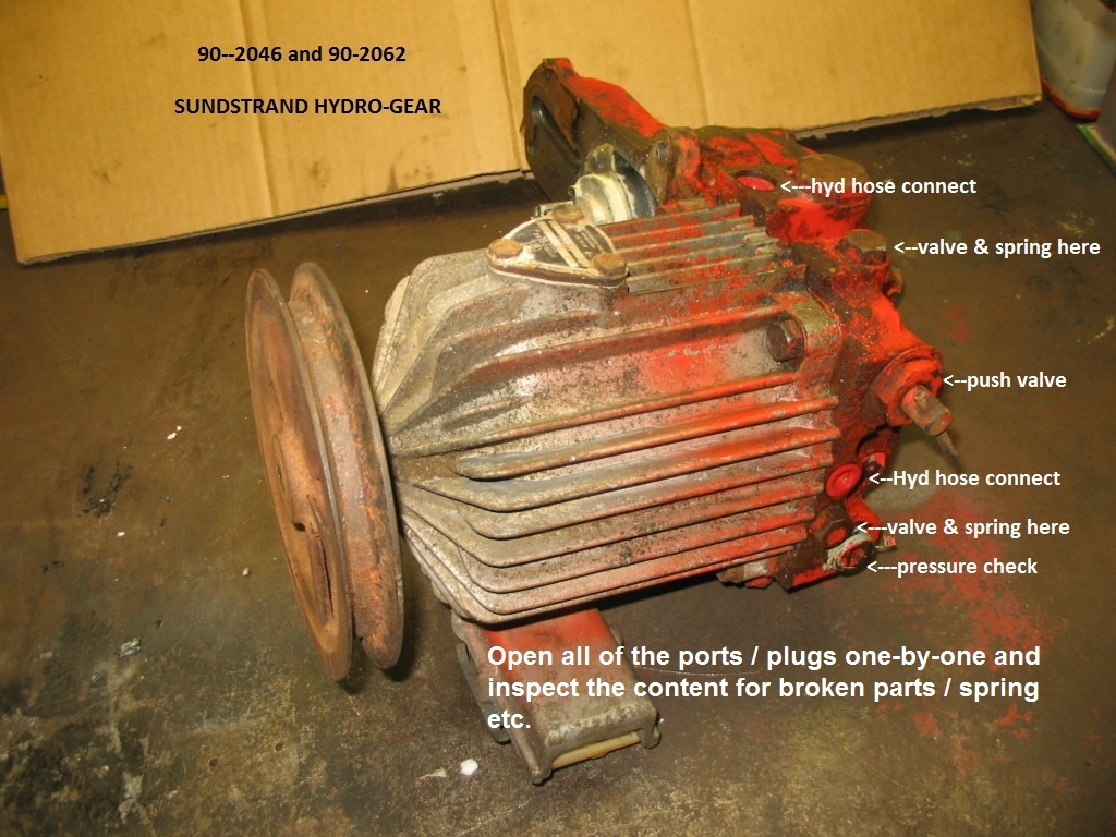

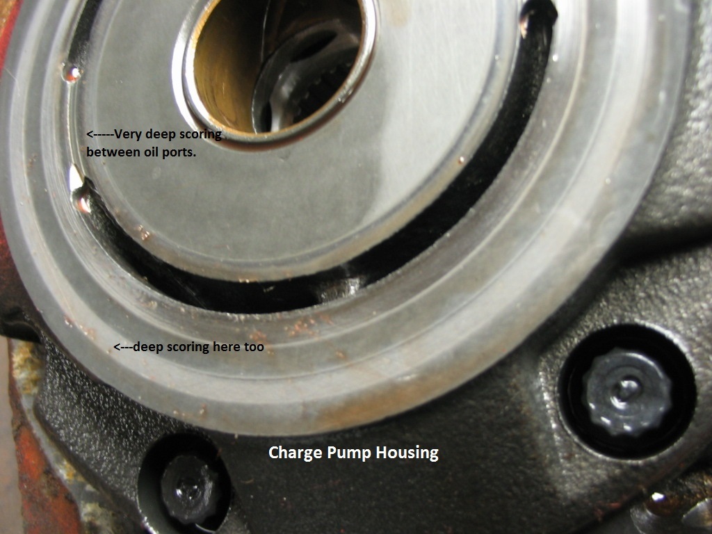

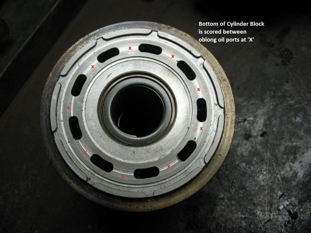

daveoman1966 3,882 #4 Posted April 16, 2017 This Sundstrand unit is very similar to later models 90-2046 and 90-2062 both of which I have rebuilt for other members, with success. First, I suggest you follow any 'short-run' tips from the repair manual download, with fingers crossed. Then while the unit is still on the tractor, open all of the plugs / ports to see if there are any BROKEN parts. If that is to no avail, it is not difficult to rebuild the hyd pump section of the unit. If you know how to use a ratchet wrench and screwdriver, you can do this. Here's the thing: after nearly 50 years, the internal brass parts of the pump become scored and need resurfaced. There are some other issues, but that the main problem...here are a few pics of what can be expected when you remove the pump: 1 Share this post Link to post Share on other sites
coldbear 29 #5 Posted April 17, 2017 Wow.....I never expected this quick reply. Much appreciated, I'll be pulling that pump as soon as I do my early static checks. Thanks for the information fellas. Keep me I mind if you know someone that has a good working unit if mine doesn't work out, o.k.?? And another thanks Daveoman1966 for the pictures. We'll be using those for pre flight. 1 Share this post Link to post Share on other sites
