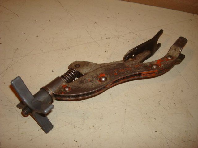

Razkid 69 #1 Posted April 10, 2017 What type of a spring compressor does anyone use on an Onan P220 engine? I ended up using a screwdriver to compress the spring to get the keepers out but that doesn't work well to get them back in. Your need three hands and five eyes! I tried an old C type and a Sunnen screw type compressor but they both hit the screw boss for the cover screw before the valve tip is exposed enough to put the keepers in. Share this post Link to post Share on other sites

Razkid 69 #3 Posted April 12, 2017 Thanks Joel but that's out of my price range for a one time use though! I do like your cover photo! I have a couple of Model A's out in the garage. I found this one on Amazon and hope it works! Share this post Link to post Share on other sites

GMan 82 #6 Posted April 12, 2017 Razkid, I use one (like you have pictured) on my Onans everytime I tear one down and it works just fine. They are a little tricky to get the end adjustments right for the spring diameter and the Roto-cap diameter but after using them a couple of times you get used to doing it.........Good luck with yours..........................Gary Share this post Link to post Share on other sites
Razkid 69 #7 Posted April 16, 2017 The spring compressor arrived from Amazon and it works great. $32 well spent! 1 Share this post Link to post Share on other sites

Duramax7man7 506 #12 Posted April 18, 2017 This afternoon I bolted a couple of open ended box wrenches to a long bolt with the spring end wrench a bit loose to be able to move and then used a small metal 12" clamp to close the wrenches together to compress the spring to remove the valves. Had to use a small set of vise grips to keep the spring end of the clamp in place . It worked but was a lot to keep all aligned and was barely able to put the spring locks back in... Was a son of a gun to do. lol So, I ordered this one... Not sure how well it will work. but it shouldn't be too hard on it as the springs are heavy duty. It does 1" to 1 3/16" springs. Should be a decenty little small engine tool. It was only $18 shipped through Prime. Share this post Link to post Share on other sites
Razkid 69 #13 Posted April 18, 2017 Good luck with that one Mastiffman! I thought I got a good deal but you got a steal, if it works. The C type that I have hits the screw boss so hopefully the one you bought is a little thinner where it fits around the spring retainer. Let us know if it works for you. 1 Share this post Link to post Share on other sites

6wheeler 674 #16 Posted April 19, 2017 I just use my C type small engine compressor (KD). One tip I like to share. Put a piece of paper towel or something in the bottom of the valve pockets over the drain hole. Those sneaky valve retainers find a very quick route to the bottom of the governor case... I don't know how I know that . Good Luck 1 Share this post Link to post Share on other sites
