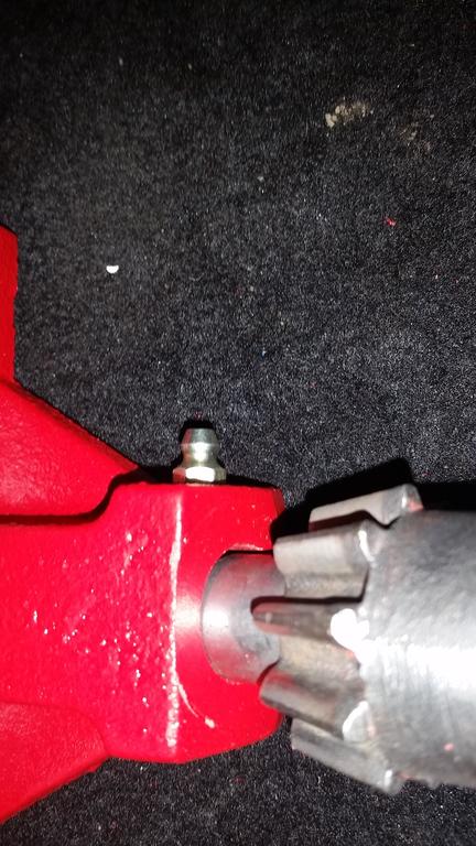

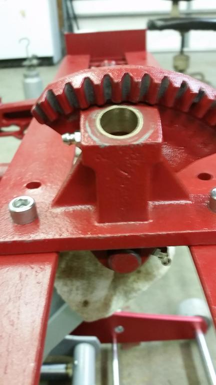

This area here Kevin, you won't have the 45 deg zerk here... that's custom! :lol:

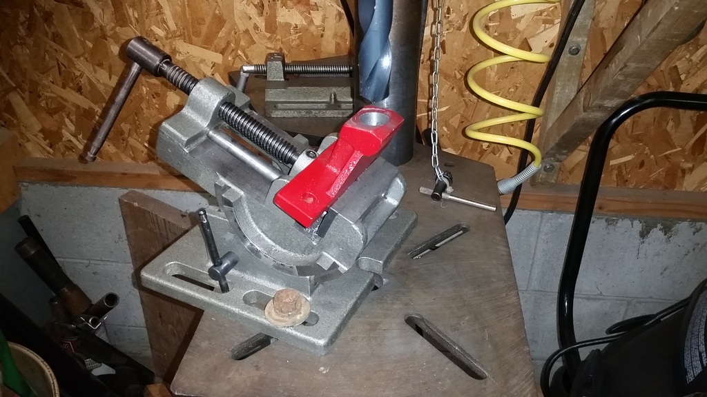

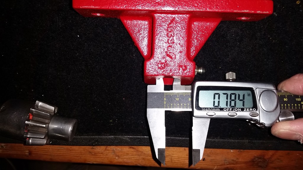

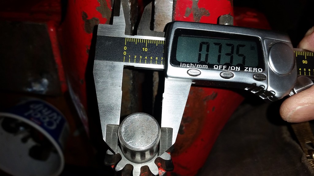

Drilling for the bushing
My theory If the bushing wears which it should just pull it out and replace.
I would bet that if you can get a new one from a Toro dealer they would be quite $$ proud of them. Wouldn't hurt to check tho.

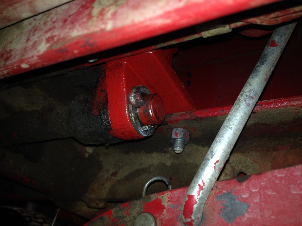

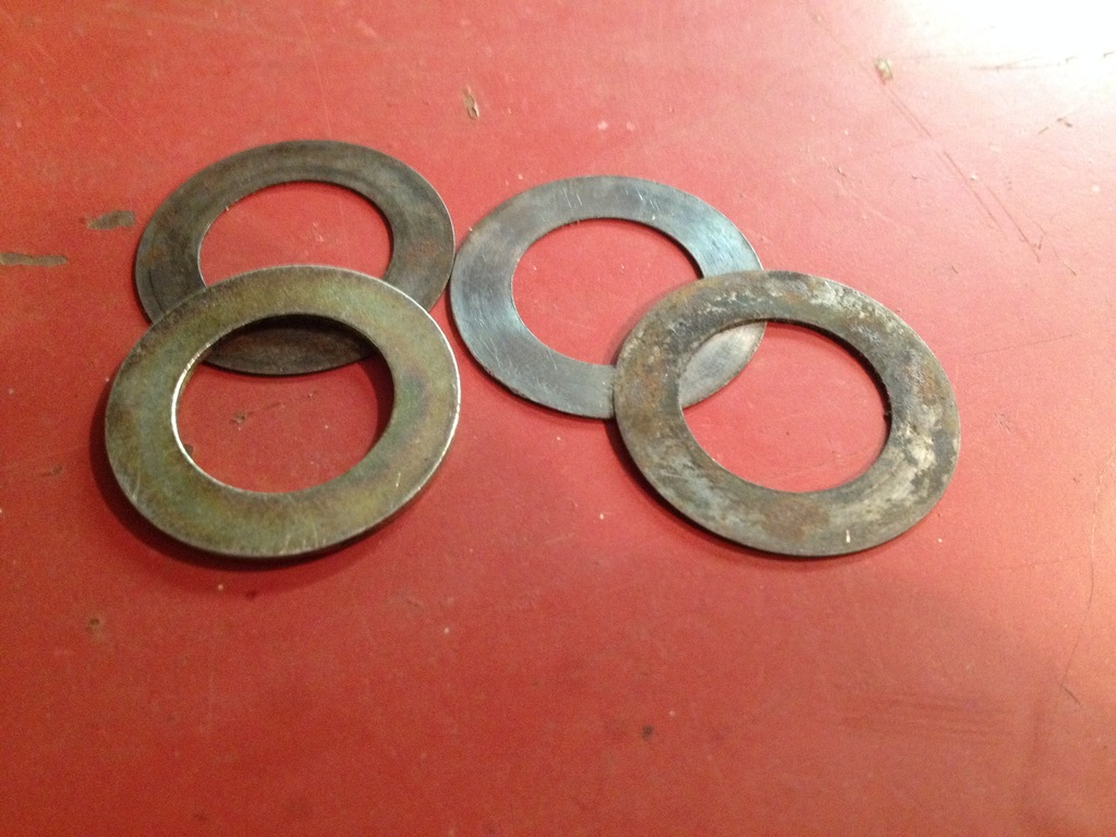

TDF5G

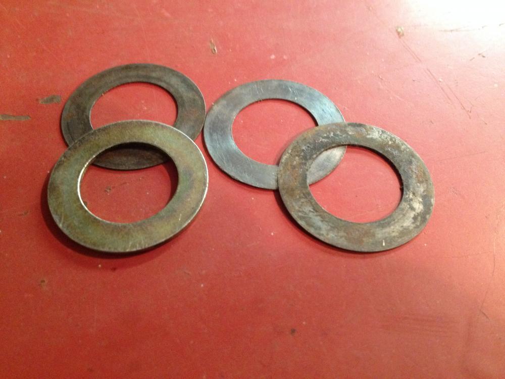

I would check the shims underneath the tractor on the horizontal shaft first.  I'd bet most of the slack could be taken out there.  Here are some pics of what it should look like.  The shims are 3/4 I.D.  I found them at Orscheln or Tractor Supply, called machine washers or shims.
  • Like 4

When you get a chance to lay the tractor up take that lower steering gear apart and re-bush the lower socket.  The lower socket is cast and wears more easily than the bottom of the steering shaft resulting in that slop even though there is a grease zerk ther. PO may never have greased it.This was my solution but you should be able to also replace the trunnion. Clean up and check the rest of the steering gear ...tie rods may be worn.
Thank you very much!
I will definitely look into this as well!
