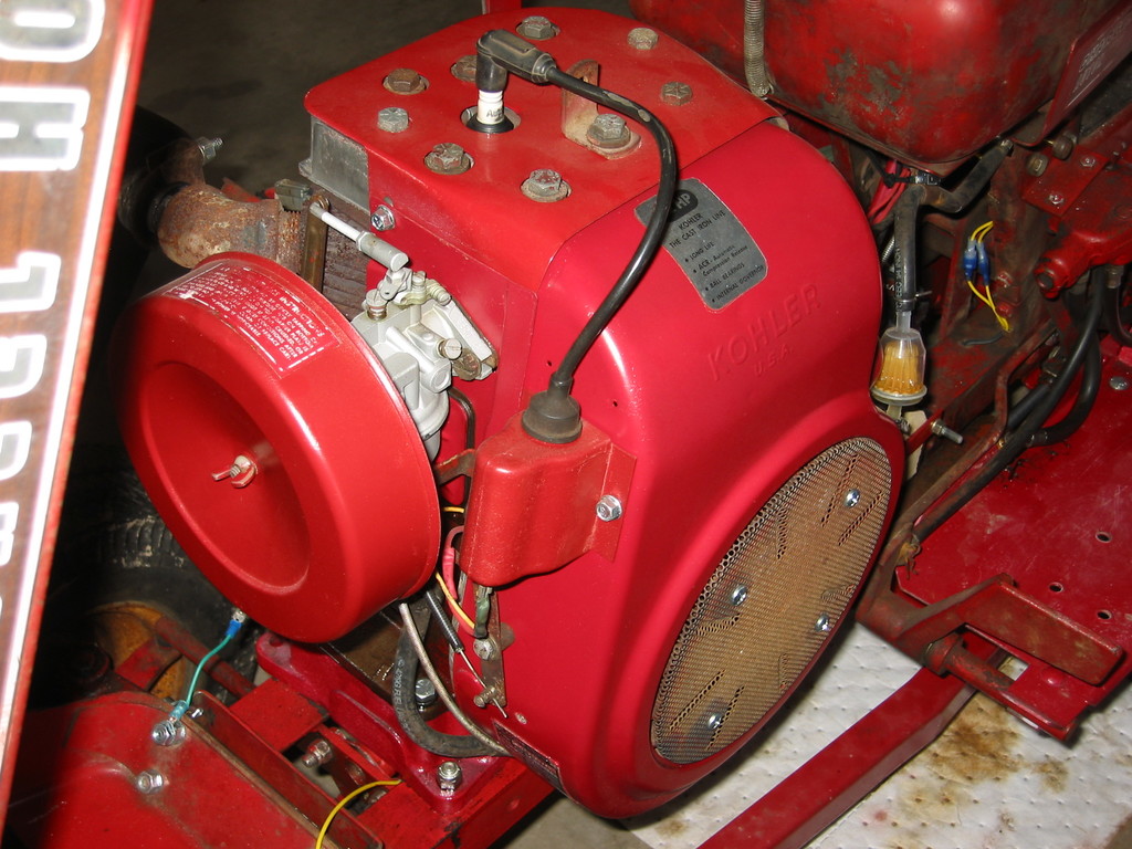

pfrederi 19,783 #5 Posted April 10, 2017 What kind of ignition system do you have?? Electros came with two different ones Breakerless and also a magneto version. (Many Breakerless were replaced with a battery coil system so really you could have any one of the three.) Spark plug gap varies. Mag .025 Battery Breakerless .035 1 Share this post Link to post Share on other sites

pfrederi 19,783 #7 Posted April 10, 2017 Cleaning the fuel system and carb are important. How did you gap the new plug? .025 or .035 If your plug wire comes out from under the shroud .025 First pic magneto If it comes from a triangular coil .035 second pic breakerless If the breakerless is working why replace it. They are sort of a go/no go thing (assuming plug is gapped and in good shape) Share this post Link to post Share on other sites
seven 202 #8 Posted April 10, 2017 Ok I will try this first ... mine is the top picture Share this post Link to post Share on other sites
