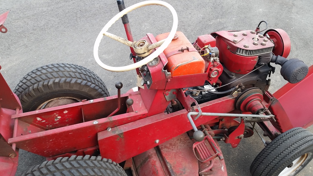

WHX?? 54,653 #9 Posted April 10, 2017 (edited) My 1067 was converted over to solenoid Mike and it works pretty good. In the pic you can see where a PO tastefully piggybacked the sol to the back of the S/G. I was thinking about going back to OEM till I saw the price on that switch! You might have to get creative on the dash as the mounting hole there was larger than a after market switch. Prolly have to do this on my 1257 as the switch is getting iffy. Edited April 10, 2017 by WHX11 Share this post Link to post Share on other sites
