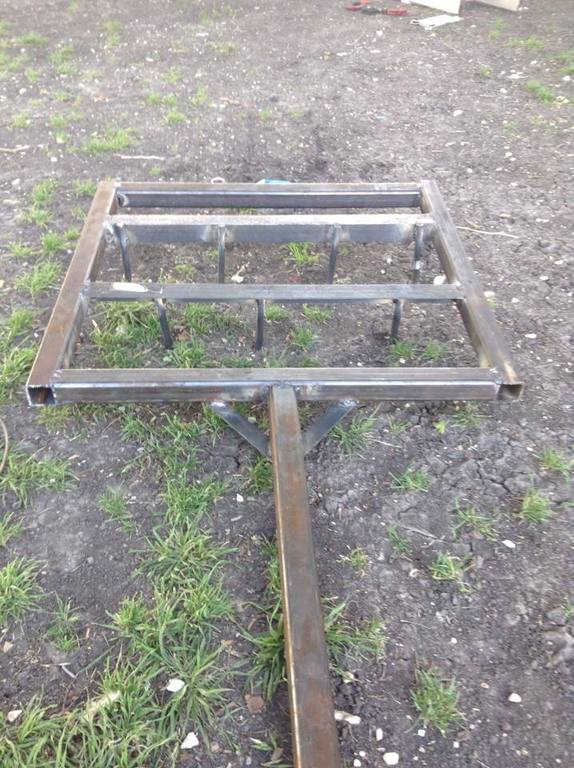

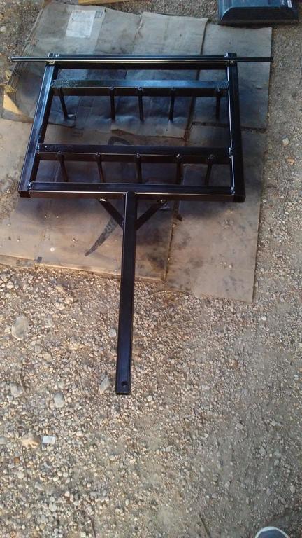

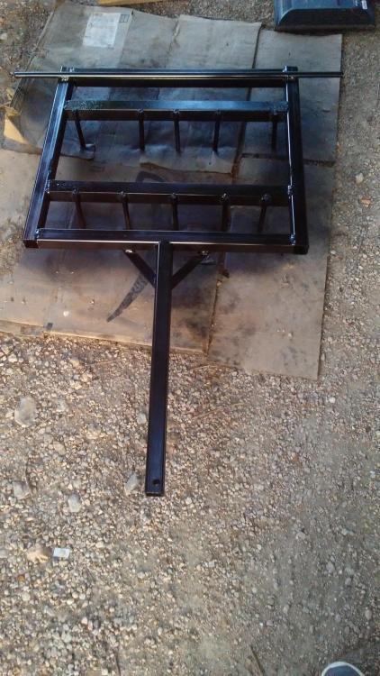

bbuckler 45 #1 Posted April 9, 2017 I built this yesterday to clean out garden rows. I only got $14.00 in this build so far since I got given the square tubing. And a video of me trying it out. I'm sorry for the bad word. 8 Share this post Link to post Share on other sites

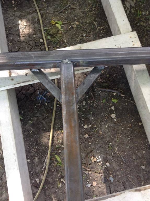

AMC RULES 37,252 #2 Posted April 9, 2017 Some triangle shaped gussets welded into those corners would add some strength too. 3 Share this post Link to post Share on other sites
DennisThornton 4,772 #3 Posted April 9, 2017 I think the frame is plenty strong as is but when your tines/spikes wear out consider some flat plate. Stronger and last longer. Good job! 1 Share this post Link to post Share on other sites
bbuckler 45 #4 Posted April 10, 2017 2 hours ago, DennisThornton said: I think the frame is plenty strong as is but when your tines/spikes wear out consider some flat plate. Stronger and last longer. Good job! Probably what I will do when I replace the piece of angle iron that bent. Share this post Link to post Share on other sites

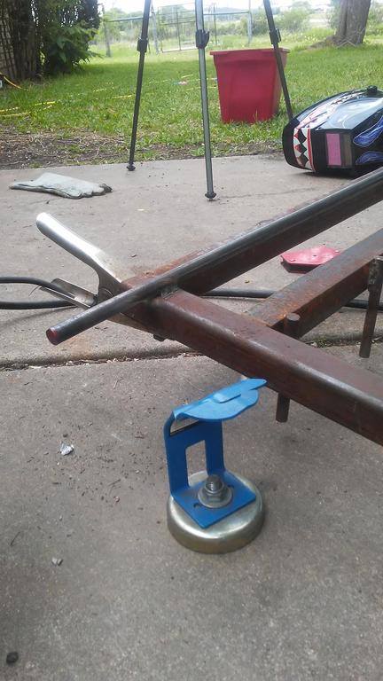

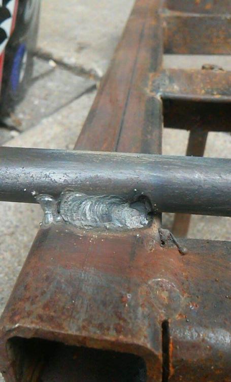

bbuckler 45 #6 Posted April 20, 2017 I got the axle welded on Share this post Link to post Share on other sites
