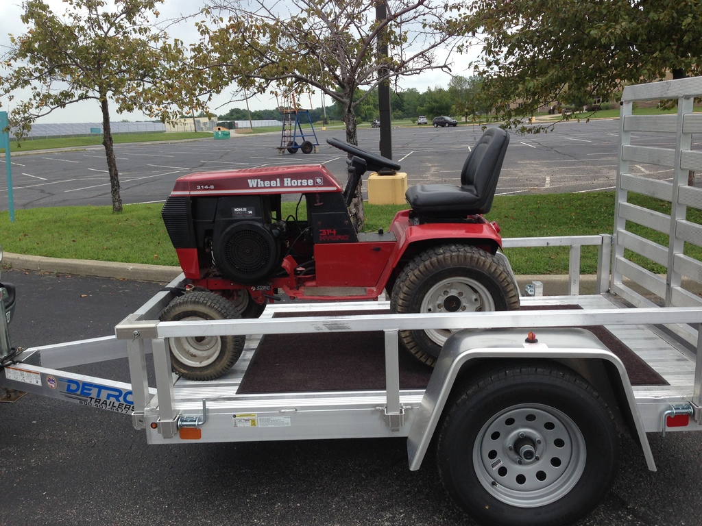

Jrblanke 918 #6 Posted April 8, 2017 When my friend bought his first house and subsiquently, his first mower, I convenced him to hold out for a wheel horse. I found him a 1996 314H with about 600 hours that he absolutely loves now. Thanks to Wheel N It, he also has a front plow blade. 4 Share this post Link to post Share on other sites

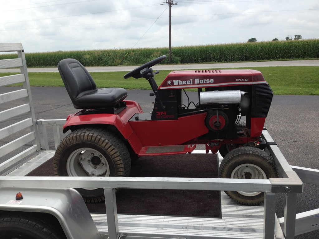

Lane Ranger 11,694 #7 Posted April 8, 2017 I bought this 314-H last year for my brother David. Has hydraulic lift also. Hood has been changed but it is a 314 Hydro. 3 Share this post Link to post Share on other sites

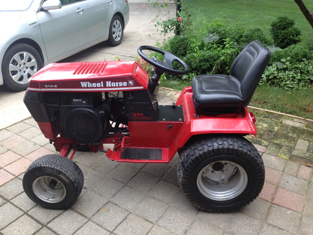

Forest Road 595 #12 Posted April 10, 2017 I kinda like mine 1 Share this post Link to post Share on other sites
Duramax7man7 506 #13 Posted April 11, 2017 (edited) 15 hours ago, ericj said: like to see pictures of this set up,never heard of anything like that eric j No? Here ya go... I used gaseous Teflon tape which is just a thicker type of tape I believe. 15 hours ago, Forest Road said: I kinda like mine Very Nice. Almost seems like it's pushing that Mag 14's power limits though. I tell ya. I used my 520h this past winter with a single stage snow thrower and once I got the belt and PTO Clutch tightened up it was rockin through snow. Launching it a good 25ft-30ft. Not powder but some nice dense stuff moved by the city plows that was at the corner of our street! I think that the 314h would be a great mower though for sure. Especially converting it to a 314h-s (s for swept front axle) like I did with my 312-8s and slapping a 60" deck underneath. Edited April 11, 2017 by Mastiffman 2 Share this post Link to post Share on other sites
