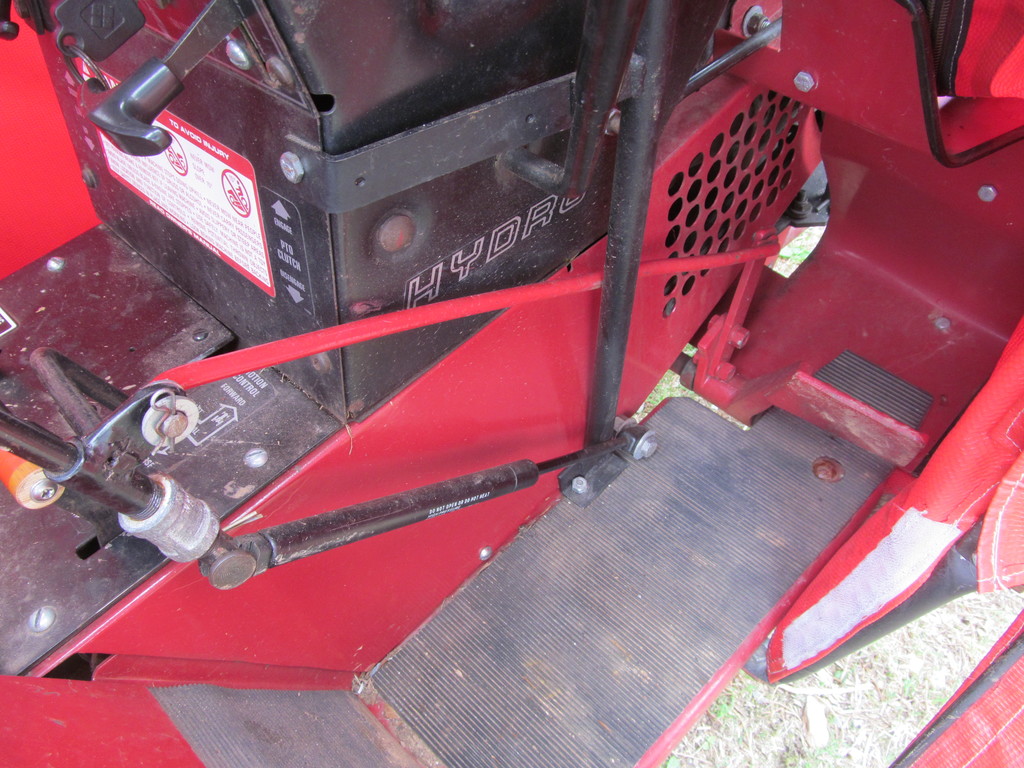

EricF 589 #19 Posted April 10, 2017 Had the time and good enough weather to begin getting acquainted with the new Horse. Got the snowblower off and tucked away in the shed, along with the walk-behind tucked in beside it perfectly, which helps clear some space in the garage. By the way, is there any good way to attach/detach the snowblower belt shield bracket -- the one that holds both the guard and the pin for the anti-sway bracket? It goes on with two bolts, but the front one in particular is a pain because the engine mount bolt gets in the way of a socket, and the axle gets in the way of putting a wrench on the nut on the back side of the frame. I had to hold the nut with an open-end wrench just right, and work the nut off with a wobble adapter and long extension out past the left frame rail. Getting it back on promises to be interesting... Washed the dirt off, and took a few more pictures... No mouse nests in the engine, thankfully. Plenty of dust and dirt caked on, though, that I had to carefully wipe and blast away with the hose sprayer. Moved her into the garage where I could get a better shot. Hardly any clouds most of the day, and made it too bright outside for good shots. I did find some rot on the footboards -- all the way through in a couple of spots on the left side, in fact, and a lot of rust where the plastic treads fasten through the metal with molded-in "pins". It looks like the plastic treads let a lot of mud and water go underneath, where it stays and rots them out. Looks like I'll have some metal repair in my future, and if I can get them filled well enough, I may fill all the holes and switch to the older style rubber treads. Or maybe work up some nice diamond-plate treads. I'll have to think about it and take my time. Here's the underside of the deck after I got it cleaned up and scraped off some lingering grass clipping residue. One of the spindles looks a little chewed-up on one side. I'll have to keep an eye on that and replace it if it gets any worse. Got the blades off to sharpen them -- with a bit of PB Blaster and a few thwacks to the wrench from a rubber mallet. I don't think they've been off for a couple of years. Now that everything's off and out of the way, it's time to go through and lubricate all the pivots and get grease in the zerks on the tractor and the deck. I also need to clean and adjust the hydro drive control cam -- it's loose enough that it slips and won't hold faster speed settings, and reverse doesn't always pick up smoothly because the cam wobbles. It doesn't look like anything is really wrong -- just seems to have crept out of adjustment. And a hardware store trip is in order to replace some rusty fasteners on the dozer blade. Won't be long before she's all set for yard work! 5 Share this post Link to post Share on other sites

WVHillbilly520H 10,378 #22 Posted April 24, 2017 On 4/9/2017 at 9:31 PM, EricF said: By the way, is there any good way to attach/detach the snowblower belt shield bracket -- the one that holds both the guard and the pin for the anti-sway bracket? It goes on with two bolts, but the front one in particular is a pain because the engine mount bolt gets in the way of a socket, and the axle gets in the way of putting a wrench on the nut on the back side of the frame. I had to hold the nut with an open-end wrench just right, and work the nut off with a wobble adapter and long extension out past the left frame rail. Getting it back on promises to be interesting... I did find some rot on the footboards -- all the way through in a couple of spots on the left side, in fact, and a lot of rust where the plastic treads fasten through the metal with molded-in "pins". It looks like the plastic treads let a lot of mud and water go underneath, where it stays and rots them out. Looks like I'll have some metal repair in my future, and if I can get them filled well enough, I may fill all the holes and switch to the older style rubber treads. Or maybe work up some nice diamond-plate treads. I'll have to think about it and take my time. Most just leave the frame mount for the belt guard/sway bar attached to the tractor once it's installed (that's why when we pick up a 2stage it's missing) it doesn't get in the way of the mower PTO belt just can't use the plastic belt guard, on those floor boards I have an Anniversary 520H I bought new as well as a '95 I prefer the thicker pads over the older thin style just have to remember to used compressed air to blow out grass/dust/dirt and after washing or melted snow after blowing to help with the above floor board rot, but on the older Cub Cadet Quietline wide frame models used diamond tread metal overlays on the floor board but do get slippery after worn, also skateboard tape is another alternative, Jeff. Share this post Link to post Share on other sites
