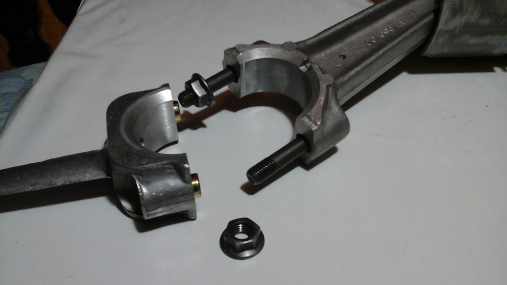

WHX?? 52,895 #11 Posted April 3, 2017 (edited) I have what I believe to be the posilock nuts on my but I fail to see how they are locking? Dan, @achtosuggested a a drop of lock tite just for insurance. Since Richard's post mentioned a used value safe to assume they can be used over. You might want to swing by a auto parts and pick up some plastic gage for more insurance Steve. Edited April 3, 2017 by WHX9 Share this post Link to post Share on other sites
