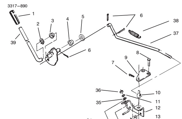

Indianajohn 54 #1 Posted April 2, 2017 Gentleman ( and ladies, if we have any here), got a couple of semi related questions. What is supposed to keep the PTO lever in the off position on a 520H? Is there supposed to be some kind of spring loading on this thing? On mine, somebody had a bungee cord wrapped around the lever where it goes into the side of the dash to hold it in place. I know that ain't right! But without the cord it just flops back and forth (mostly forth, which makes it a pain to start). Not seeing anything on the parts diagram. Next question. I finally got the mower deck for this thing. It's in great shape, apparently used very little and stored indoors, but it's only a 42" rear discharge. Why they had such a small deck for such a big tractor I'll never know. Anyway, we weren't able to find the mule drive but they are going to keep looking. But I may need to find one on my own. Been looking on fleabay, but not sure what I need. I see lots of Wheel Horse mule drives for different model tractors and they all look the same to me. Do I have to have one off another 520? Or will any of these mule drives that fits the Quick Attach hitch work? Do most Wheel Horse tractors use the same drive? Thanks! 1 Share this post Link to post Share on other sites

gwest_ca-(File Mod) 12,533 #3 Posted April 2, 2017 There is an L bracket below the right side of the battery. The spring 38 hooks into a hole in the corner of it. The other end hooks to the eye of a cotter pin 6 in the rod. Garry 2 Share this post Link to post Share on other sites

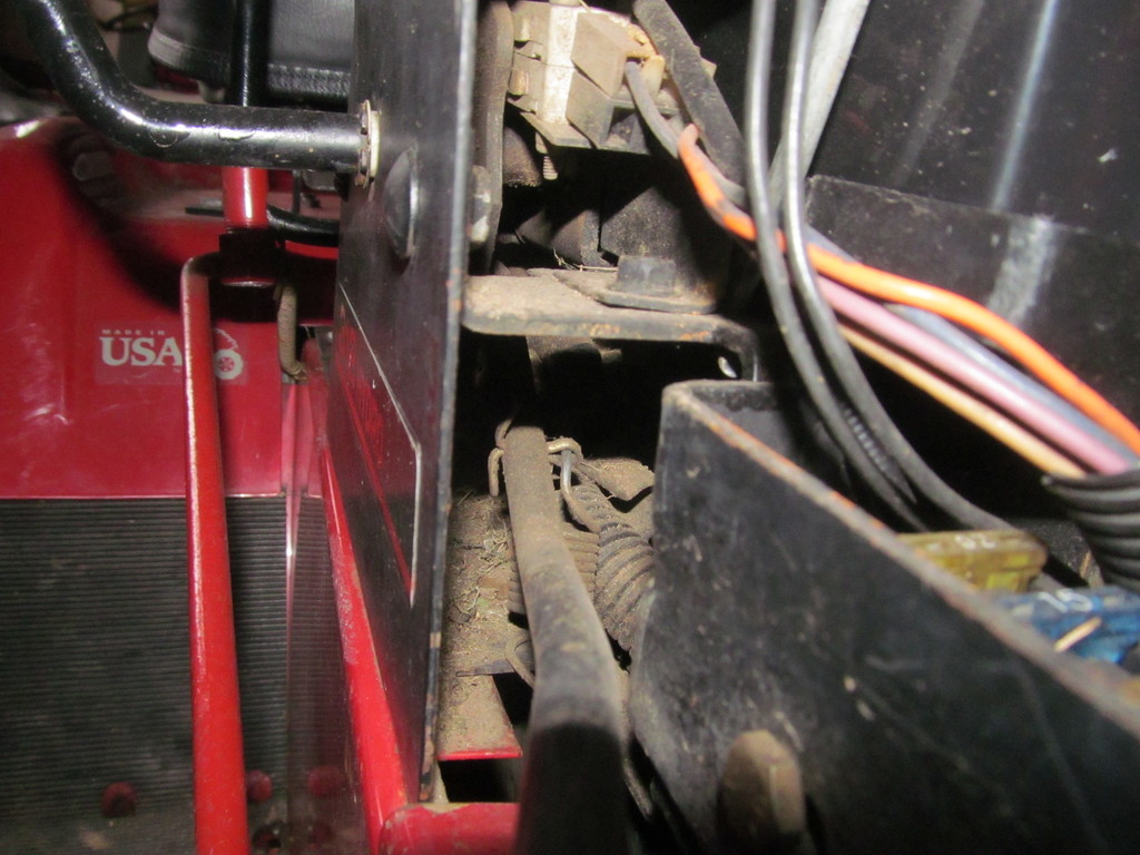

Ed Kennell 47,818 #4 Posted April 2, 2017 You can see the spring here hooked in the cotter pin in the PTO control rod. The mule drives are the same for all tractors and decks, except for the spring loaded one used on the 60" deck. 2 Share this post Link to post Share on other sites
gwest_ca-(File Mod) 12,533 #5 Posted April 2, 2017 Perhaps it does not hook to the L bracket on all models. Ed's photo looks like it is hooked lower than the bracket. Garry Share this post Link to post Share on other sites

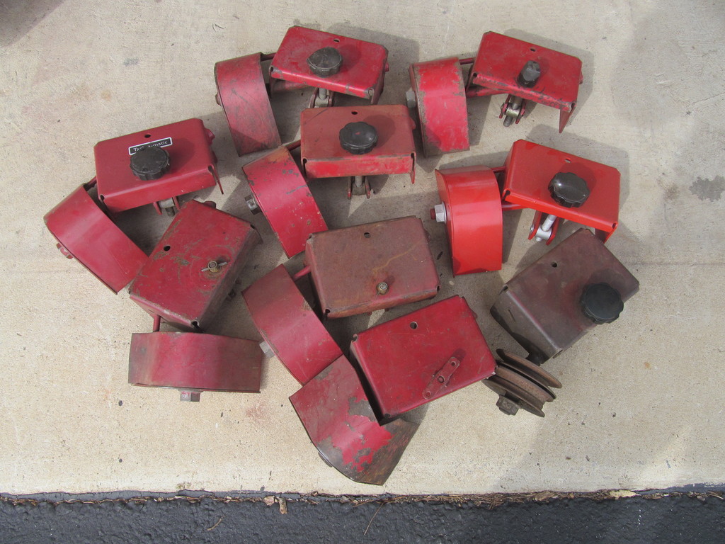

Ed Kennell 47,818 #9 Posted April 2, 2017 Garry, my picture is of my 312 and the spring is hooked in a notch in the lower plate. It is loose with the PTO disengaged and under tension when PTO is engaged. It may be hooked differently on a 520. My 520 is in winter storage, so I can't check the spring location. Yeah John, I have quite a few mules, those in the pic are the ones for sale that will be bringing to the Big Show In June. I have only ever seen two styles, the normal one and the special spring loaded one for the 60" deck. 1 Share this post Link to post Share on other sites

Ed Kennell 47,818 #14 Posted April 3, 2017 Complete with good bearings , good paint , good knob and good decal. $50-60. Broken or no knob $20. My three sense, scents, cents. 8 hours ago, squonk said: Ed. Any of those mules named Francis? Actually I do have one Mike....and his cousin Mr Ed. 1 Share this post Link to post Share on other sites

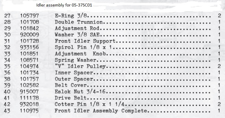

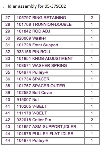

rlrnot 39 #15 Posted April 3, 2017 I don't believe all mule drives have the same pulley arrangement. My 37" side discharge deck uses a double 'v' belt, consequently the mule has 2 'v' pulleys. Decks that use a normal belt require a mule with 1 'v' pulley and 1 flat pulley I believe. Just my .02. 1 Share this post Link to post Share on other sites
Ed Kennell 47,818 #16 Posted April 3, 2017 Good point @rirnot. I have heard of these double Vee belt arrangements, but have never seen one. Maybe Garry can shed some light...were they specific to any particular model tractors? Share this post Link to post Share on other sites
bmsgaffer 2,071 #17 Posted April 3, 2017 The double vee is for 37" decks only and only certain years... it will be unlikely that you come across one of them. That and the 60" are the only odd ball mules i know of. 1 Share this post Link to post Share on other sites
ericj 1,580 #18 Posted April 3, 2017 13 minutes ago, Ed Kennell said: Good point @rirnot. I have heard of these double Vee belt arrangements, but have never seen one. Maybe Garry can shed some light...were they specific to any particular model tractors? Ed, the 6" front tires on the 300 series that ran the 37"' ran the double V pulleys, but not all ran the double V pulleys I've seen them both ways. you have to look at the deck and see which pulleys it has on. All of the mule drives are the same except the 60" decks with the spring. All the rest where basicly the same except for the pulley configuration. My C195 uses the same mule drive but different spacers and only one pulley. So if he dosen't mind buying his own pulleys all he needs to do is buy a mule drive with 2 pulleys and it should have the right spacers for him to use. eric j Share this post Link to post Share on other sites
Ed Kennell 47,818 #19 Posted April 3, 2017 The 312 I have had the 6" wheels ( I have replaced them with 8") , but it came with a 42" deck and the regular mule and belt. So Eric, how was the deck pulley different on the 37" double V belt deck? The outside pulley on the mule is the only pulley that would ride on the outside or top half of the belt. The deck would still only be using the same side of the belt as the PTO. I'm thinking maybe the guards may be different to clear the double thickness belt.. Hopefully someone has pictures. Share this post Link to post Share on other sites
gwest_ca-(File Mod) 12,533 #20 Posted April 3, 2017 Belt covers are the same Garry 2 Share this post Link to post Share on other sites
squonk 48,328 #21 Posted April 3, 2017 (edited) Good Topic! Who would have thought about the mules being different? I have 3 of my own, burnt up a brg. on one a few years ago and whipped out a spare. Fixed it and now and have 2 back up decks, 3 mules and tractors. I have no excuse not to cut the grass! Edited April 3, 2017 by squonk 3 Share this post Link to post Share on other sites
ericj 1,580 #22 Posted April 4, 2017 The 312 I have had the 6" wheels ( I have replaced them with 8") , but it came with a 42" deck and the regular mule and belt. So Eric, how was the deck pulley different on the 37" double V belt deck? Ed, the 37" deck with the double V runs V idler pulleys instead of flat idlers. the belt is a double V, there is no flat side on the belt therefore you have to run all V' pulleys. eric j Share this post Link to post Share on other sites
Ed Kennell 47,818 #23 Posted April 4, 2017 Ok,thanks Eric, so the PTO drive belt and the deck blade drive were both double V belts. I thought we were just referring to the PTO belt. So all the deck pulleys and both mule pulleys were Vees. I wonder if the purpose was to increase belt life by flipping the belts over or to minimize the pulley styles, or both. Whatever the purpose was, It must have failed as the design was rather short lived. The HP loss may have also been a factor. as there is a greater frictional loss as the belt leaves a v idler versus a flat idler. Share this post Link to post Share on other sites
ericj 1,580 #24 Posted April 4, 2017 the 37" only used one belt from the pto down to deck and around the deck pulleys, not the usual 2 belts of the typical wheel horse decks eric j Share this post Link to post Share on other sites
