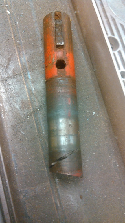

JPWH 6,542 #10 Posted May 25, 2017 (edited) I would caution trying to turn the steering wheel to break it loose. I broke the lower steering shaft assembly doing this. This is what was on my 69 Raider. Edited May 25, 2017 by JPWH 1 Share this post Link to post Share on other sites
