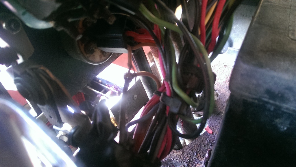

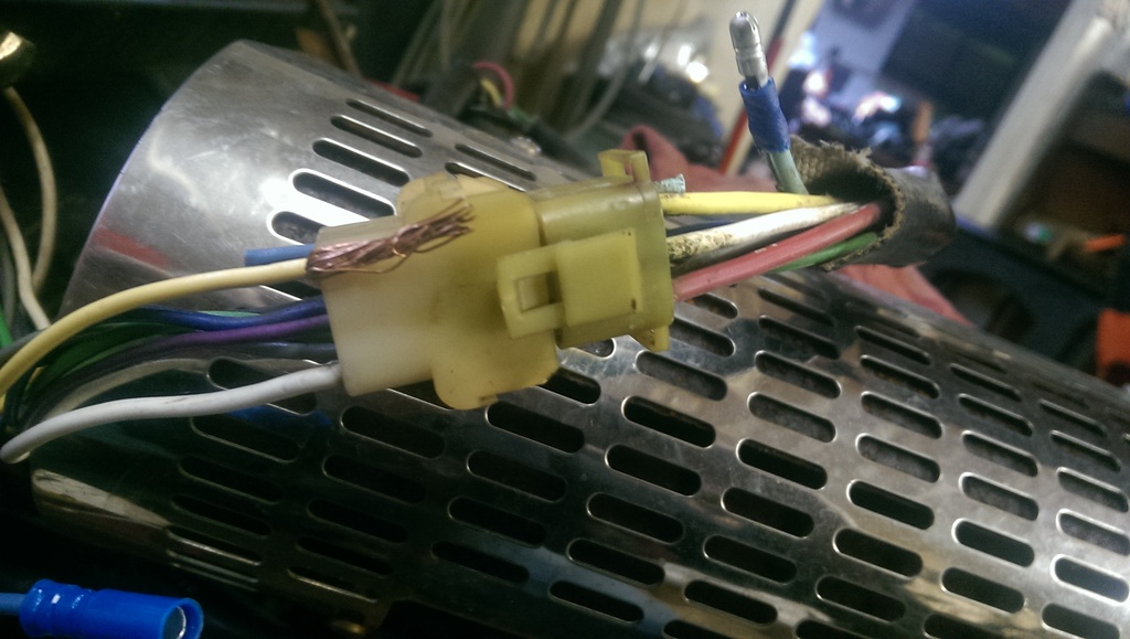

bo dawg 640 #56 Posted April 8, 2017 So after trying to test the voltage regular with no luck getting tractor running, I thought I would look the rest of the wiring over. I couldn't find the 9 pin everyone has talked about so I removed battery to look whats behind it and noticed a budge in the harness. It was taped up so I removed tape to find where the pin use to be. And there it is, the famous red wire. I'm no wiring guy, I mean I can handle the older tractors some what but this is a freakin night mare for me. I can repair the burned red wire but probably no better than what they have. Plus I've read that to correct this Hot red battery wire problem is put in a fuse down by the starter. Where was the relays suppose to be? Share this post Link to post Share on other sites

bo dawg 640 #61 Posted April 8, 2017 I appreciate your help Ed! Yes, I did check the 3 fuses on the bar and all was good. I shot air down into the holders and cleaned off ends of fuses. I removed R/R and checked the bottom for crud and cleaned those lugs with some fine sand paper cause they were pretty dull and coated. It didn't look too bad other than a slight green corrosion at the base of the lugs. One of the white AC wires that has the gray wire doubled up with has got hot or something at one time cause its a little burnt looking on the wire coating. I looked for a fuse down by the engine and didn't see anything, not sure where this is? I traced all the way to starter and found nothing. Is it a different wire I'm looking for? I seen on a post somewhere here that its location is on the pully side. I think I will get a new R/R for kicks and giggles any ways. One of the guys here posted a ebay link where their $11 buy now price. I will get the battery back in and fire it up and check the R/R readings and let you know. I will cut back the burnt red wire connector and replace it. Can I put a 30amp fuse there? or just splice back in direct? Thanks Bo Share this post Link to post Share on other sites

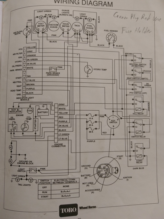

WVHillbilly520H 10,379 #63 Posted April 8, 2017 (edited) I replaced my 9 pin with bullet connectors so they can be easily taken back apart and also use dielectric grease to help keep corrosion at bay, you really need to get yourself a download of the wiring demystification guide and manuals of your tractor I hate electronic demons and most things wiring but I persevered last year with the one I picked up last year at this time with aforementioned schematics,but here's the '95 wiring diagram, Jeff. Edited April 8, 2017 by WVHillbilly520H 1 Share this post Link to post Share on other sites
bo dawg 640 #64 Posted April 8, 2017 Yeah I have print outs like that diagram but even though I can understand it, there's some areas I don't. Whats the whole purpose for the 9 pin connection other than unplugging the stupid harness? Just to repair later down the road or swap out that section of wiring? 1 Share this post Link to post Share on other sites
WVHillbilly520H 10,379 #65 Posted April 8, 2017 Yep just to "quick" connect/disconnect the engine to the chassis but atmosphere and storing conditions all break that connection down from corrosion to heat/cold cycles ect, it's just so much easier to do it with the "bullet" or "spade" style connectors and dielectric grease then less of a worry later, Jeff. 1 Share this post Link to post Share on other sites

bo dawg 640 #67 Posted April 8, 2017 Ok, had some me time with the beast this morning. I fixed the burnt red wire coming from R/R that is mated to the white wire going to the 30amp fuse. (wire marked #67). Put battery in, tested VDC 12.56, started up motor, check battery at VDC 12.38 at both idle and full throttle. Also same reading on B+ lug of R/R. Now switched meter to VAC and checked both AC lugs on R/R at 1/2 or more throttle and read 40, then full throttle and read 50. Let motor run for about 10 mins and rechecked across battery terms and still 12.38. Shut motor off and got across battery terms 12.56. So at this point do you think its the R/R not charging enough? Tractors volt gage read just under 12 running idle, and a little lower at full throttle. Took off fuse block and inspected under and it looked ok. Everything seems intact and all gauges work, including gas gauge and hr meter. 1 of the relays is a little discolored and funky on the bottom too. 1 Share this post Link to post Share on other sites

Ed Kennell 47,239 #72 Posted April 17, 2017 Just too much resistance in a bad connector will create the heat as the current tries to squeeze through the restriction. 1 Share this post Link to post Share on other sites
