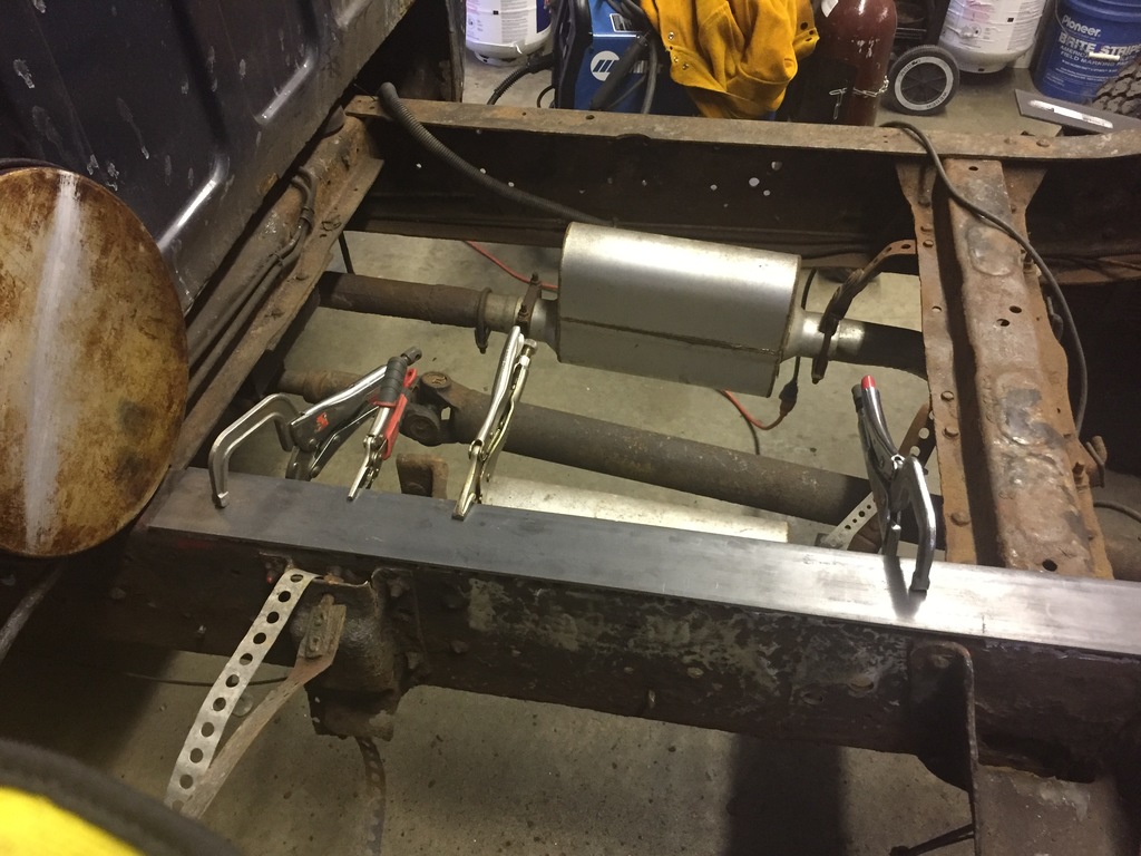

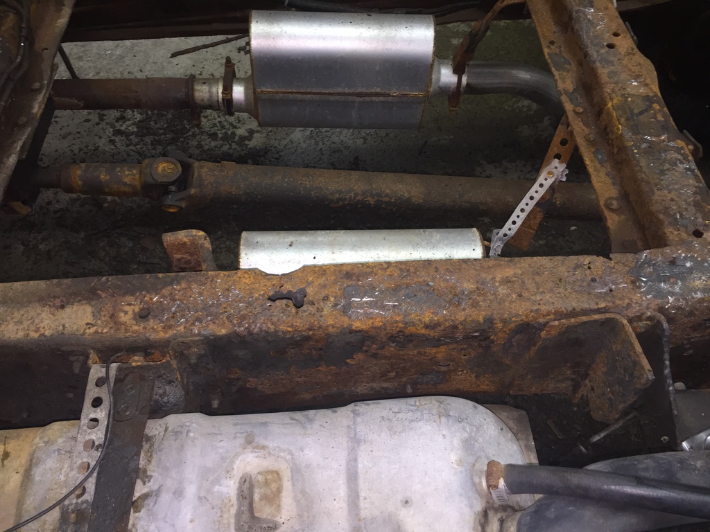

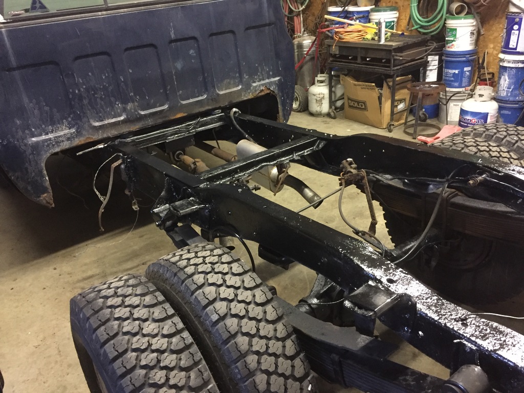

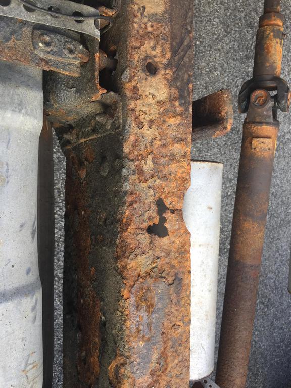

Red144runner 659 #27 Posted April 1, 2017 Have some experience in frame repair, not on my tractors but on my truck. Had a hairline crack across the top of one rail and some rot thru. Drilled the start of the crack to prevent further, then ground it all down and plated it with 3/16" same thickness as frame. Not a professional by any means, but it is super strong now. I'm sure you can fix frame up no problem. Thick steel is easier to work with. 2 Share this post Link to post Share on other sites

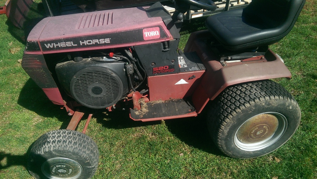

bo dawg 643 #31 Posted April 2, 2017 Now I know why the seat and fender pan was loose. Along with missing and cross threaded bolts. I seen these extra pieces of metal that didnt look right and figure there was something wrong and I was right. Now I got to figure something to use thats better than this 3/16 thick pieces so everything will bolt down nice. This is creative! I think I could have found a correct diameter bolt to use instead of this lag bolt. 3 Share this post Link to post Share on other sites

WVHillbilly520H 10,379 #38 Posted April 3, 2017 Job well done, what's kinda funny is with all it's issues the paint wheels and caps look to have been somewhat taken care of if not at least shed kept, compared to the low (236) hour one I picked last spring about this time, Jeff. 4 Share this post Link to post Share on other sites
Ed Kennell 47,818 #39 Posted April 3, 2017 Inside vs outside storage makes a big difference in appearance Jeff. 2 Share this post Link to post Share on other sites
WVHillbilly520H 10,379 #40 Posted April 3, 2017 3 hours ago, Ed Kennell said: Inside vs outside storage makes a big difference in appearance Jeff. Yep it sat outside for 15 years before I brought it home now under roof patiently waiting a custom? paint job, Jeff. 1 Share this post Link to post Share on other sites
bo dawg 643 #41 Posted April 3, 2017 Yeah inside is right, I hate to see a tractor left sitting outside with no over head protection at least. Mine was sitting under an awning attached to barn, but I bet it sat in the barn most of it time. I took a rag and some Mean Green and cleaned off the hood and fender, some of dash. It had a ton of bird poop all over it and I hated touching it every time I tried tinkering on it. Theres poop even in side the dash tower too cause the plate was off. The deck is even more covered, havent done anything with it yet. Lol! But yeah all in all its not bad with 891 hrs on the meter. Tire tread shows the rear though on the fronts. Now that the frame and tins are repaired now I got to look into the charging system. When running the amp gauge shows about 10 amps. The PO said he would have to charge battery after a couple times of mowing. I put a new battery in her and started with 12 amps but running is less. Maybe alternator. Also need a tune up and some carb clean or adjustment, but I thing she'll be fine for a while longer. 1 Share this post Link to post Share on other sites

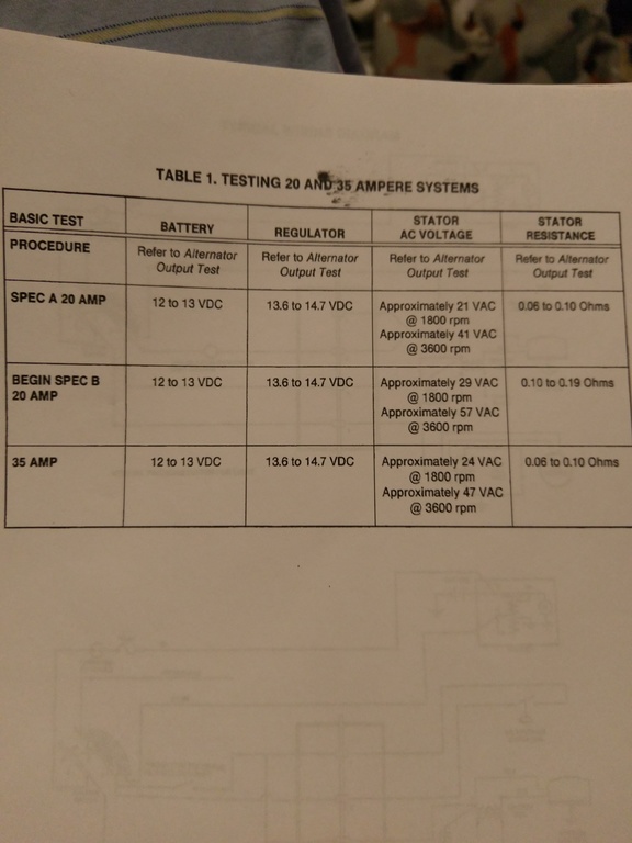

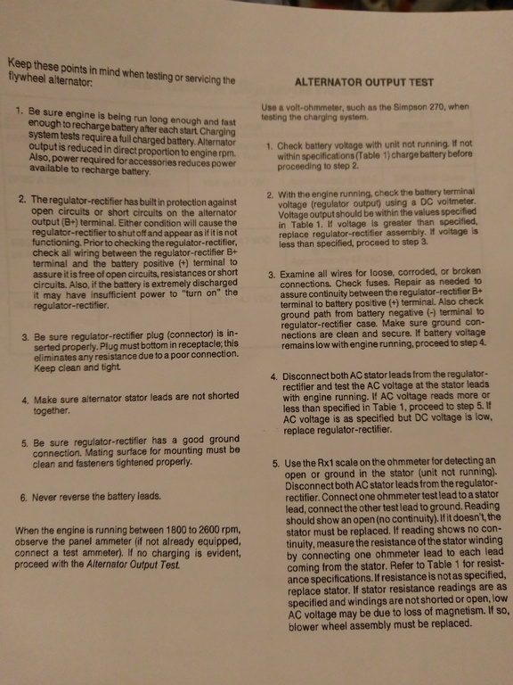

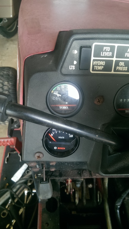

WVHillbilly520H 10,379 #42 Posted April 3, 2017 FYI should be volts not amps on the gauge(had to replace it on the one that sat outside) and Most likely the the voltage regulator(silver/black with three lugs bolted to engine tin) is bad usually first thing to go on an Onan, then the stator(altenator that's behind the flywheel), if you have a simple multi meter your battery should read 12.6 volts not running and 13.8-14.6 volts running half to WOT, all kinds of post on here about 520s and wiring electrical issues/fixes including my "Good Friday 520 clean up" ,Jeff. 3 Share this post Link to post Share on other sites
Red144runner 659 #43 Posted April 3, 2017 On 4/2/2017 at 6:19 PM, WVHillbilly520H said: Didn't mean to upset anyone to this point, and I probably took it out of context with a few comments and I'll let rest from here... Now with the trans tunnel covers there is supposed to be speed clips/nuts on the frame (1/4"-20 thread) to hold them fast, was Phillips head stove bolts I changed mine out to button head Allen bolts/screws (stainless steel if you want), Jeff. Nice! I'm gonna be needing these for my workhorse project 2 Share this post Link to post Share on other sites
bo dawg 643 #44 Posted April 4, 2017 1 hour ago, WVHillbilly520H said: FYI should be volts not amps on the gauge(had to replace it on the one that sat outside) and Most likely the the voltage regulator(silver/black with three lugs bolted to engine tin) is bad usually first thing to go on an Onan, then the stator(altenator that's behind the flywheel), if you have a simple multi meter your battery should read 12.6 volts not running and 13.8-14.6 volts running half to WOT, all kinds of post on here about 520s and wiring electrical issues/fixes including my "Good Friday 520 clean up" ,Jeff. Right! sorry I didn't mean Amps, I knew Volts. Lol! I guess I had amps on my mind. But yeah just going by the volts that the gauge was reading when I dropped a good battery in read 12 strong. But when started and running reads less than 12, more like 10. I will look at the regulator and hopefully find that its bad. Thanks Jeff. 1 Share this post Link to post Share on other sites
bo dawg 643 #45 Posted April 5, 2017 On 4/3/2017 at 7:47 PM, WVHillbilly520H said: FYI should be volts not amps on the gauge(had to replace it on the one that sat outside) and Most likely the the voltage regulator(silver/black with three lugs bolted to engine tin) is bad usually first thing to go on an Onan, then the stator(altenator that's behind the flywheel), if you have a simple multi meter your battery should read 12.6 volts not running and 13.8-14.6 volts running half to WOT, all kinds of post on here about 520s and wiring electrical issues/fixes including my "Good Friday 520 clean up" ,Jeff. Jeff whats the proper way to test the regulator to see if bad. With motor running, I put the tester red lead on the red wire post, and the black lead on either of the outside post and there is not any reading. Then I checked red on red and black on the battery ground and I do get voltage. With motor off I also put black lead on battery ground and red on red and it shows 12.5, (but I also get same reading when touching either of the 3 post when black lead on battery ground). 1 Share this post Link to post Share on other sites

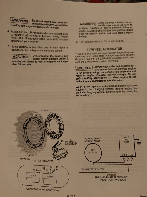

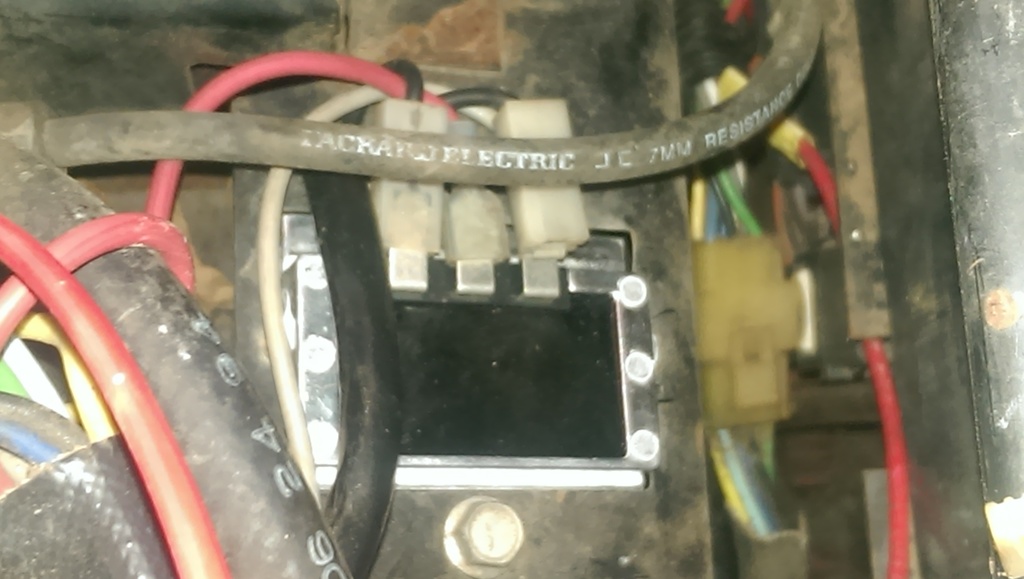

bo dawg 643 #46 Posted April 5, 2017 7 minutes ago, bo dawg said: Jeff whats the proper way to test the regulator to see if bad. With motor running, I put the tester red lead on the red wire post, and the black lead on either of the outside post and there is not any reading. Then I checked red on red and black on the battery ground and I do get voltage. With motor off I also put black lead on battery ground and red on red and it shows 12.5, (but I also get same reading when touching either of the 3 post when black lead on battery ground). Also in picture I noticed 1 of the stator wires having a little discoloring burn look. Share this post Link to post Share on other sites

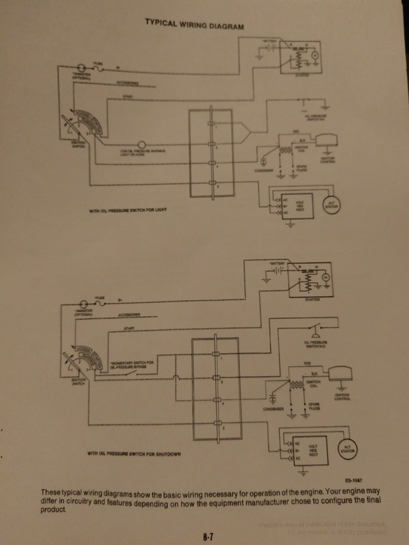

WVHillbilly520H 10,379 #47 Posted April 5, 2017 Ouch, looks like someone has already been in there and played electrician, I just check the voltage at the battery terminals if it charging it'll show there as well as the regulator, but I'll see if I have the Onan service manual for the "correct" way...go to the manual sections and down the Onan and your year 520 manuals it'll be worth your time, hope these pics help, Jeff. 2 Share this post Link to post Share on other sites
ericj 1,580 #48 Posted April 5, 2017 did you check the fuses, you should see battery voltaage, 12.5 on the red center wire if not you have a problem . If fuses are ok check the nine pin connector, or even maybe the the ignition switch. good luck eric j 1 Share this post Link to post Share on other sites
gwest_ca-(File Mod) 12,533 #49 Posted April 5, 2017 A discolored wire is cause for concern. Either the wire to terminal is not making a clean tight connection or the terminal to terminal connection is not clean and tight. Any resistance to current flow causes heat. Garry 4 Share this post Link to post Share on other sites
bo dawg 643 #50 Posted April 5, 2017 15 hours ago, ericj said: did you check the fuses, you should see battery voltaage, 12.5 on the red center wire if not you have a problem . If fuses are ok check the nine pin connector, or even maybe the the ignition switch. good luck eric j Yea I get 12.5 on all 3 when black lead is on battery ground. It starts right up and runs, just don't think its charging according to the volt gauge on tractor. It reads under 12. I'm just trying to learn how to properly check if the regulator is good and doing its job. 8 hours ago, gwest_ca said: A discolored wire is cause for concern. Either the wire to terminal is not making a clean tight connection or the terminal to terminal connection is not clean and tight. Any resistance to current flow causes heat. Garry Thanks Gary, I will check again but when I pulled it off the post it was tuff to pull off. I'll try cleaning best I can and see what happens. Could this also mean an issue with the stator? Share this post Link to post Share on other sites
