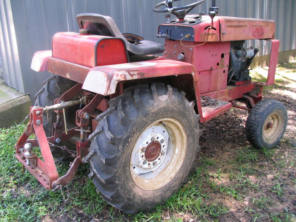

pacer 3,177 #3 Posted March 29, 2017 Stop & go tires has nice American Farmer ags in 7.5x15 for $88 - I have them on my 160 and 180. This pic is them on the 160, as you can see plenty of clearance (they are 30" tall) https://www.stopandgotires.com/tire/industrial/industrial?sku=FA5J1&name=American Farmer Traction Implement I-3 Share this post Link to post Share on other sites
ricksrj58 273 #4 Posted March 30, 2017 that helps,my 31x9.50x15 thornbirds should fit when i get time to go get them,thanks Share this post Link to post Share on other sites
pfrederi 19,062 #5 Posted March 30, 2017 (edited) 19 minutes ago, ricksrj58 said: that helps,my 31x9.50x15 thornbirds should fit when i get time to go get them,thanks I hope they run small because 31's would rub on my tractor or be too close for comfort Edited March 30, 2017 by pfrederi Share this post Link to post Share on other sites
