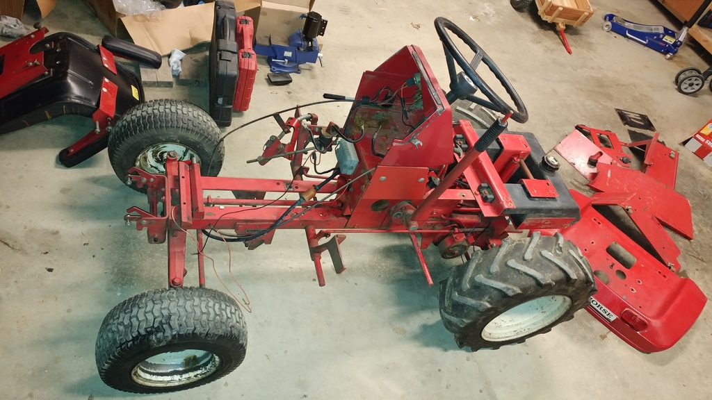

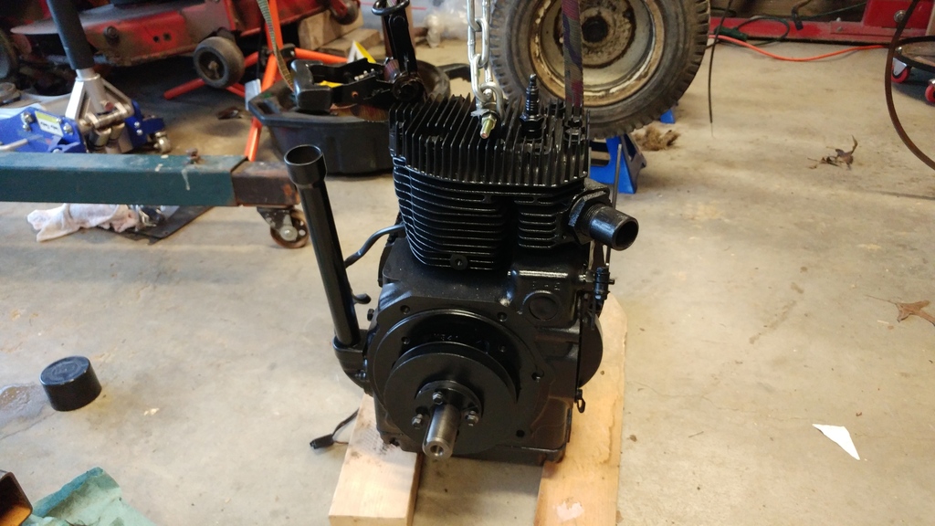

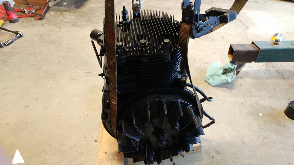

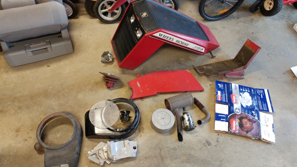

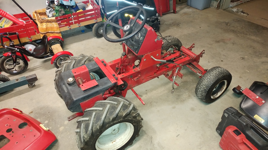

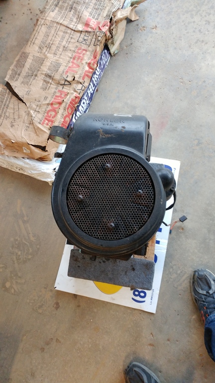

bmsgaffer 2,069 #2 Posted March 27, 2017 I started tearing into it today. I have a rebuilt K-341 with 0 hours that is just about ready to drop into it. I just need a few small things finished up before I am ready to run it! Its amazing, we have never once changed the gear oil, it was still yellow after 30 years of use. We have also not once changed the drive belt, and after at least 30 years I have inspected it and i dont even need to replace it. Its in great shape. I got the old engine out, and the only thing that was wrong was that the rod cap bolts were loose. Which kills me as if I had immediately shut down the engine instead of driving it back to the garage, I probably could have just tightened them up and fired her right back up. There seems to be too much damage to the rod bearing surface, the crank seems to be OK. Oh well, she will go on the shelf to be used if we ever go back to original. I wish I had taken pictures before buttoning it back up. The entire tractor is in great shape except for the paint which is OK and the front wheel bearings are totally shot. I hope the wheels can be saved and the spindles are ok. I dont think I will be doing anything else to here but fresh fluids all around with a new K341. 8 Share this post Link to post Share on other sites

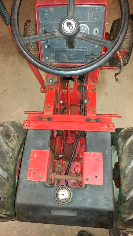

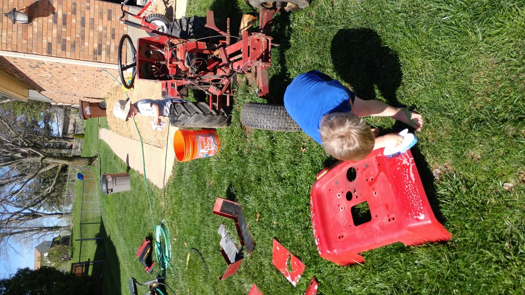

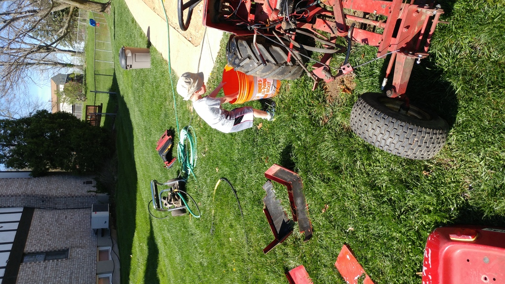

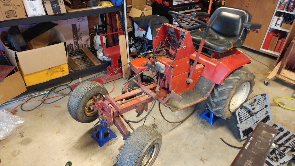

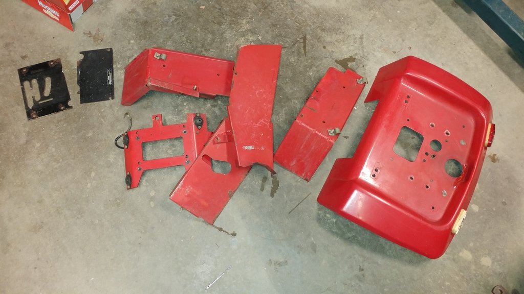

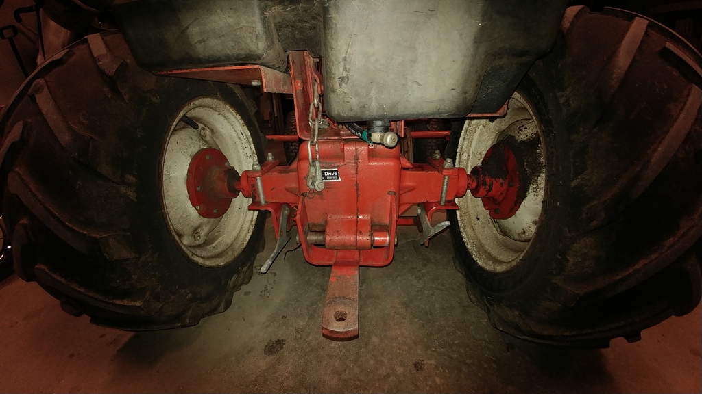

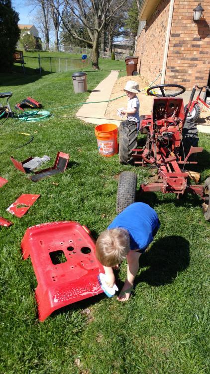

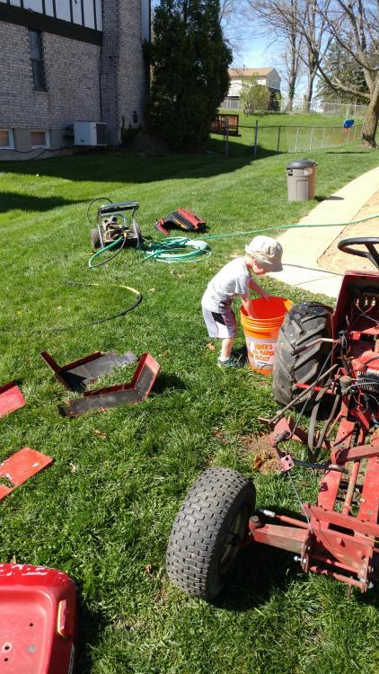

bmsgaffer 2,069 #9 Posted April 11, 2017 Things are moving slow lately around here having a new addition. I got the boys outside this weekend to give momma and the 4 week old some much needed quiet time. They are especially excited to work on this tractor since I tell them stories about working on it and using it when I was a boy. I have been around this tractor for two decades and I never knew it had the rear rock shaft, tube, and lift cable already! Bonus! I always saw the clevis in the back but never knew it was for lifting. We missed out on so many opportunities not knowing what kind of things were available for this tractor! Got it fairly cleaned up (this will be a worker for quite a few years until it gets refurbished). The two different ags bother me to some extent, but they do just fine. Items I need and will be searching around for or posting here: One head bolt for the K341 - Not sure how I lost one, but it is what it is. All front wheel bearings - Need to do some work on the rims to get them to hold the bearing better. New rubber isolators (gosh these are expensive, Not sure if I am not ready to go solid mount yet...) Fuel cap w/gauge rear light cover (or new rear lights) touch up paint to cover scratches until refurb K341 carb. (I have one that was painted but need to dig into see if it is worth it or not) Fuel pump rebuild kit K341AS dipstick Pack of speed clips for the bolts on the metalwork If anyone has any of the above message me! I will probably post a classified later. 2 Share this post Link to post Share on other sites

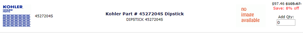

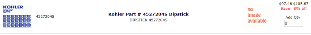

bmsgaffer 2,069 #12 Posted April 11, 2017 So the dipstick that came in this engine was hacked together by the PO. I went to go get a replacement... You have GOT to be kidding me! 1 minute ago, bds1984 said: I wouldn't even mess with that carb... For less than $30 you can have a new one shipped. I've purchased three of them in the last three years and have not had any issues with them. http://www.ebay.com/itm/Carburetor-For-Kohler-K321-K341-Cast-Iron-14-hp-16-hp-14HP-16HP-Engine-Carb-/112336620767?hash=item1a27c8ccdf:g:5SoAAOSwSlBYykMm I have done one of those in the past and I have been happy with it other than i bought the wrong choke setup with it. I was able to cobble something together from the old carb that worked but next time I need to double check the choke setup. Is this link one that you have purchased before? I hate to say it, but I wish the chinese would knock off the dipsticks too... 1 Share this post Link to post Share on other sites
bds1984 1,506 #13 Posted April 11, 2017 Just now, bmsgaffer said: So the dipstick that came in this engine was hacked together by the PO. I went to go get a replacement... You have GOT to be kidding me! I have done one of those in the past and I have been happy with it other than i bought the wrong choke setup with it. I was able to cobble something together from the old carb that worked but next time I need to double check the choke setup. Is this link one that you have purchased before? I hate to say it, but I wish the chinese would knock off the dipsticks too... This is the one I have purchased that resides on my C165. The linkages were fine for the K series, but for the Magnums, the chokes were the opposite; down on the lever was on and up was off. A simple swap of choke plate shafts and I was on my way. 1 Share this post Link to post Share on other sites

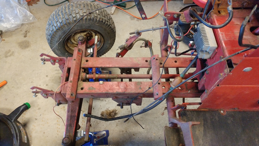

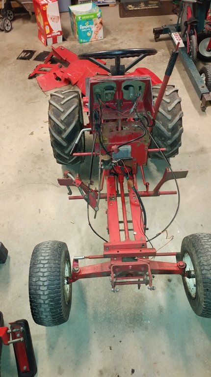

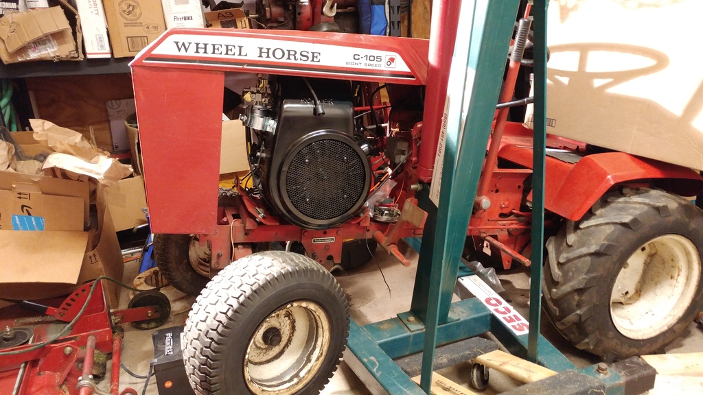

bmsgaffer 2,069 #14 Posted May 5, 2017 (edited) This is progressing VERY slowly. I may get 10 minutes or an hour here and there to poke around at things. But I stayed up WAY too late last night to get the K341 bolted in. The hood is just sitting on there for a place to put it so my wife can park in the garage. I have to finish up the linkages on the engine, put in my coil, transdensor (yes that is correct), muffler and various odds and ends to get her buttoned back up and running. I still need to work some magic on the front wheels so they hold the bearings tight. Edited May 5, 2017 by bmsgaffer 5 Share this post Link to post Share on other sites
