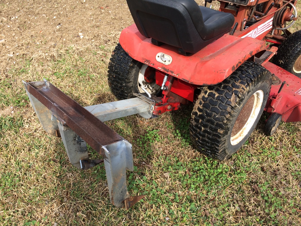

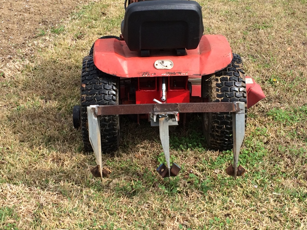

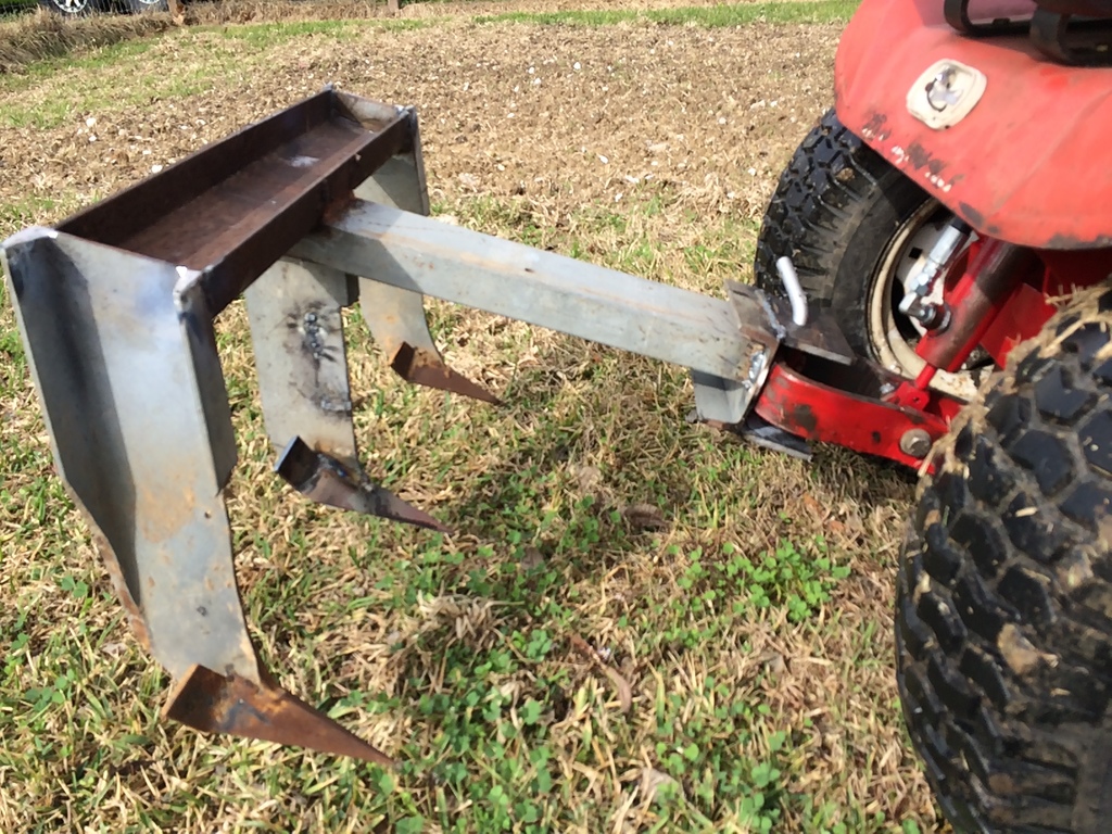

Huntemcd 239 #1 Posted March 26, 2017 My raider 8 with my subsoiler I made. I haven't tried it on my wheel horse. Can't wait to try it out. 6 Share this post Link to post Share on other sites
JC 1965 1,534 #2 Posted March 26, 2017 Should work very well. Thanks for sharing. Share this post Link to post Share on other sites
Huntemcd 239 #3 Posted March 26, 2017 1 hour ago, JC 1965 said: Should work very well. Thanks for sharing. It should work. I have pulled it behind my farmall cub Share this post Link to post Share on other sites
Tankman 3,526 #4 Posted March 26, 2017 Looks great. Does the susoiler tend to dig in deep? Thinking, "Maybe a wheel to set the max depth?" 1 Share this post Link to post Share on other sites
Huntemcd 239 #5 Posted March 26, 2017 18 minutes ago, Tankman said: Looks great. Does the susoiler tend to dig in deep? Thinking, "Maybe a wheel to set the max depth?" It all depends how far forward I have the lever. It should if breaks the plow pan that the plow misses. I had the subsoiler with just one tine going down. Then this winter I added the 2 outer ones. Share this post Link to post Share on other sites

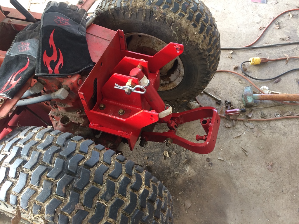

Hacksawhero123 351 #6 Posted March 26, 2017 That's pretty similar to the ripper I built. Mine works pretty well 4 Share this post Link to post Share on other sites

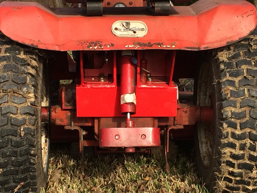

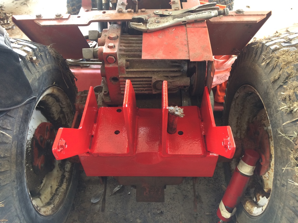

Duramax7man7 506 #12 Posted March 29, 2017 @Hacksawhero123 Can we see more detailed photos of your lift piston? That looks interesting. Share this post Link to post Share on other sites

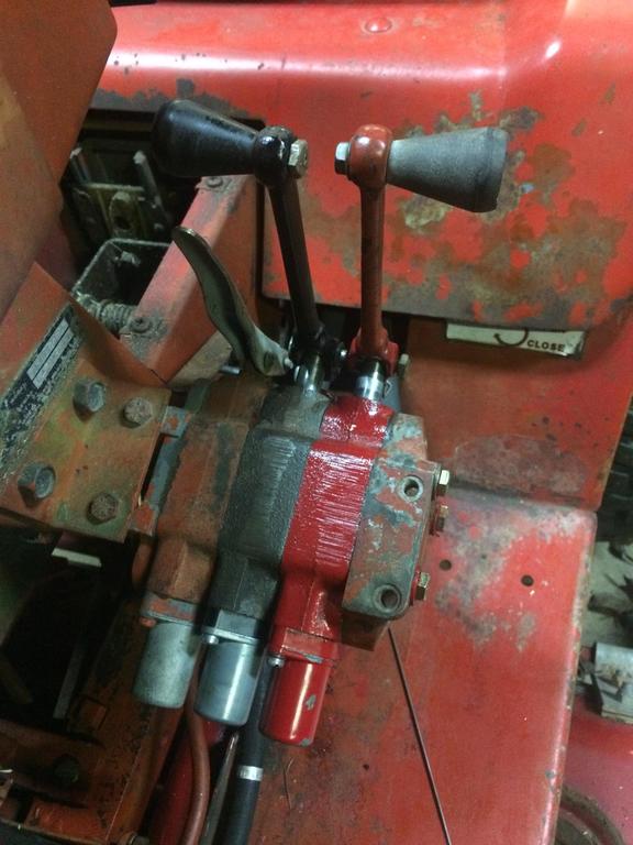

Hacksawhero123 351 #13 Posted April 7, 2017 Mastiffman, the hitch lift uses a duplicate of the deck lift cylinder mounted almost vertical. I stacked an extra spool valve to operate independently. Fabbed up a bracket to mount to the four bolts on top of the axle 1 Share this post Link to post Share on other sites
Hacksawhero123 351 #14 Posted April 7, 2017 Oh, and if anyone knows where I can find a valve block with the float detent, I'm looking for one. Thanx! Mark. 1 Share this post Link to post Share on other sites
Duramax7man7 506 #15 Posted April 7, 2017 Very nice! I like it! You can really force it into the ground! Share this post Link to post Share on other sites
R. L. Addison 300 #16 Posted April 7, 2017 Someone had a Sears loader parts list with valve part#'s, I'm going to try tyhat soon as I can. Share this post Link to post Share on other sites
