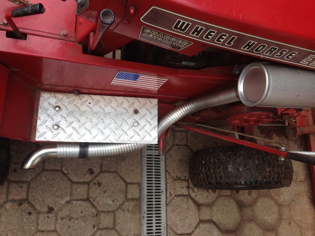

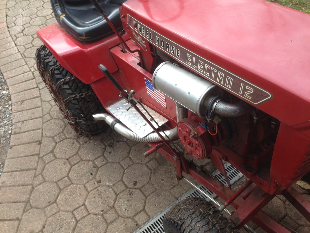

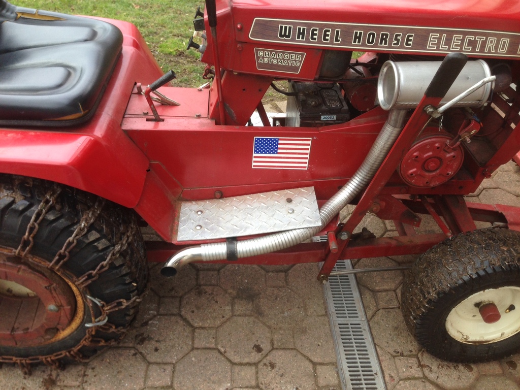

formariz 12,353 #1 Posted March 25, 2017 So being unhappy all of these years with replacement mufflers for the Electro and not wanting a tall stack I finally decided to adapt the Jay Bee muffler to it. A little improvised plumbing and although unusual and probably not for everyone, after using it for a while I am really happy with it. Incredibly I now can hear just engine noise from front even realizing that my PTO has a ringing noise which I never noticed before. From tailpipe, just a nice burbling exhaust note right under tractor. 11 Share this post Link to post Share on other sites

stevasaurus 23,521 #4 Posted March 25, 2017 I like it Cas...did you have to do anything to the muffler itself. (fabrication)??? 1 Share this post Link to post Share on other sites

formariz 12,353 #6 Posted March 25, 2017 1 hour ago, wfrpalm said: That looks pretty good. What year is the tractor. It is a 1969. 33 minutes ago, stevasaurus said: I like it Cas...did you have to do anything to the muffler itself. (fabrication)??? No, muffler is exactly as it came. That elbow on the intake makes it really very adjustable and versatile. 15 minutes ago, ACman said: Pretty neat... That would easy for a good muffler shop to bend up and duplicate if you wanted ! I was going to go with hard connections at first but for $20.00 decided to buy the flexible pipe, a 6 foot section so this way I could experiment with various setups. It worked out really well also since ID of pipe is 1-1/2" fitting perfectly over muffler pipe, and then the original chrome tail piece that came with tractor muffler when I got it is 1-1/2" OD and fits perfectly at other end. No clamps needed. Routed this way it does not interfere with anything or any attachments. 4 Share this post Link to post Share on other sites
