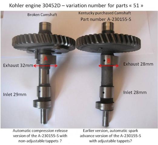

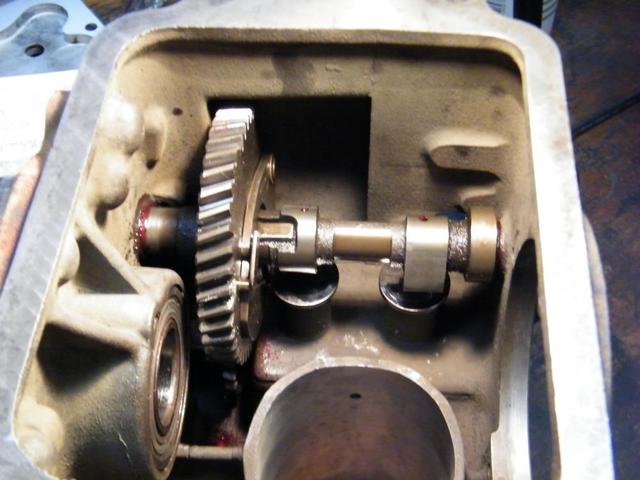

stevasaurus 23,641 #14 Posted March 28, 2017 (edited) Here are the 2 choices of the cams. The first one has the ACR...the stuff for that is on the right of the cam gear. Here is the other option that advances the gap in the points to mainly do the same thing that ACR does. This is on the left side of the cam gear This is the 2 piece cam shaft. This is automatic Spark Advance. If you have the second one...your tappets are the same length and you do not have to worry about the ACR holding up the exhaust valve when grinding the valve clearance. Here is the good manual... Edited March 28, 2017 by stevasaurus 1 Share this post Link to post Share on other sites
carlosking450 161 #15 Posted April 2, 2017 Good night at the end uncover the bottom lid and I saw that it does not have ACR. 1 Share this post Link to post Share on other sites
