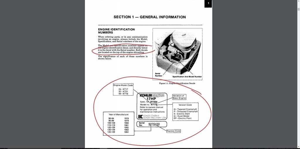

AMC RULES 37,259 #26 Posted April 22, 2017 Now, what is the spec # on the silver engine ID decal? Here's betting...you've got yourself a series two engine there. Share this post Link to post Share on other sites

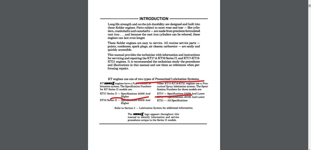

pfrederi 21,141 #29 Posted April 22, 2017 11 hours ago, 953 nut said: wheelhorseallyears.pdf 01-17KE03 1983 C Series Garden Tractor C-175 Twin Automatic Kohler KT17-24223 17 Eaton 1100-032 If that is the actual spec number then this is a series 1 KT17. Keep her full up (maybe a bit over) with oil avoid extended running on hills and she will do fine. 2 Share this post Link to post Share on other sites

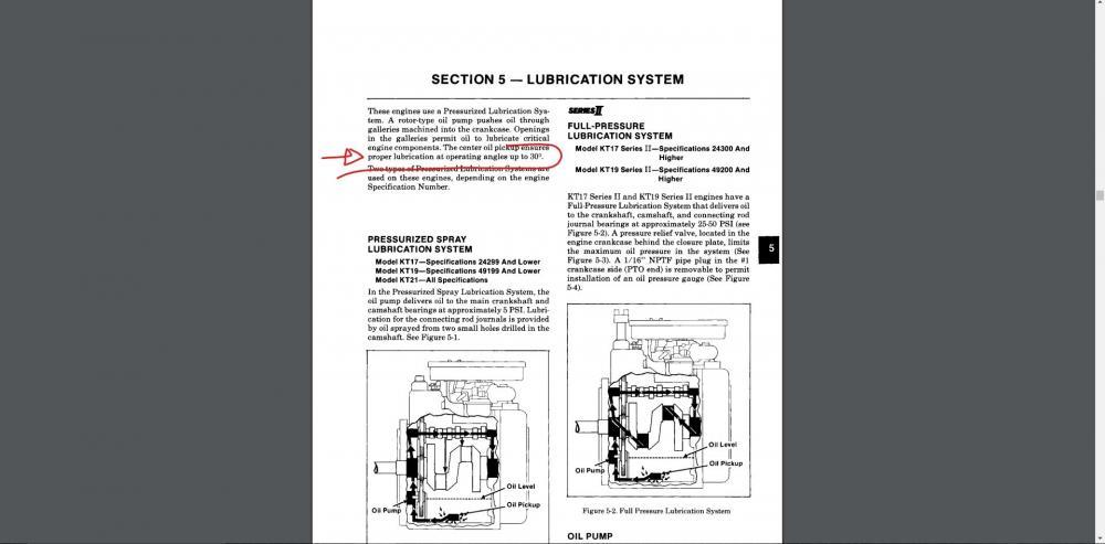

pacer 3,180 #30 Posted April 22, 2017 I loves them black hoods---- I would just re-stress the comments about your twin engine being a series1 and its oil. When Kohler introduced this twin apparently the engineers designed it on a Monday and overlooked that it didnt like to be operated at a very steep angle However, as mentioned if you are aware of that quirk and carefully maintain the oil - keeping it changed and somewhat overfilled, and especially using good judgement operating it on an incline the engine will give you good service. (actually this advice is pertinent to any engine!) After a couple years? production of the series1, Kohler came out with the series2 which had a pressured oil system. I had a C-175 for a period of time and where my property meets the roadway I have a maybe15-20° angle (for the ditch) and the first few times I cut that I was a bit nervous, but, as time went on and the engine didnt blow! I didnt think about it. 4 Share this post Link to post Share on other sites

AMC RULES 37,259 #32 Posted April 22, 2017 (edited) From the Kohler factory service manual...for both Series 1, and 2 engines... the recommended safe operating angles is no more than 30 degrees. Edited April 22, 2017 by AMC RULES 2 Share this post Link to post Share on other sites

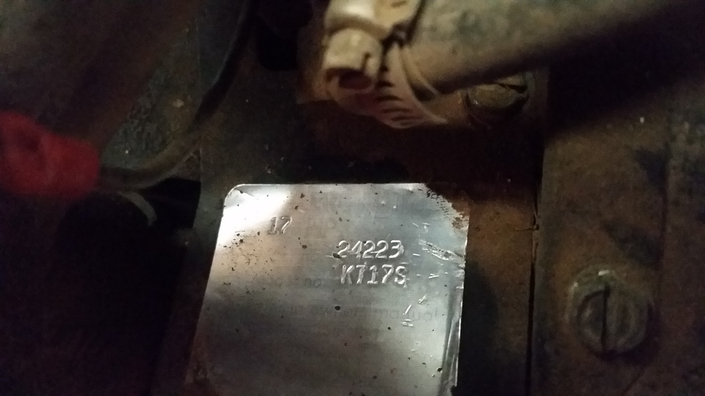

Countryboy12v 10 #33 Posted May 16, 2017 Here is the tag from the engine. Thanks again yall. Keith 1 Share this post Link to post Share on other sites
AMC RULES 37,259 #34 Posted May 16, 2017 Yep, series one... refer to post #29 above. 1 Share this post Link to post Share on other sites
