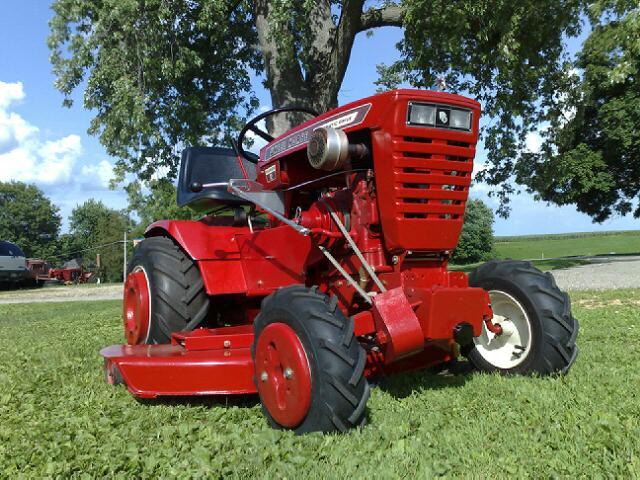

Sarge 3,470 #4 Posted March 25, 2017 Charger 12 is a great machine if someone hasn't destroyed the Sundstrand transmission/pump . I got one pretty cheap and restored it for a birthday present to a brother in law - runs excellent and the limited slip rear axle is a beast . A little inspiration - Sarge 2 Share this post Link to post Share on other sites
