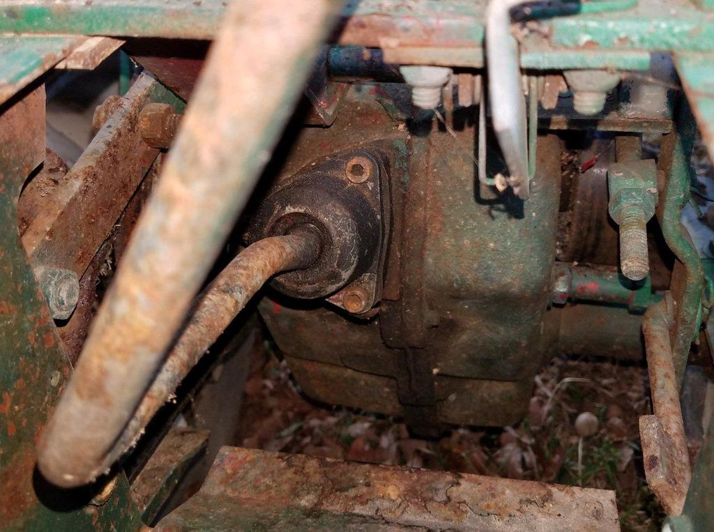

N3PUY 1,031 #35 Posted March 25, 2017 I think it is an "800 Special". 3-speed transaxle .... NOT a Uni-Drive. The stub at the front of the frame is for the deck pulley. 3 Share this post Link to post Share on other sites

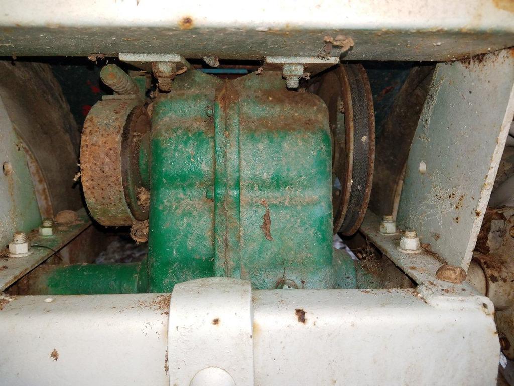

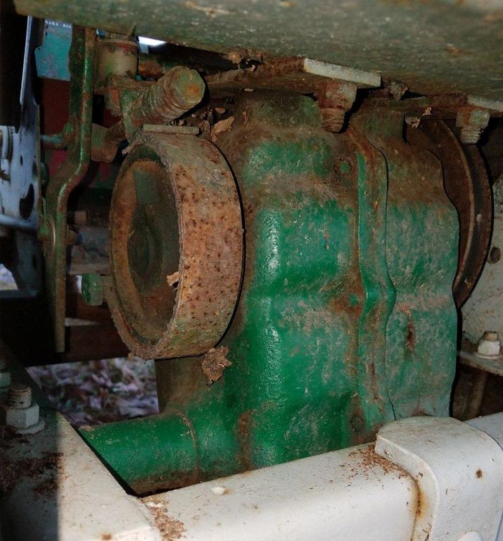

G-Sarge 12 #36 Posted March 25, 2017 6 hours ago, gwest_ca said: If it has battery ignition you need to power the (+) terminal on the coil and ground the chassis to the battery (-). The charging system will not power the ignition. It should pull start then. If no spark clean the ignition point contacts. Garry Thanks! 3 hours ago, N3PUY said: I think it is an "800 Special". 3-speed transaxle .... NOT a Uni-Drive. The stub at the front of the frame is for the deck pulley. YEP, YOU NAILED IT! I went out before it got dark and took detailed photos of the transaxle and it is exactly like that. I'll post them tomorrow. The rear frame and hitch are identical too. I'm certainly learning some good stuff here (and I believe some others are too...) Thanks! 2 Share this post Link to post Share on other sites

wildman 205 #39 Posted March 25, 2017 18 hours ago, George Washington said: to the pro's on here - has the rear-end/hitch been modified? That doesn't look like a WH set up to me - I think your best bet for the money would be to part it out but that's just my opinion. Factory hitch, that rig came with a tecumseh peerless 2300 I would say 800 special the A90 was a 1974 model only with late 60's hood 3 Share this post Link to post Share on other sites
T-Mo-(Moderator) 5,003 #40 Posted March 25, 2017 11 minutes ago, wildman said: Factory hitch, that rig came with a tecumseh peerless 2300 I would say 800 special the A90 was a 1974 model only with late 60's hood I agree, it looks like a Peerless 2300 series transmission to me also. I have seen a few of those on John Deere 110/112 and the older 200 series. Share this post Link to post Share on other sites

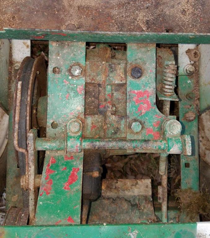

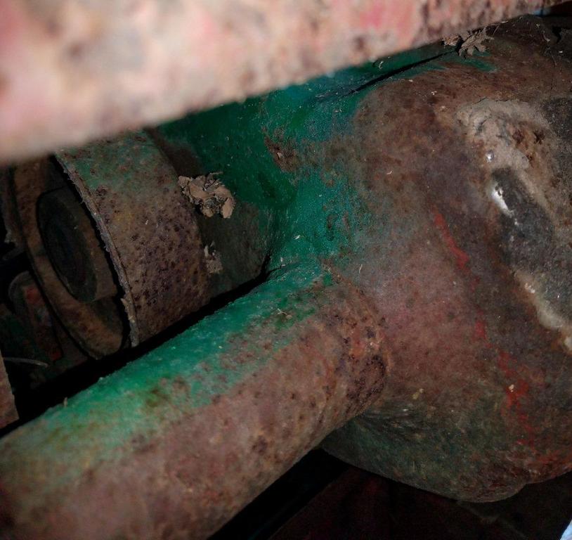

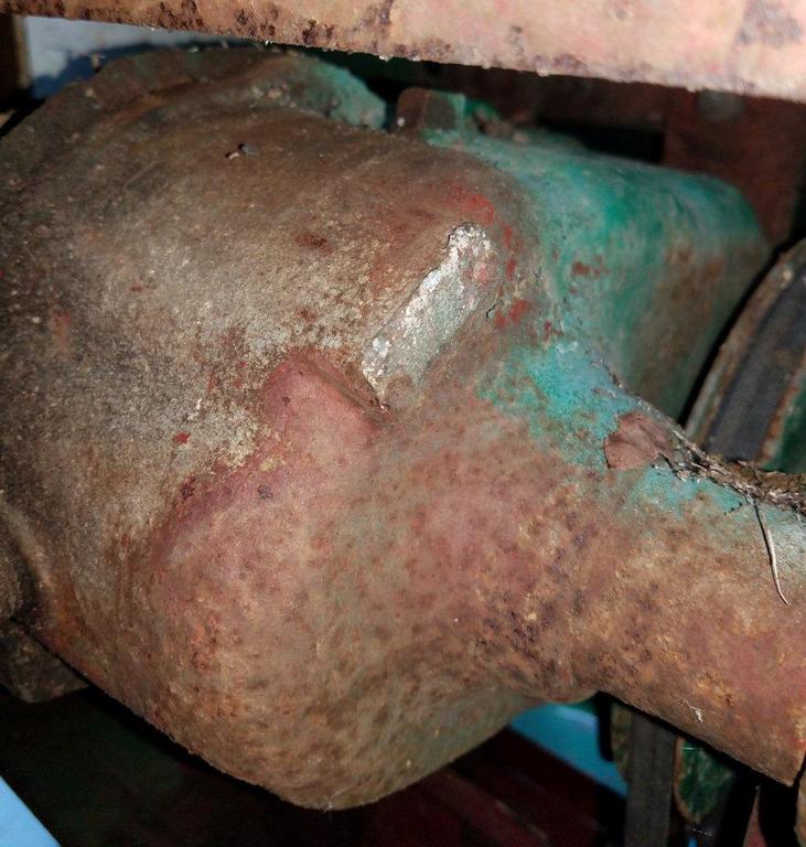

G-Sarge 12 #41 Posted March 25, 2017 (edited) OK Fellas, thanks for knocking your heads together on this jalopy! Now that you have, and it looks like the general consensus says its an 800 special with Peerless transmission from the early 70s, (unless I'm completely confused), I have a few more questions: #1: Is it 'stock' or not, and if stock AND I get it running and the transmission doesn't show signs of water intrusion and works correctly, then is the value still at $100-$150? #2: If it isn't a 'stock' transmission and it is one that is more suitable for high-speed racing, then do you think it would be more valuable to the mower racing folks? (If it isn't stock, then that transmission lines up and bolts up like it was made for the tractor) Here are some close-ups of the transmission. Thanks again for all the help and info! Edited March 25, 2017 by G-Sarge 1 Share this post Link to post Share on other sites
N3PUY 1,031 #42 Posted March 25, 2017 I sold this running one for $100. And included an extra transmission. The original motor is 8HP. I say the condition yours is in maybe $50. 2 Share this post Link to post Share on other sites
T-Mo-(Moderator) 5,003 #43 Posted March 25, 2017 Yep, definitely a Peerless 2300 transmission. Weak spot in those are the shifter fork detent springs, which become weak or break and will allow the transmission to locked into one gear. Easy fix, and cheap, about $12 for the springs and detent balls, and a few more $ for a gasket. You have to drop the transmission and split it open, just be sure the half with the shifter is on the bottom. If not the gears will fall out and you have a mess to figure out. 2 Share this post Link to post Share on other sites
stevasaurus 23,884 #44 Posted March 25, 2017 Nobody actually said it, but that trans is stock to that horse. Thanks for all those pictures. I did not spot any leaks...that is a good sign. 1 Share this post Link to post Share on other sites
gwest_ca-(File Mod) 12,533 #45 Posted March 25, 2017 Noticed the available info on both models shows the transmission as a model 1400 Peerless and the only two models to use it. Is the 2300 similar? Garry 1 Share this post Link to post Share on other sites
T-Mo-(Moderator) 5,003 #46 Posted March 26, 2017 12 hours ago, gwest_ca said: Noticed the available info on both models shows the transmission as a model 1400 Peerless and the only two models to use it. Is the 2300 similar? Garry Yes. Pretty identical, I believe, at least from quick observation. 1 Share this post Link to post Share on other sites
