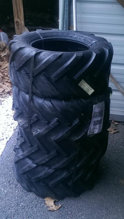

littleredrider 409 #2 Posted March 21, 2017 I can tell yah in a couple months lol. I want to get a set of those, but closing on a house tomorrow, and money is gonna be tight. But no reason they won't fit.... 1 Share this post Link to post Share on other sites

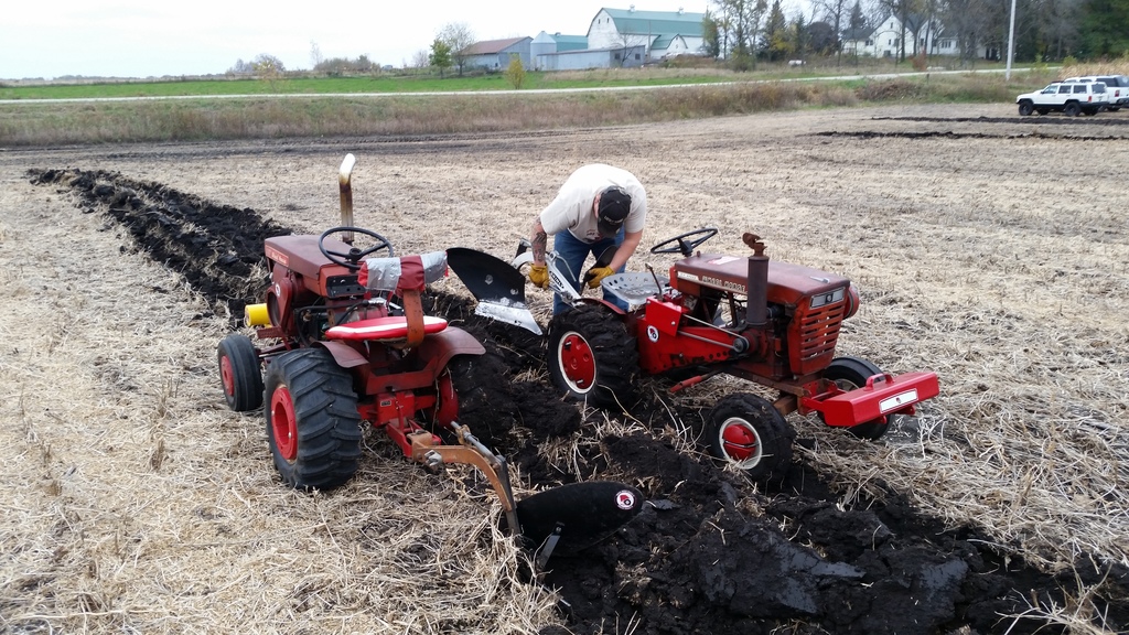

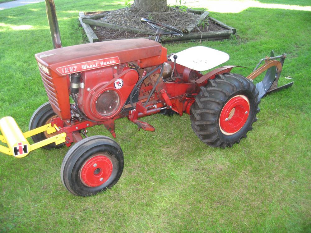

Shynon 7,533 #3 Posted March 22, 2017 (edited) I have a set on The Machine I know it's not a 520, but for pulling a plow they pull, no wheel slippage. So far probably best investment on The Machine to date. Edited March 22, 2017 by Shynon Add picture 6 Share this post Link to post Share on other sites

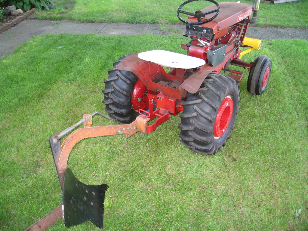

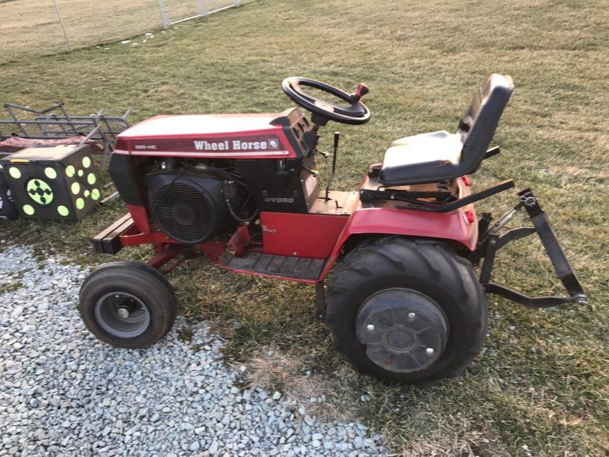

HorseFixer 2,014 #4 Posted March 22, 2017 (edited) On 3/21/2017 at 8:10 PM, Shynon said: I have a set on The Machine I know it's not a 520, but for pulling a plow they pull, no wheel slippage. So far probably best investment on The Machine to date. Those Tires Look Bad Arse! Whats that tractor like an 857 or sumptin? Definitely makes that tractor look MEAN! Here I found this picture Of a 520-H don't know if they are Firestone's or not but looks like they fit okay. Duke Edited March 23, 2017 by HorseFixer 3 Share this post Link to post Share on other sites
Shynon 7,533 #5 Posted March 22, 2017 18 minutes ago, HorseFixer said: Whats that tractor like an 857 or sumptin 1257 pulls a 12" bottom 3 Share this post Link to post Share on other sites
HorseFixer 2,014 #6 Posted March 22, 2017 I was 4 Ponys Short couldn't see the BIG BLOCK from that angle by the way!!! Brother I love that Tractor but that YELLOW TURD HANGIN OUT FRONT HAS TO GO! 6 Share this post Link to post Share on other sites

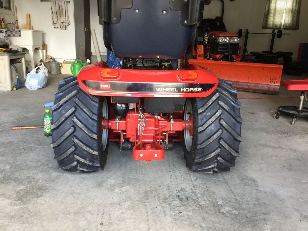

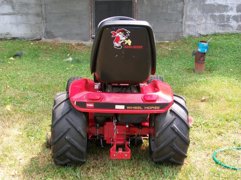

WVHillbilly520H 10,378 #10 Posted March 22, 2017 Here's the Carlisle Tru-power 23x10.50-12s on a 520H and that is the factory stock size, I'm sure the Firestone aren't much different, Jeff. 7 Share this post Link to post Share on other sites

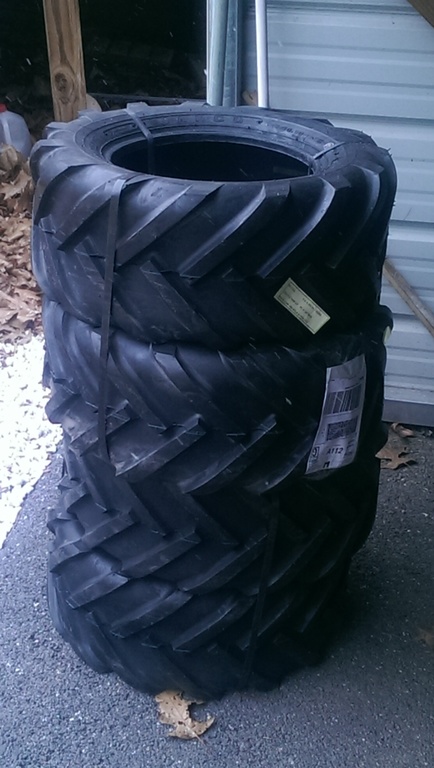

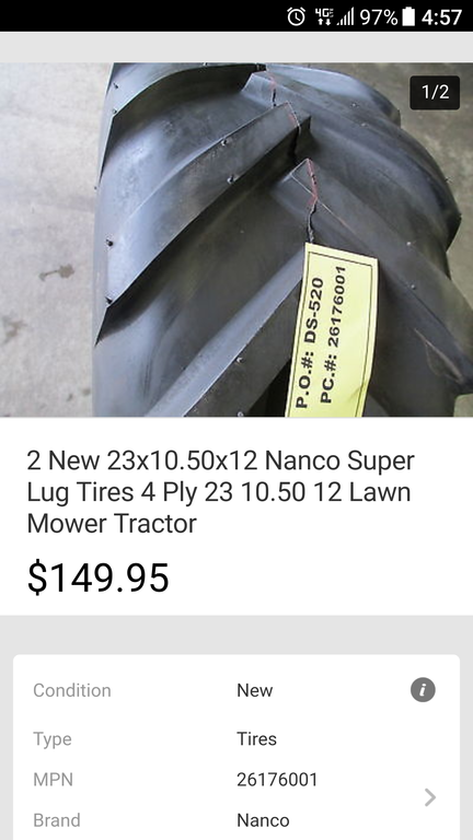

WVHillbilly520H 10,378 #13 Posted March 23, 2017 Duke, I bought these Nanco Ags for my replacements, Jeff. 2 Share this post Link to post Share on other sites
MalMac 1,334 #14 Posted March 23, 2017 The 23's from Firestone are in my opinion a much better Ag tire. We use them on are big farm tractors. I have used them on my Wheel Horse loader tractors over the years. Now with that said the price for the Firestone has gone up so much that it is not cost effective to use them on such a small tractor. There are other V bar Ag tire's out there that will perform almost just as good for a fraction of what the cost of a Firestone is. 2 Share this post Link to post Share on other sites
stevebo-(Moderator) 8,604 #15 Posted March 23, 2017 The nanco tires are cheap but even though the size is 23 x 10.5 they are about 8" wide 1 Share this post Link to post Share on other sites

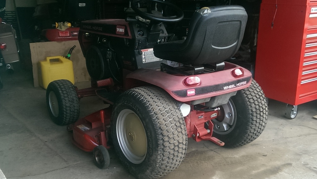

WVHillbilly520H 10,378 #16 Posted March 23, 2017 (edited) 1 hour ago, stevebo said: The nanco tires are cheap but even though the size is 23 x 10.5 they are about 8" wide They're as wide if not wider than the original DICOs that came on them new, when I get home from work I'll run a tape across them with a pic, Nankang tires (pictured) on my anniversary I bought used 10 years ago are being replaced as well as a pair of original DICOs on the low hour 520 when it warms up, Jeff. Edited March 23, 2017 by WVHillbilly520H 2 Share this post Link to post Share on other sites

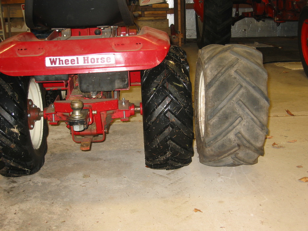

HorseFixer 2,014 #20 Posted March 23, 2017 38 minutes ago, pfrederi said: They can be misleading they say 6 ply rating...doesn't mean they have 6 plies just it meets some strength rating. Talk about size variance between manufactures one is a deestone the other Carlisle same size marked on then sidewall WHICH ONE IS WHICH? Share this post Link to post Share on other sites
pfrederi 19,796 #21 Posted March 23, 2017 sorry small ones are deestones Share this post Link to post Share on other sites

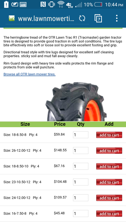

WVHillbilly520H 10,378 #22 Posted March 23, 2017 Duke here's another brand to put into the Arsenal "OTC" and they look very similar to the Firestone priced with Carlisle but they offer the same tread in 16x7.50-8...Jeff. Share this post Link to post Share on other sites

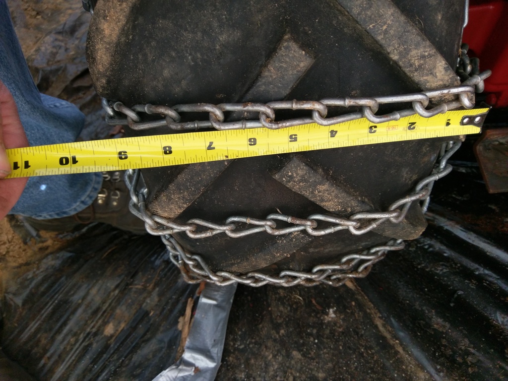

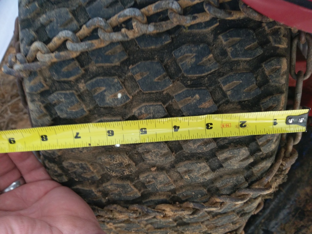

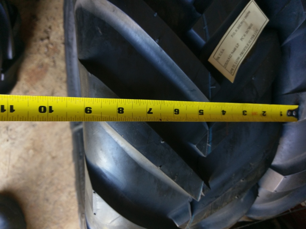

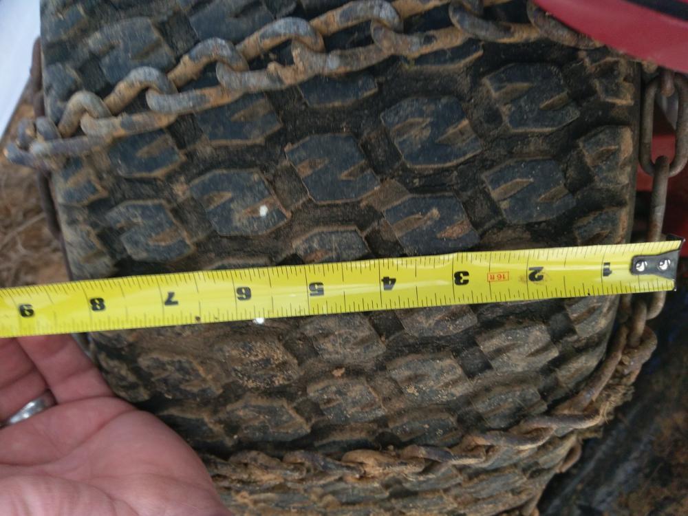

WVHillbilly520H 10,378 #24 Posted March 23, 2017 As I said I would do when I got home I took a tape measure and pictures of the various tires the new unmounted Nanco measured right at 9" across the v bars so add in side wall probably 10" even, the old Nankangs mounted 9.5" across the bars and the original mounted Dicos 8-8.5" across the tread, all tires have 23x10.50-12 sizing on the sidewalls so my thoughts were right the AGs are wider than the Dicos, also measured my new Mahindra SCUT with Carlisle trac gard tires 20x8.00-10 was right on 8" wide and the 27x12.50-15 was 12", doesn't seem to matter what brand none will be the size as designated , Jeff. 2 Share this post Link to post Share on other sites
