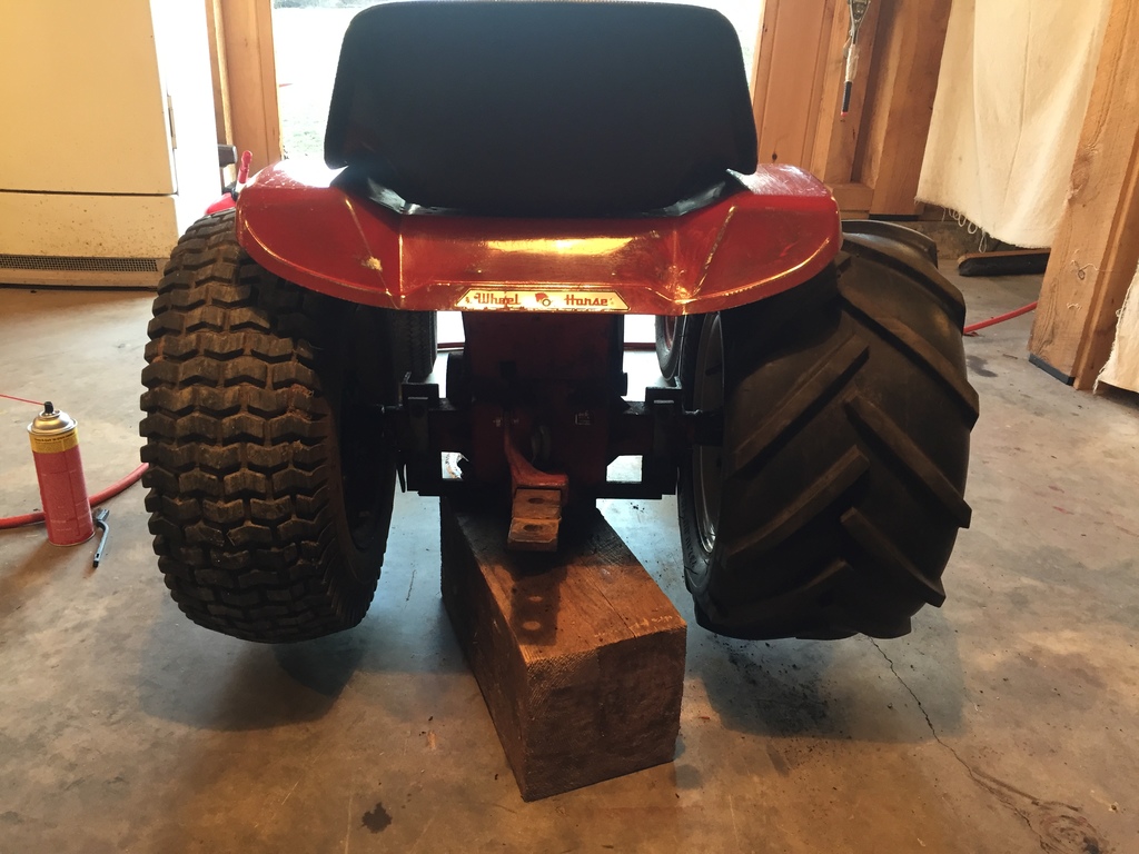

stevebo-(Moderator) 8,604 #9 Posted March 16, 2017 Yeah you will want to find a set of rear rims off any 520. You can get the wider tire on them and the off set is correct. This pic show the difference. Left is original like you have now and right is the bigger 520 rim with 23.50 x 10.50 ags Be careful when buying new tires. I have seen 23.50 x 10.50 that were knock offs and were about the same width as the 8.50. 8 Share this post Link to post Share on other sites

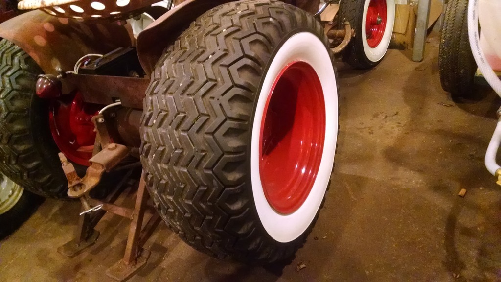

Achto 30,860 #12 Posted March 17, 2017 I was out in the garage tonight & remembered that I had another set of 10.50's on 7" rims. Thought I'd share. 5 Share this post Link to post Share on other sites
