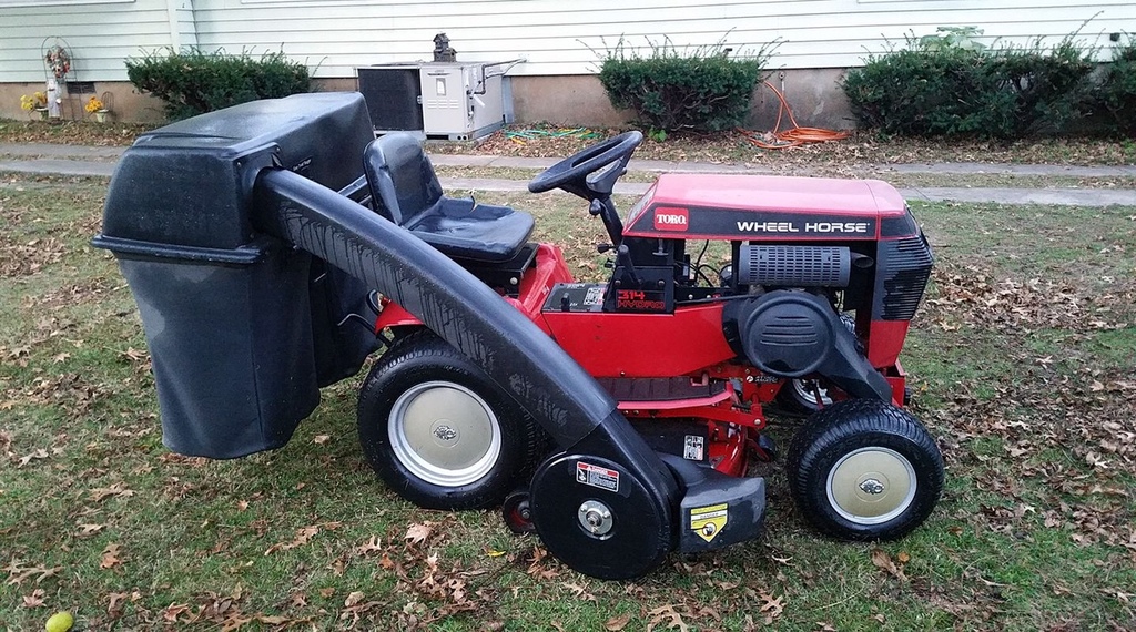

George Washington 68 #1 Posted March 13, 2017 I'm going to look at this beauty tonight. Its a 314-H with a 42 or 48 inch deck (not sure yet), canopy (not shown), and 480 hours on the meter. He is the 2nd owner and says its always been garaged. He says he would like to get $600 so I'm almost certain im bringing it home tonight to replace a junky craftsman but I'm curious on the total value of the tractor as a package deal as well as the individual pieces) and also just what everyone's opinion is of the 314H in general - Ill be using it just for mowing and light yard duty (I have a C-160 for heavy work). I know this is a great deal but I would just like to get as much info from others who are more experienced. I always feel better when I'm encouraged by others. This will be my 2nd wheel horse and my wife's first so I want to make sure she loves it as much as I do 12 Share this post Link to post Share on other sites
Irv 115 #2 Posted March 13, 2017 You said it, "it's a great deal". Tractor alone is well worth more than that. I'm sure it's a 42" deck with the blower unit and that is great for leaves as well as grass. I have a 314-8 and I love it, plenty of power and not bad on gas. Run-don't walk to get that gem! 4 Share this post Link to post Share on other sites
Ed Kennell 44,380 #3 Posted March 13, 2017 With the Eaton 1100 trans and that bagger....snag it quick. The only negative, IMO, is the column motion control. I prefer the console stick. I makes it much easier to convert to a foot control which I have done to all my hydros. But that is a lot of machine for $600. 1 Share this post Link to post Share on other sites

George Washington 68 #11 Posted March 14, 2017 I got it! Man is it a beautiful machine - 481 hours with the bagger and canopy and a deck - there was no oil leaking anywhere at all - the column motion control will take a minute to get used to but not really an issue IMO - I got it for $525 - I can probably sell my junky craftsman for close to that so it will be like I traded for it - its bigger than I expected which is good - the bagger is an original wheel horse so that's a huge bonus and it hooks up in basically seconds - too easy. At idle this thing is SUPER quiet - that was unexpected. The only negative I could find on it is that the seat needs replaced - I hate to even say that - very grateful to have this thing - thanks everyone for your input! oh yeah, one more issue - the idle adjuster when set all the way up immediately starts to jog down about halfway - seems like a simple mechanical fix but has anyone else ran into this issue? 15 hours ago, Forest Road said: Stop typing about it and go get it! That's a great price. I have one w about 300 hours. They're as bullet proof as wheel horses can get! One of of our members, Matt???, made a foot pedal kit for about $200. It's a game changer. Wouldn't have a column shift without it. would love some more info on that foot pedal kit if you have it or remember the guy that did it 4 Share this post Link to post Share on other sites
