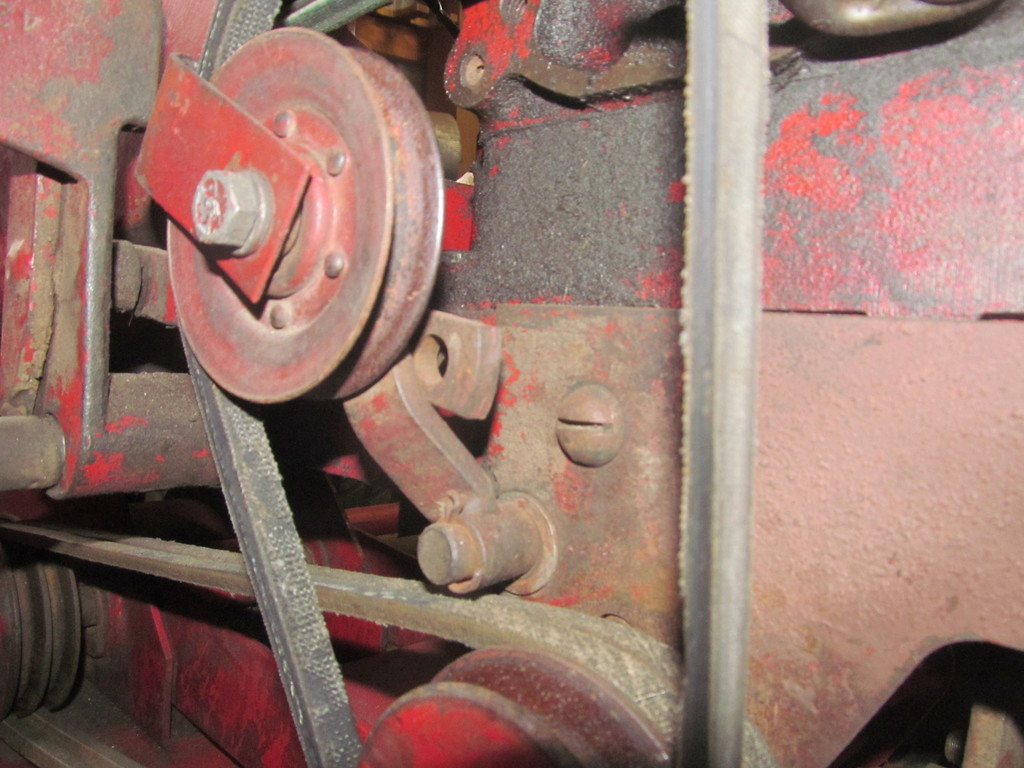

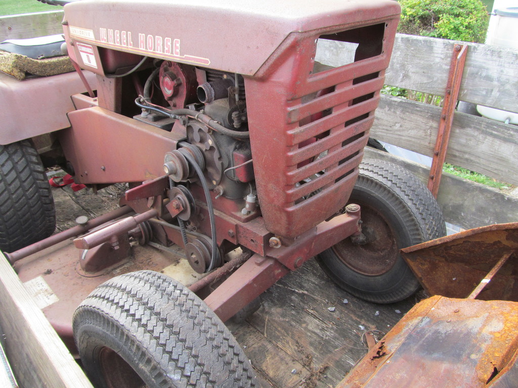

tallen4392 71 #1 Posted March 10, 2017 (edited) Trying to figure out where and how this pulley bolts on it is just dangling from the right side pedal hooked to a spring anyone have a pic of where this goes i have been looking for a good picture but cannot find one i know it is for assessorys like a mower deck but would like to figure it out... THANKS for all the help Edited March 10, 2017 by tallen4392 Share this post Link to post Share on other sites
Achto 31,047 #2 Posted March 10, 2017 Are you talking about the pulley for the PTO drive for the deck. Share this post Link to post Share on other sites
tallen4392 71 #3 Posted March 10, 2017 Yes it is attached to the pedal all the. Pics I see r like your u can't tell what it bolts to the frame or another bracket Share this post Link to post Share on other sites

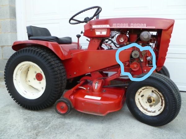

gwest_ca-(File Mod) 12,007 #4 Posted March 10, 2017 See if you can figure it out from this The parts illustration is better than the photos. Garry Share this post Link to post Share on other sites
Ed Kennell 44,955 #5 Posted March 10, 2017 (edited) That is the tensioning pulley for the deck drive belt. It is attached to the spring loaded pedal that pulls the pulley to the rear tightening the belt when the pedal is released. Edited March 10, 2017 by Ed Kennell 2 Share this post Link to post Share on other sites

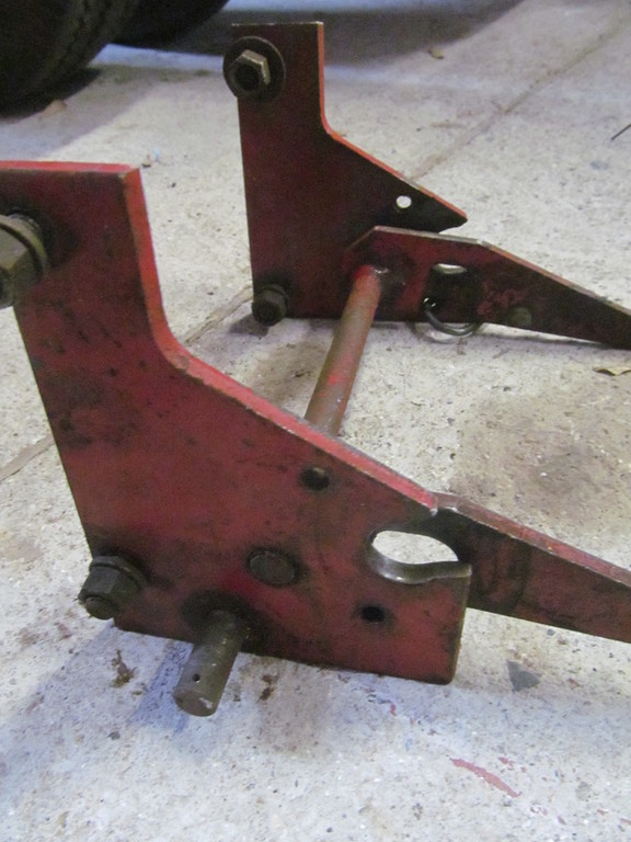

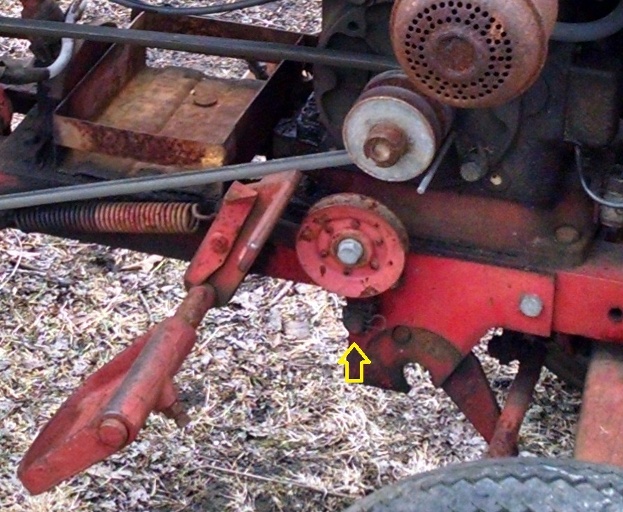

Achto 31,047 #12 Posted March 10, 2017 Here's another pic. The arm for the pulley mounts to the mid attach-o-matic plate then has a rod running to the peddle. Share this post Link to post Share on other sites

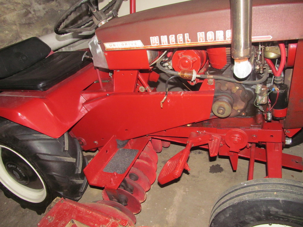

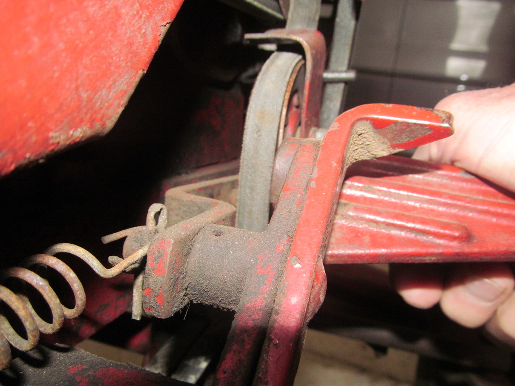

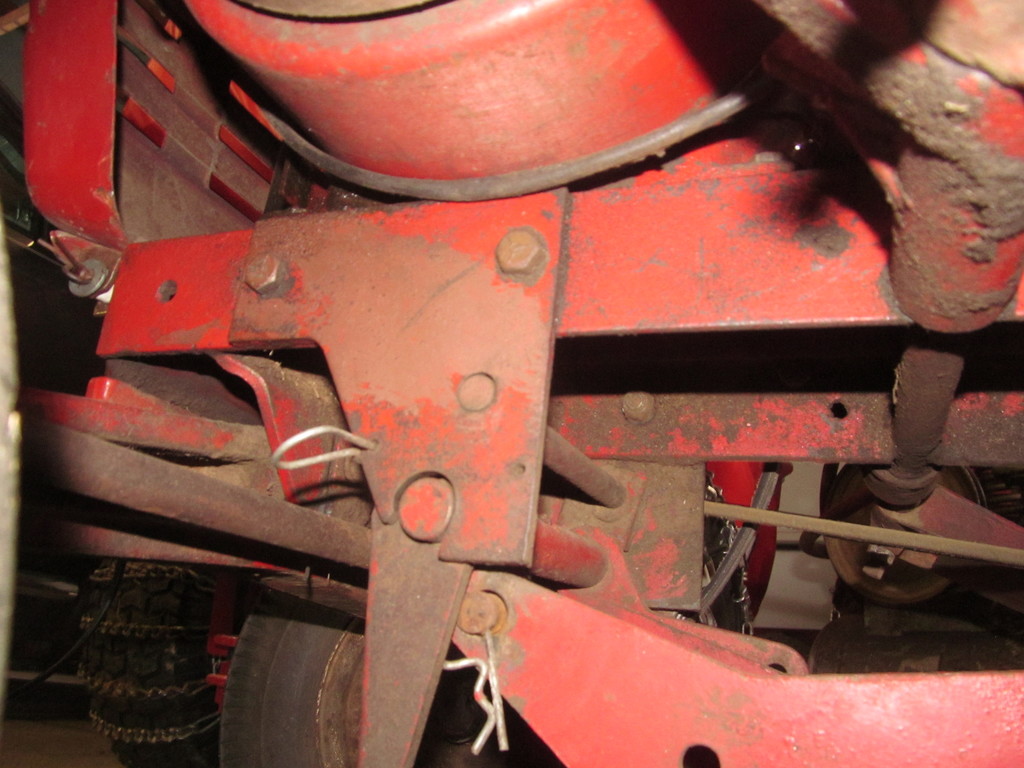

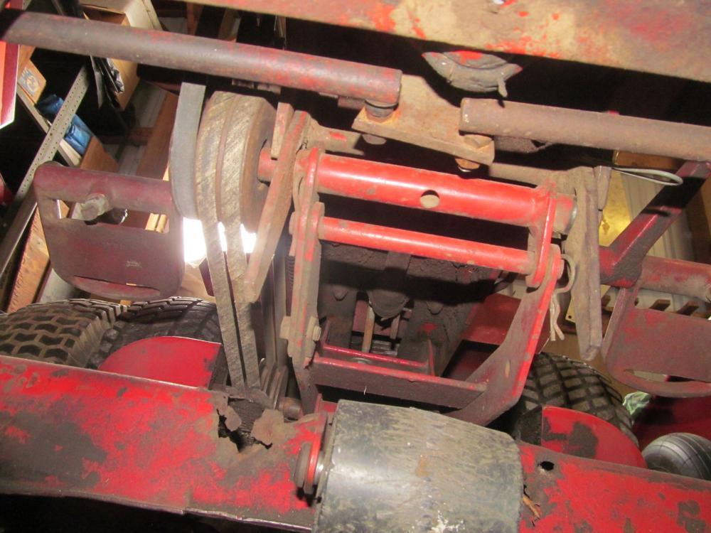

Ed Kennell 44,955 #13 Posted March 10, 2017 achtos pic with the deck off shows the tensioning pulley mounted on the attach-a-matic plate and the rub mark from the deck drive pulley. Here are some pics I took this morning of the 875. View from the front. See the pulley is on a swinging arm on the pin in the side plate and the swinging bar is connected to the pedal by another bar. And viewed from the rear showing the spring that pulls the pedal, link bar, and the pulley back to tension the drive belt. View from front underside of the deck mount and drive pulley. And the mid mount attach-a-matic that you need. Note the pin that the swinging pulley bar mounts to. Hope this helps. 2 Share this post Link to post Share on other sites
