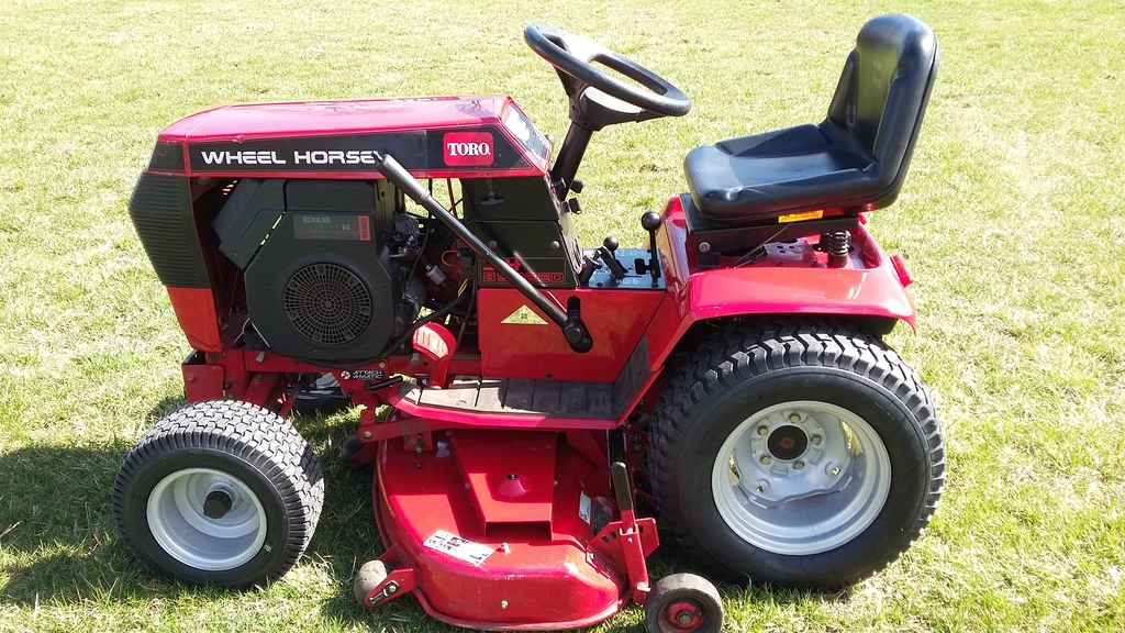

BOB ELLISON 2,983 #26 Posted March 16, 2017 20 hours ago, Amcwheel85 said: You stole that for sure. Almost looks new! This is the nicest wheel horse I've got now, and I only have 6. Just got new front tires for it and I think I'll order new for rear also. I did get a great deal and I know it. Share this post Link to post Share on other sites

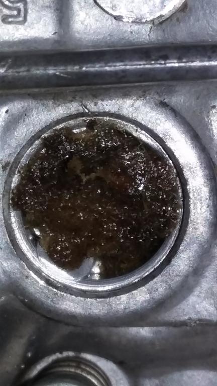

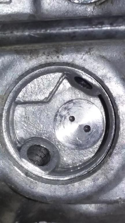

BOB ELLISON 2,983 #27 Posted March 23, 2017 Well just an update on my 314-8. I got it started and it would not run without choke out and I had to feather the throttle. After it got warmed up it would not idle and I had to still feather the throttle to keep it running , would not idle at all. So I started to read and found a post on how to rebuilds carb. Walbro LMK 1205380. NLA . So I found a replacement carb but I just had a feeling that it wasn't a bad carb just dirt that i missed . After viewing the website for rebuilding this type I seen him remove the welch plug to clean the holes for the idle. Well I ordered a rebuild kit and it comes with the welch plug. So I pulled the carb and removed the plug and wala I found the idle problem. I don't get the kit until tomorrow but I am confident that was the problem. Here is the pictures I took before and after. Share this post Link to post Share on other sites
Blasterdad 3,164 #28 Posted March 24, 2017 I bet she'll run & idle like brand new now! Personally, I love tracking down neglect issues & fixing them properly, it's a great feeling...(to me anyway) 2 Share this post Link to post Share on other sites

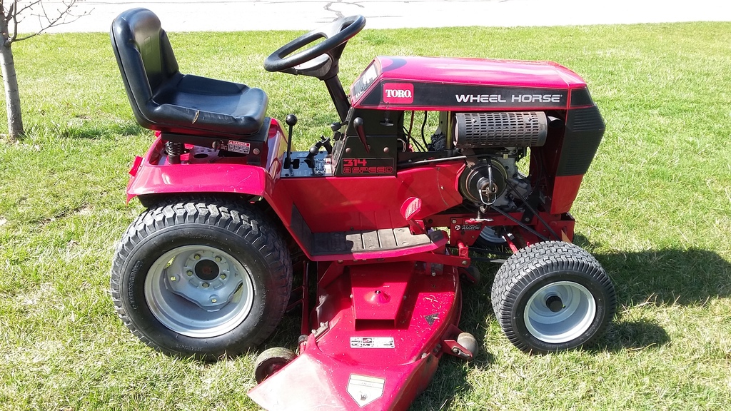

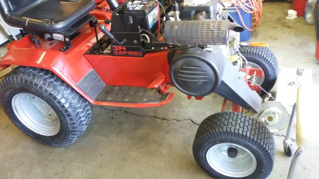

BOB ELLISON 2,983 #29 Posted March 24, 2017 I keep you guys up to date on my blessing. Ordered new deestone tires front and rear and got them on today. But still waiting for carb rebuild kit that I should have gotten today but didn't. (Sorry mail system anymore) I did do a little cleaning on the deck and it is in excellent condition with a few spots of surface rust a little paint will fix. 1 Share this post Link to post Share on other sites
BOB ELLISON 2,983 #30 Posted March 25, 2017 Well I got the carb rebuilt and it started up and idled like a champ. I did drive it around the yard and the steering is tight as a new one. Lots of power and I really like driving this tractor. Next thing is to put the deck under and give it a spin. 2 Share this post Link to post Share on other sites

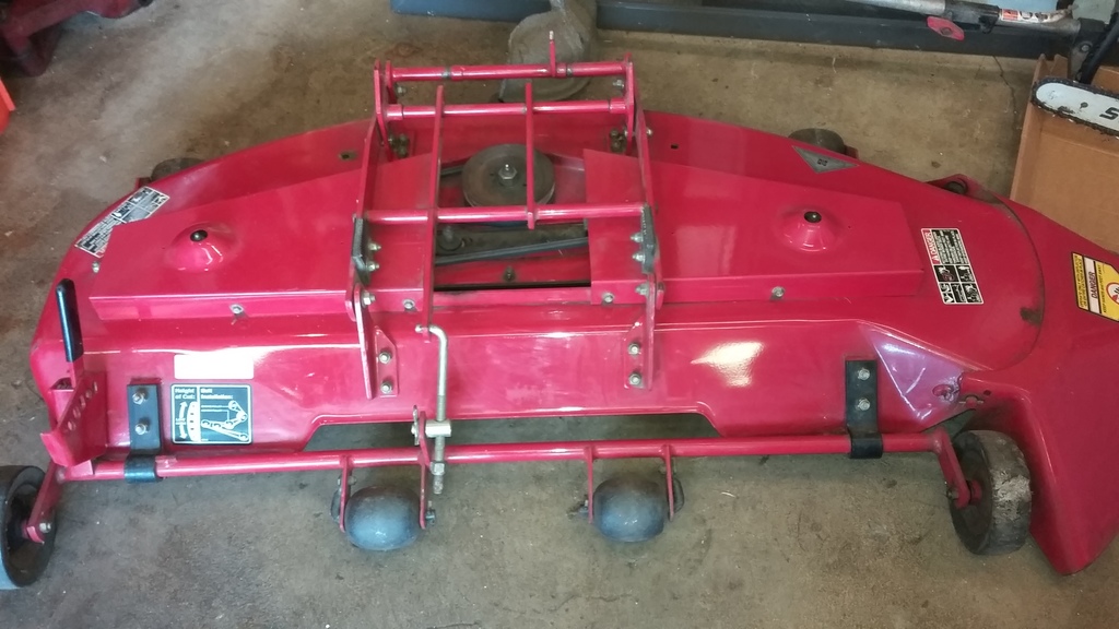

Blasterdad 3,164 #31 Posted March 26, 2017 Wow, that deck looks brand new, still has the stickers & guard on it! You were blessed for sure, don't forget to thank the man upstairs this Easter Sunday! Share this post Link to post Share on other sites

953 nut 66,672 #33 Posted March 26, 2017 (edited) Those little pieces of excrement in the carburetor came from ethanol fuel. Go ahead and clean the fuel system and use a new filter and fuel line, there is more of that stuff in the system for sure. Run some Seafoam in the fuel and only use non-ethanol gas. Buyrealgas.com Edited March 26, 2017 by 953 nut 1 Share this post Link to post Share on other sites

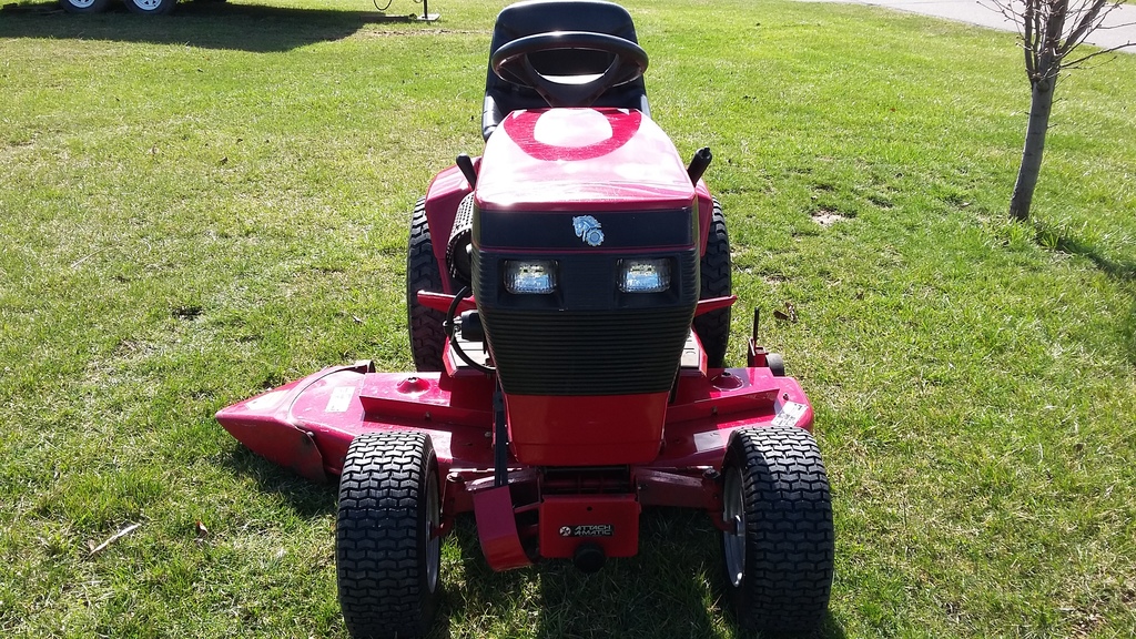

BOB ELLISON 2,983 #34 Posted April 2, 2017 Well this is the last post for this 314-8. When I picked it up it had 3 flat tires from sitting in a storage unit for 2 or more years. The PO didn't do upkeep so when I got it I had to go through it to see what it needed. First thing was charge battery (I DID PUT A NEW ONE ON LAST WEEK) Change oil and filter New plug Cleaned the mouse nest and dust off Checked all the wires and switches New tires front and rear New seat switch Grease all fittings Rebuilt carburetor AND THE DECK ( near new) Changed all the 6203 all 6 bearings New belt 94-2501( toro) deck to pto The steering is like a new mower it is tight and easy to steer. So that 200.00 tractor is now a $450.00 wheel horse Tried the mower and it's smooth and quiet the blades are like new. Next is the plow bracket and my wheel weights to put on. And I forgot to put the plastic belt cover back on for testing. 3 Share this post Link to post Share on other sites
