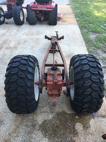

19richie66 17,937 #34 Posted March 17, 2017 (edited) I measured the tire height of the 27-9.50x15's that are on skittles and they measured just less than 26". The ones I am going to use measure out just at 27". While I was measuring the stock ones, I noticed one valve stem hole had some rot around it and the rims are really not that great. These are original tires so they have been on there a while.I am not planning on running tubes. So the plan now is to cut the centers out of the factory wheels and weld them into the ones I made. A lot of work but I have more time than money and the remodel is at a standstill. Nice thing about this is I can turn the 15" wheels around and this should give me plenty of room for backspacing/clearance. Think I might go with the 5 rib front. Edited March 17, 2017 by 19richie66 6 Share this post Link to post Share on other sites

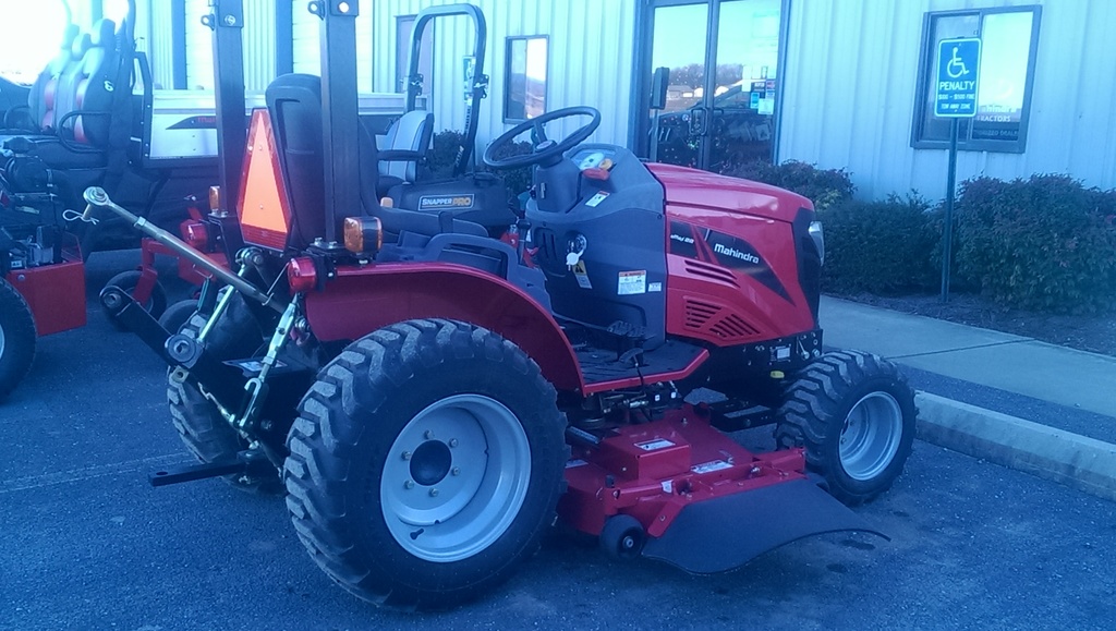

WVHillbilly520H 10,379 #35 Posted March 17, 2017 How about a set of Carlisle Titan 27x12.50-15 R4 tires? like on the eMax SCUT I just got last month, Jeff. 5 Share this post Link to post Share on other sites

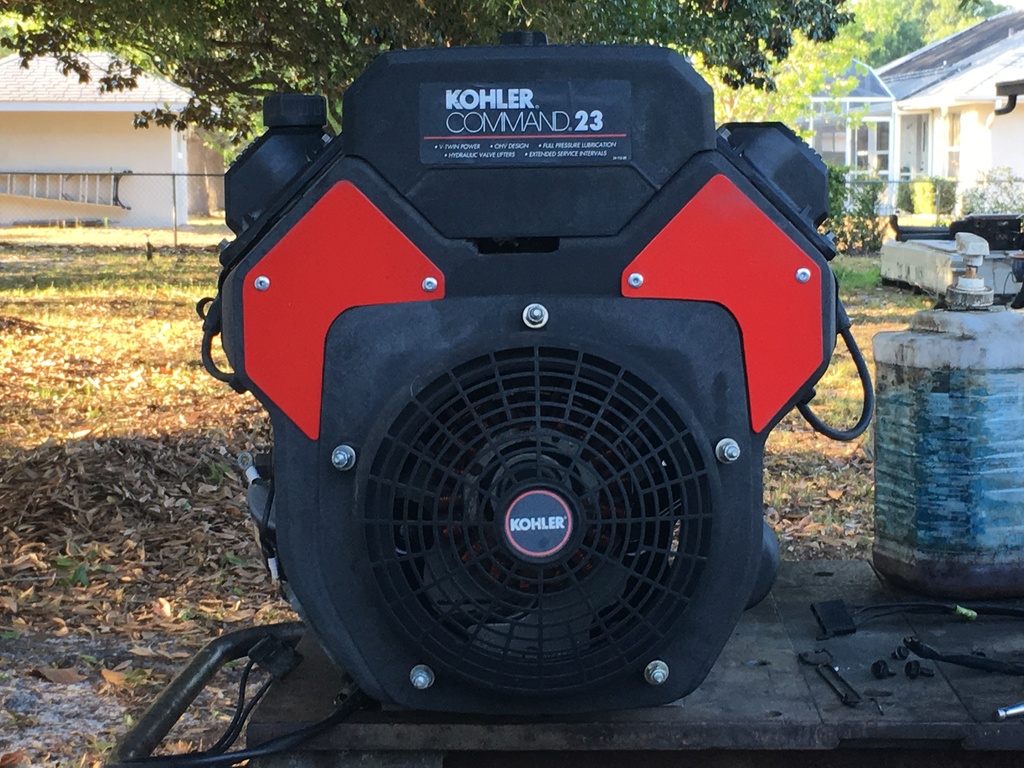

19richie66 17,937 #36 Posted May 20, 2017 (edited) The game plan. I'll leave it at that Edited May 20, 2017 by 19richie66 Took the eaton out of the plan for now 👍 4 Share this post Link to post Share on other sites
Texas Todd 1,026 #37 Posted May 20, 2017 4 minutes ago, 19richie66 said: The game plan. I'll leave it at that Oh My! I like it! 2 Share this post Link to post Share on other sites
953 nut 69,772 #38 Posted May 20, 2017 Do you plan to swap the GT-14 axles into the Eaton? It will be nice to have actual brakes that work won't it. That is my only complaint with my 14, can't just apply the brakes and stop! 2 Share this post Link to post Share on other sites
19richie66 17,937 #39 Posted May 20, 2017 (edited) EDIT.......(took the eaton out of the plan for now.) Well after remeasuring, it appears there is approx 5" difference in the rear axles, flange to flange. So unless I can get an extra set if 14 axles, Ill just leave it the way it is transmission wise. No big deal for now. Other things to conquer! Edited May 20, 2017 by 19richie66 2 Share this post Link to post Share on other sites
953 nut 69,772 #40 Posted May 20, 2017 1 hour ago, 19richie66 said: approx 5" difference in the rear axles, flange to flange If you find a pair of Ford rims with enough offset they will bolt up to the five hole flanges! May have to trim the center holes too. 2 Share this post Link to post Share on other sites
19richie66 17,937 #41 Posted May 21, 2017 I have a set of 15x10" rim shells and just need a set of wheel centers. I have a salvage yard near so when I get a chance to go searching Ill give it a go. I would even do a small wheel spacer if needed. We'll see. I appreciate the input! 2 Share this post Link to post Share on other sites

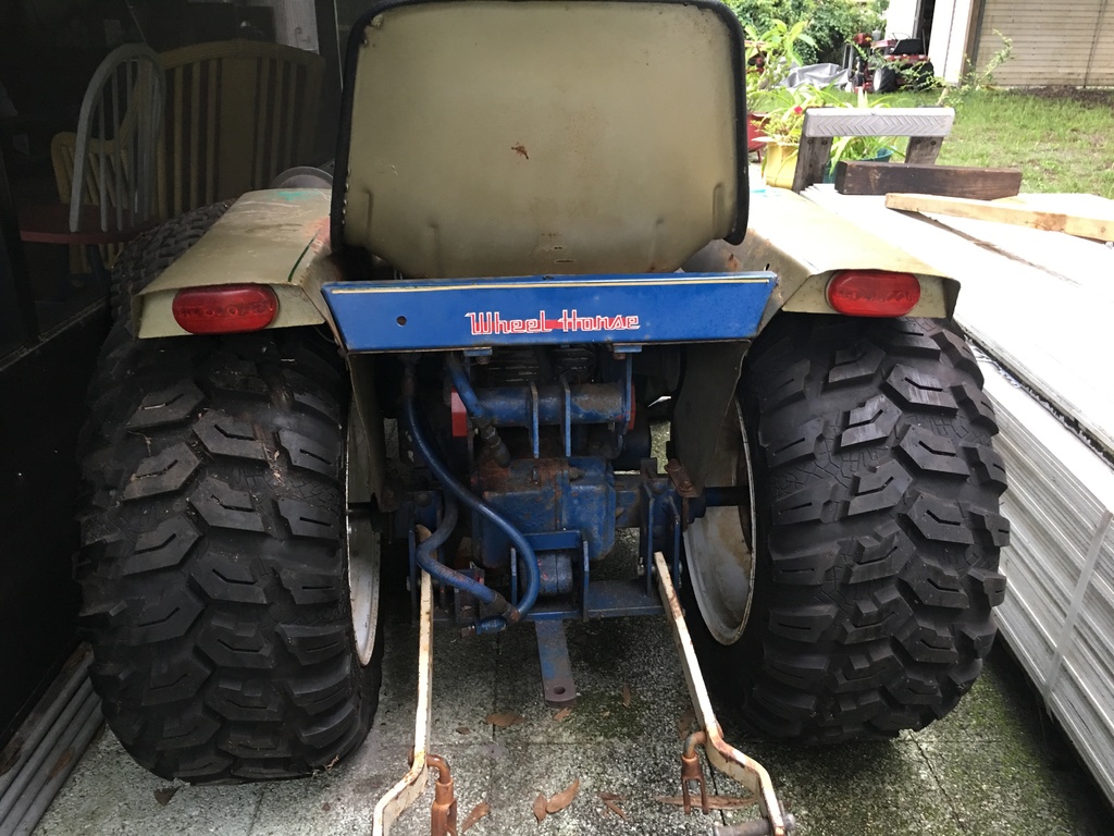

19richie66 17,937 #42 Posted June 30, 2017 Skittles got some new shoes 7 1 Share this post Link to post Share on other sites
Texas Todd 1,026 #43 Posted June 30, 2017 Phat! I like em! 1 Share this post Link to post Share on other sites

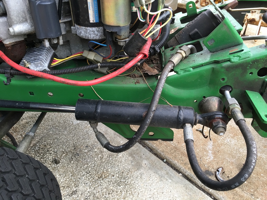

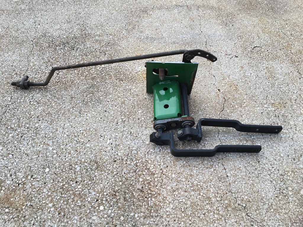

19richie66 17,937 #44 Posted July 27, 2017 Finally got a chance to cut up the "organ donor " for skittles. Got the foot control assembly out in one piece and almost have the power steering ready to come out. Removed the front cast iron grille in preparation for the heart transplant. Also got a complete transaxle on the way to snag the axles out of for the eaton 1100. Everything is falling into place. Fingers crossed 🤞 6 Share this post Link to post Share on other sites
953 nut 69,772 #45 Posted July 27, 2017 4 minutes ago, 19richie66 said: "organ donor " for skittles. Got the foot control assembly out in one piece and almost have the power steering ready to come out. Don't remember you telling us about the Green donor, tell us more please. 2 Share this post Link to post Share on other sites
JPWH 6,544 #46 Posted July 27, 2017 I was wondering if all that green would hold up under all that red. 1 Share this post Link to post Share on other sites
19richie66 17,937 #47 Posted July 27, 2017 The green Is just a protective coating till it gets painted red. 👍 The donor was a 2005 gx345. I had mowed with it till the deck got bent and I started using the 418-a to mow with. Everything on it cost over $100 to repair so it became an organ donor. 4 Share this post Link to post Share on other sites
