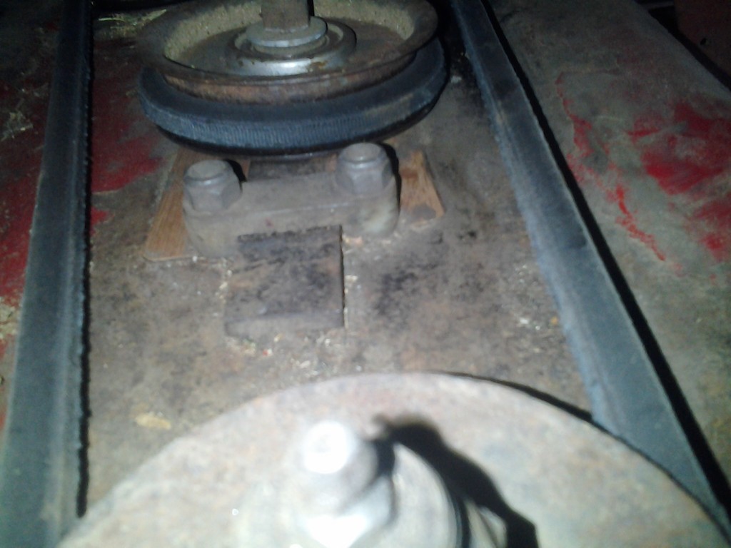

Texas Todd 1,026 #26 Posted March 3, 2017 54 minutes ago, ohiofarmer said: What i do is get a piece of Formica and make a full suspension slide that fits under the slide bar. I throw a wad of synthetic grease under it [to prevent rust] and use plumbers clear silicone grease on the top and slide bar after polishing the underside of the slide bar. Just cut some slots in the Formica to keep it in place between the tensioner bolts. The deck belt lasts forever or close to it I would like to see pictures of this upgrade if you have them. Sounds like a great idea! Share this post Link to post Share on other sites

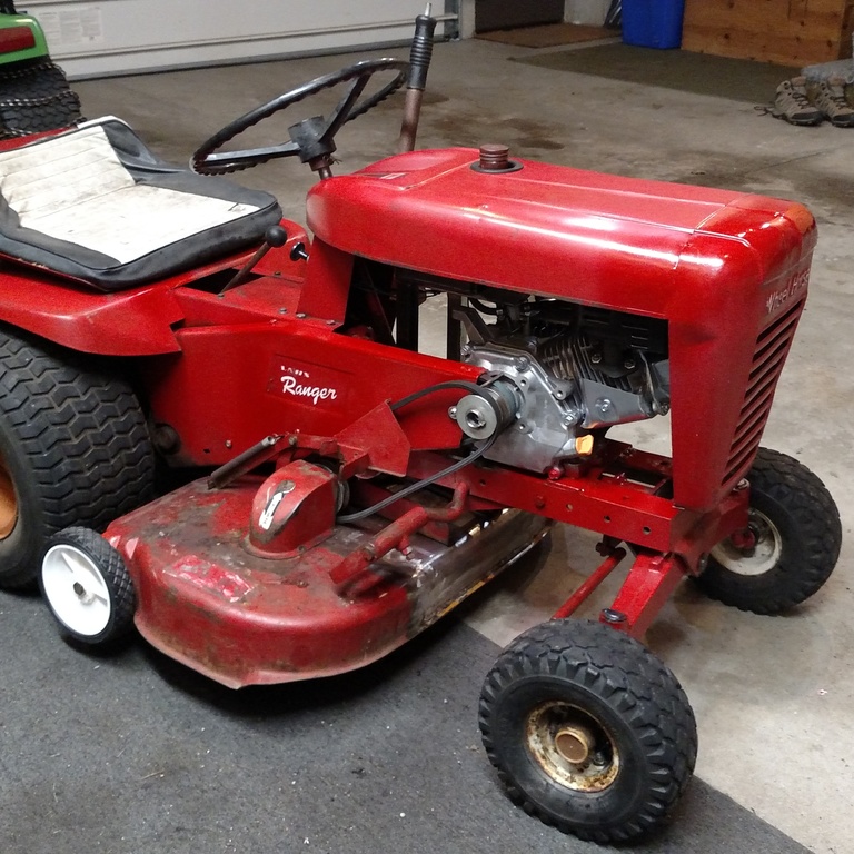

petes 150 #27 Posted March 3, 2017 Rub the tractor tins down with WD40 and 0000 steel wool, you might like what you see. Except for the touch up on the front of the hood, the rest is what came out from under the dirt. 1 Share this post Link to post Share on other sites
Blasterdad 3,168 #28 Posted March 4, 2017 10 hours ago, ohiofarmer said: Good on you for cleaning that deck. Look at all that rust under the belt guard What happens is all that dust combines with moisture and turns to rust. then the belt tensioner slide bar gets frozen and the deck belt has no shock absorber. Those little Delrin slides wear down and also they leave a gap under the slide bar for dirt to gather What i do is get a piece of Formica and make a full suspension slide that fits under the slide bar. I throw a wad of synthetic grease under it [to prevent rust] and use plumbers clear silicone grease on the top and slide bar after polishing the underside of the slide bar. Just cut some slots in the Formica to keep it in place between the tensioner bolts. The deck belt lasts forever or close to it I don't use belt guards and blow the mowing chaff out every few mowings, but that is your call on the belt guards. Congrats on a really great buy! You are correct, the slide bar was frozen & one of the spindle bearings was locked up so the shaft was just spinning in the race. I freed up the bearing but they are the old Double D non greaseable spindles, so I'm not going to waste too much time on them. I have a newer style of round hole greasable spindles I plan on using instead, too hard to find blades for the ol' Double D's anyhow. I've been wanting a 48" side discharge deck for many years, now that I have one I'm going to fix it right. There is a sign on the wall at the sandblasting company I go to that says, "If you don't have the time to do something correctly, when are you going to have the time to do it again?". Thank you for the tips, I love the Formica trick, I will give it a go! I agree about the belt guard too, big debris & water trap. Still a Wheel Horse part though, so I blasted & primered it anyhow. 2 Share this post Link to post Share on other sites
ohiofarmer 3,504 #29 Posted March 5, 2017 If you look close, you can see the piece of woodgrain Formica. Just notch it around the bolts of the slide retainer at each end and put that polished slide bar over the top 2 Share this post Link to post Share on other sites
Texas Todd 1,026 #30 Posted March 5, 2017 Interesting. Thanks! Share this post Link to post Share on other sites
