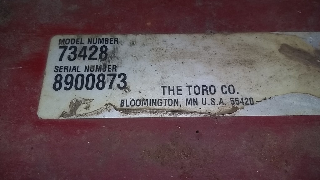

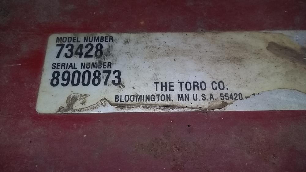

Gunman64 7 #18 Posted February 24, 2017 Sorry, I was wrong. I think now it was a 1998. Toro model, was those still as good as the original Wheel Horse? Share this post Link to post Share on other sites

gwest_ca-(File Mod) 12,013 #20 Posted February 25, 2017 12 hours ago, Gunman64 said: Sorry, I was wrong. I think now it was a 1998. Toro model, was those still as good as the original Wheel Horse? Same tough design Garry 1 Share this post Link to post Share on other sites
