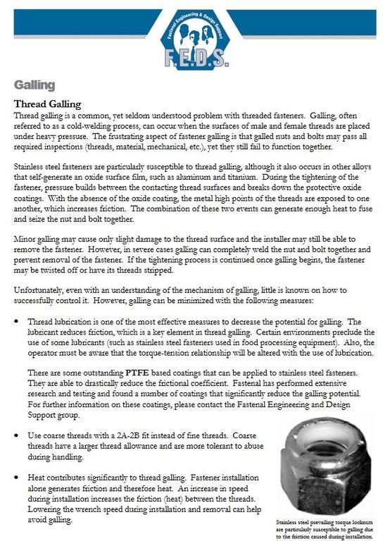

Racinbob 12,780 #9 Posted February 22, 2017 That's an interesting article Paul. I've had that happen a few times. It acted like I cross threaded things but I knew I didn't. I never thought about galling. 1 Share this post Link to post Share on other sites

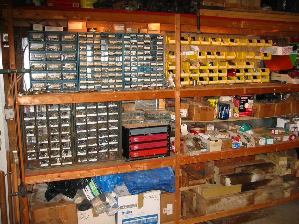

pfrederi 19,931 #10 Posted February 22, 2017 When you live in the country it is best to have hardware on hand. Having other hobbies only makes it more necessary. Mil Veh like Gr8 NF, Farm Tractors like bigger stuff Lower Left is Gr8 NF Stainless and Galvanized, Upper left 1/4 to 3/8 various styles also nuts washers etc...yellow bins longer bolts 1/4 to 1/2" Lowery right 9/16 to 1-1/8" bolts nuts...There is a separate section not in photo for 5/8" nuts bolts. Some of us have horse addictions some other addictions 16 Share this post Link to post Share on other sites
Jerry77 1,218 #11 Posted February 22, 2017 1 hour ago, pfrederi said: Some of us have horse addictions some other addictions Yeah, when I was working in an industrial setting I never stepped over a bolt, nut or washer in the parking lot or anywhere else for that matter ( still don't) and I had to get an upright bolt bin from Larson to fit them all into --don't make sense to spend gas money to go to town for a bolt or nut.. 2 Share this post Link to post Share on other sites

KC9KAS 4,746 #15 Posted February 22, 2017 6 hours ago, Racinbob said: That's an interesting article Paul. I've had that happen a few times. It acted like I cross threaded things but I knew I didn't. I never thought about galling. Yep, Stainless Steel bolts/nuts seem to gall real easy! Share this post Link to post Share on other sites

R. L. Addison 300 #20 Posted February 23, 2017 I'm not fond of stainless as I've had to remove too many broken ones. They are not hard enough to withstand trying to use a small center punch, (they will mushroom and become more contrary) and they are as difficult to drill as bronze or copper, then can swell when an extractor isused to try to remove them. 316 may be an exception as it did not drill & tap as easily as grade 8 bolts. My $.02 1 Share this post Link to post Share on other sites

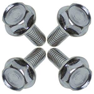

cleat 8,741 #24 Posted February 23, 2017 (edited) I also use lots of SS with never seize on my tractors and implements but I get a good price from work (free). However, I have been sandblasting and painting with high temp black (seems to be tougher and I like the finish) some of the bolts with the integrated molded in washer with little locking teeth. These seem to be found everywhere on a Wheel Horse. These are a pain to sandblast and paint but sometimes look better that a regular bolt and a lockwasher, flat washer combination. Even with painted bolts, a little never seize is used. My machines never sit out but why not. Cleat Edited February 23, 2017 by cleat 2 Share this post Link to post Share on other sites
Sarge 3,470 #25 Posted February 25, 2017 If you must use stainless , stick to the 316 or 18-8 variety as they hold up to torque better and have a lesser chance of galling . The copper based anti-seize is a must as well , plus it prevents corrosion later . Sarge 1 Share this post Link to post Share on other sites
