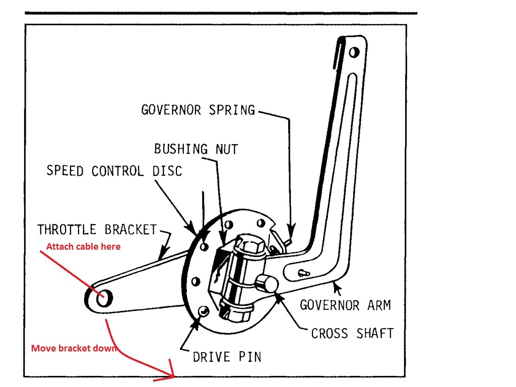

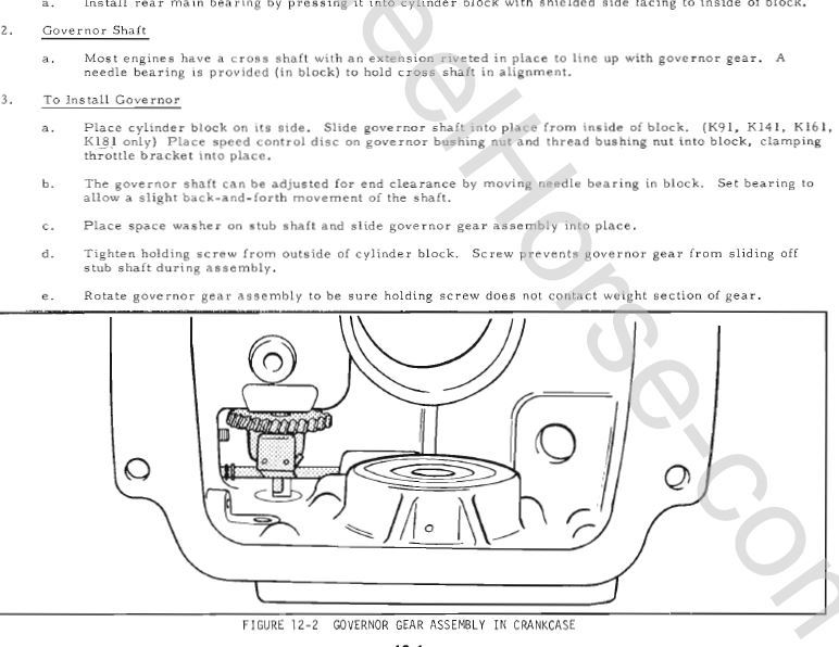

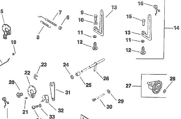

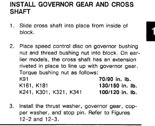

nigel
Hi we had all that off but the shaft is still very stiff has anyone got a diagram of what's on the other end of the shaft to give us some idea what's going on and any ideas on sorting it please
pfrederi
Edited by pfrederi
  • Like 6

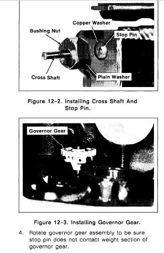

nigel
Umh ! Many thanks for the diagrams, looking at them I still can't understand why my crossshaft is so tight ? Any ideas please

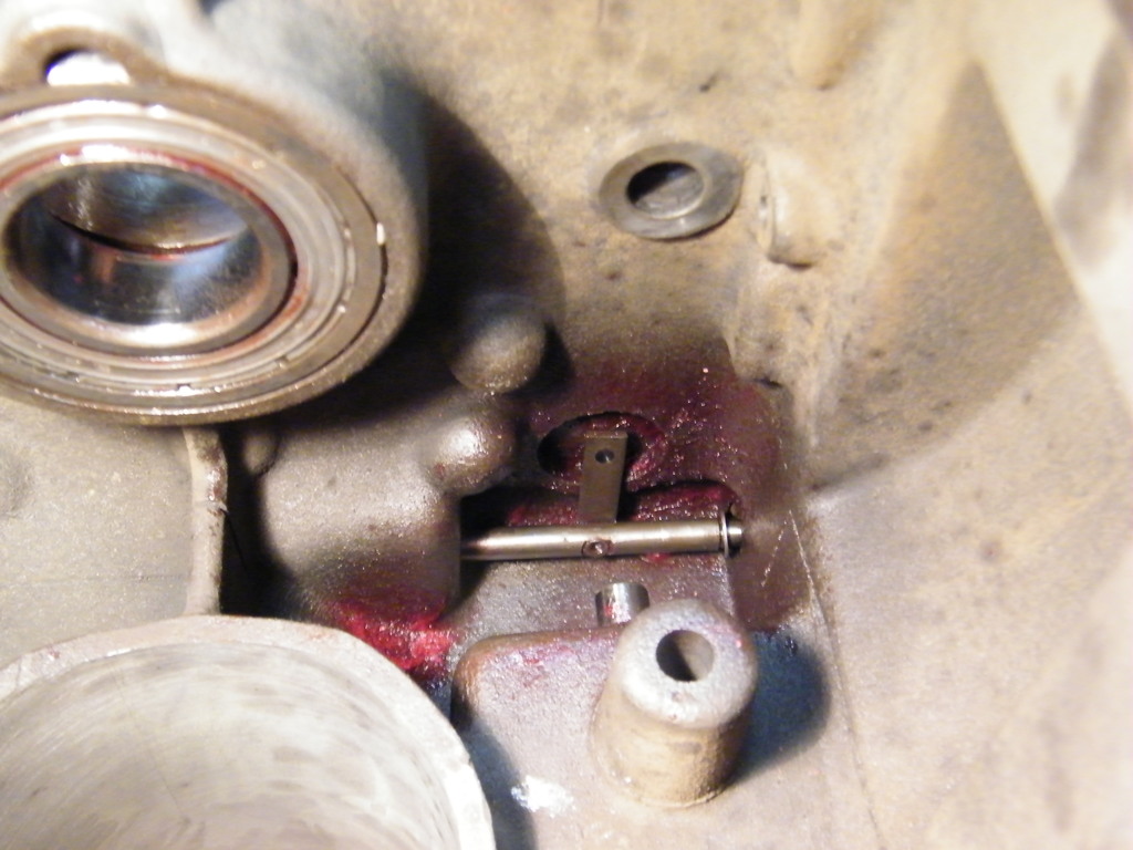

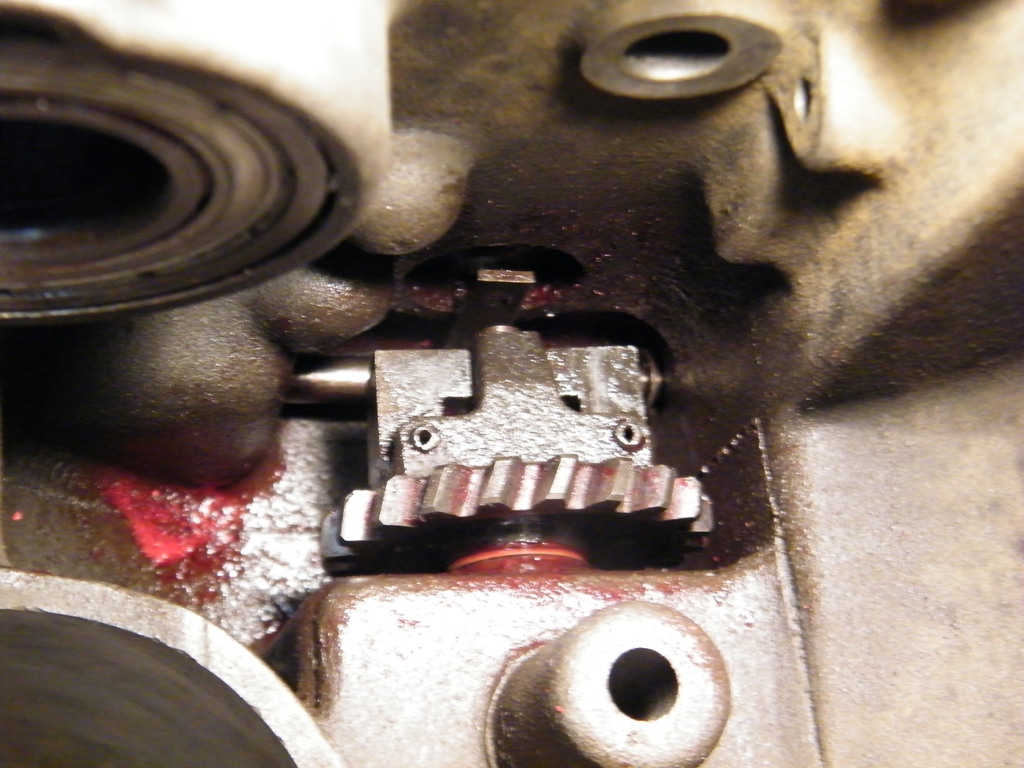

stevasaurus

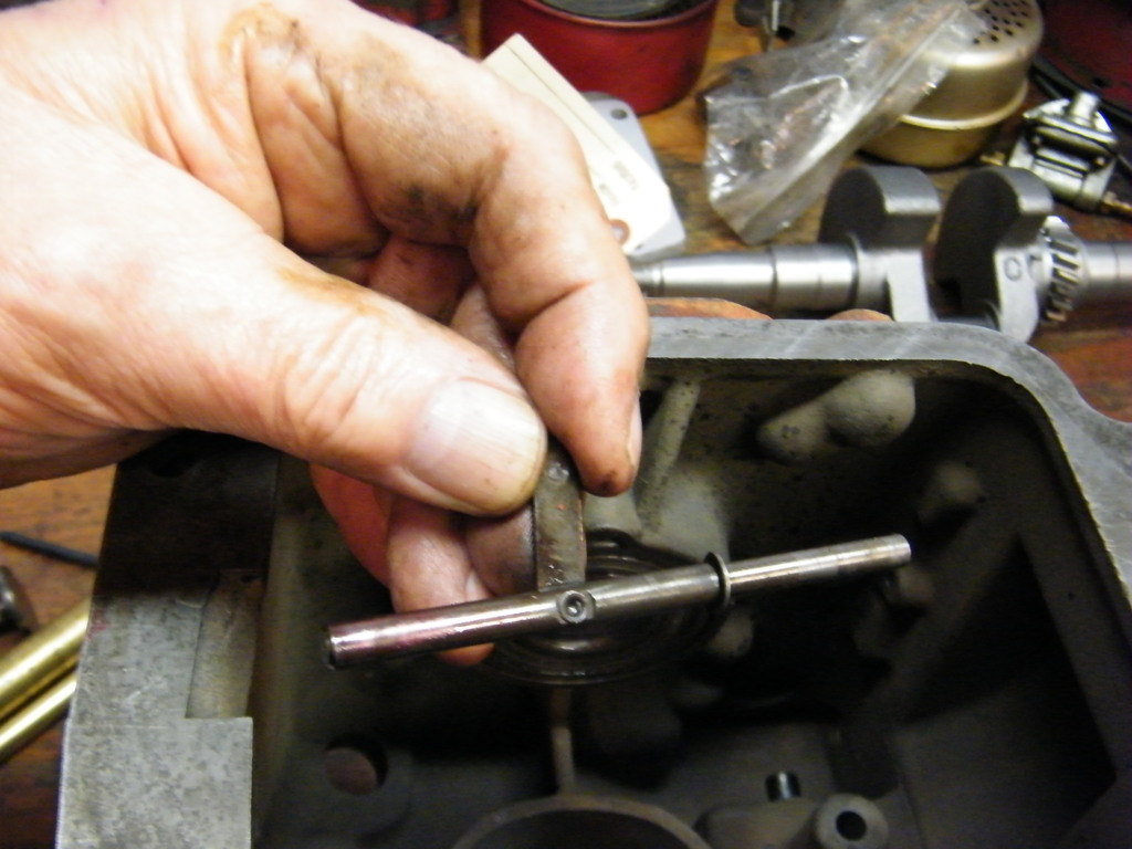

This is from a K 181, but I'll bet it looks the same.  I'm holding the shaft in my hand in the 1st picture.  See that little washer to the right...that butts up to the block when tightened.  It could be sticking a little.
   The 2nd picture shows the shaft and gear in place.  The shaft sits into the block on the left...if something is stuck in there (and it does not take much), that could be the issue.  You would have to take the engine apart in this case.  May be able to move it around enough in the 1st picture.

stevasaurus

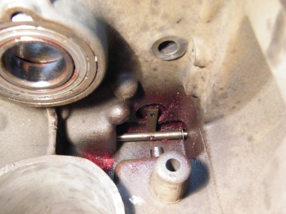

I had the same problem when I rebuilt this engine.  I must have taken it apart 3 times.  See the red in the pictures, that is grease that I bought in a spray can,  I sprayed some into where the left hand side of the shaft goes into the block, and it was enough to stiffen the shaft when I put the rest together.  Sprayed carb clean in the block hole and that did it.  The other thing, is that washer on the shaft.  Before I figured out the grease thingy, I tried a thin washer on the outside...keeping the nut a little farther out.  It worked, but I knew it wasn't right.  I did not need the extra washer before the re-build.  That is when I went inside and found the grease.  If this engine has been sitting, something could have dried out in there...it does not take much.  This shaft is near the top of the engine and probably does not get tons of oil.
Nigel....does the shaft feel good when you just snug it and it tightens up after torquing ?  That is what I had.  :)

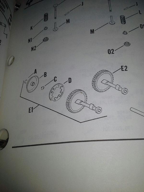

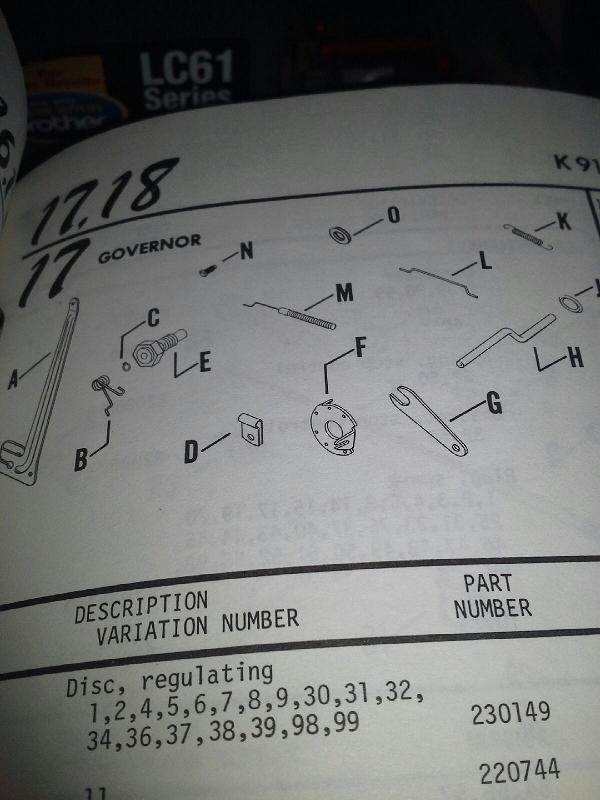

diesel cowboy

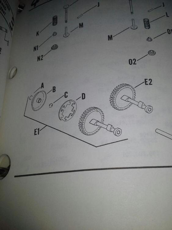

I dug out an older paper copy of the parts book for the K91.  Here's the pics of the gov. linkage and the internal parts.  It appears that the K91 has a completely different setup to the bigger engines.  I've never worked on one of these but the stiffness might be  on the internal parts hooked to the cam parts listed as A B C and D and part D is refered to as a flyball retainer and if those parts are rusty/sticky it could make it hard to move.        Hope this helps.                   Stewart
  • Like 2
