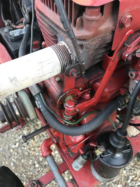

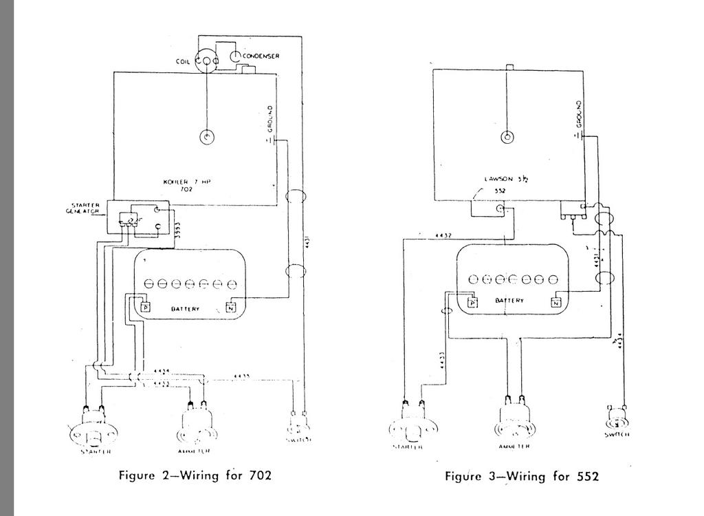

carlosking450 161 #31 Posted October 12, 2017 Good morning friends, I need to continue with the repair of my 702 I would like to know how the cables of the starter and accelerator are placed, could you put photos to me? thanks Share this post Link to post Share on other sites
wheelhorseman 3,244 #32 Posted October 12, 2017 (edited) Edited October 12, 2017 by wheelhorseman 1 Share this post Link to post Share on other sites
carlosking450 161 #33 Posted October 12, 2017 Thank you wheel horseman but I need photos with the fasteners to go by placing the throttle cable and starter Share this post Link to post Share on other sites
wheelhorseman 3,244 #34 Posted October 12, 2017 Ok I can get some this afternoon Share this post Link to post Share on other sites
carlosking450 161 #35 Posted October 12, 2017 thank you very much very kind Share this post Link to post Share on other sites
wheelhorseman 3,244 #36 Posted October 12, 2017 (edited) Is this what you need? Edited October 12, 2017 by wheelhorseman 1 Share this post Link to post Share on other sites
carlosking450 161 #37 Posted October 13, 2017 Yes very thanks¡¡¡ Share this post Link to post Share on other sites

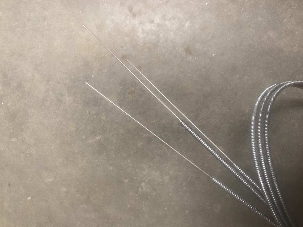

carlosking450 161 #41 Posted October 30, 2017 On 13/10/2017 at 12:40 AM, wheelhorseman said: ¿Esto es lo que necesitas? Hi, my friend, I have a question about the accelerator cables that I bought, the tip of the new cable is straight and the old one is bent like an "s" so that it does not escape, should I bend it with a pliers to the new cable? Share this post Link to post Share on other sites

wheelhorseman 3,244 #44 Posted October 31, 2017 (edited) 6 hours ago, carlosking450 said: Hi, my friend, I have a question about the accelerator cables that I bought, the tip of the new cable is straight and the old one is bent like an "s" so that it does not escape, should I bend it with a pliers to the new cable? Yes you are referring to the throttle cable they come straight on the end so you can cut them to the length so to answer your question yes install it in place then cut it to the length that you need then put the bend in it - here is what he is referring to. Edited October 31, 2017 by wheelhorseman Share this post Link to post Share on other sites
