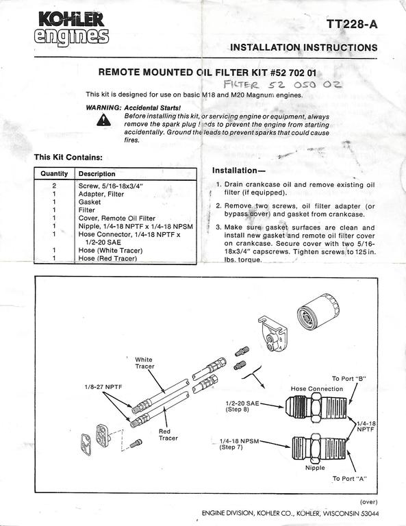

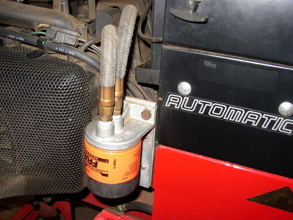

SPINJIM 1,997 #26 Posted February 21, 2017 (edited) 11 hours ago, pfrederi said: If you get a chance could you take a couple pictures of the oil filter set up. I do not know why WH didn't spec the filter (especially on the 418C commercial use version) other companies did. I would like to rig up something like it on my 418A Filter is mounted on left side, and hoses are routed behind the rear cylinder to the adapter port on the back PTO side of the case. No room for the filter without the adapter kit. Sent the info on the oil Filter Kit as a pdf file as well. Jim WH oil filter.pdf Edited February 21, 2017 by SPINJIM 2 Share this post Link to post Share on other sites

smoreau 658 #30 Posted February 22, 2017 (edited) Next time she complains about the # of tractors, tell her that would be fine as long as she gets rid of some of her shoes. As for the KT series twins. Leave the oil filter kit on. It will double the life of the oil and will make the engine last longer. I have 2 417A's and a 520 with a repower of a 18hp magnum engine and 2 of them have this kit on them. I have rebuilt 2 KT17's and both of them failed due to junk in the oil pump locking it up and braking the plastic gear. The filter helps to prevent this. If you don't like its location you can make a bracket to fit it further inside. Or in a different spot will work also. If you blow up the pic below you can see mine are further in. And last thing. Put on a Kohler filter avalible at any tsc or small engine shop. From filters are about the cheapest made filters made. If you don't believe me cut one open and cut open a good brand an you will see what I mean. Edited February 22, 2017 by smoreau 3 Share this post Link to post Share on other sites

SPINJIM 1,997 #33 Posted February 22, 2017 2 hours ago, smoreau said: Put on a Kohler filter avalible at any tsc or small engine shop. From filters are about the cheapest made filters made. If you don't believe me cut one open and cut open a good brand an you will see what I mean. I agree. I'm not a fan of Fram filters. Also, the orange is ugly on a red & black tractor. I'll pick up a black Kohler filter tomorrow. Jim 1 Share this post Link to post Share on other sites
