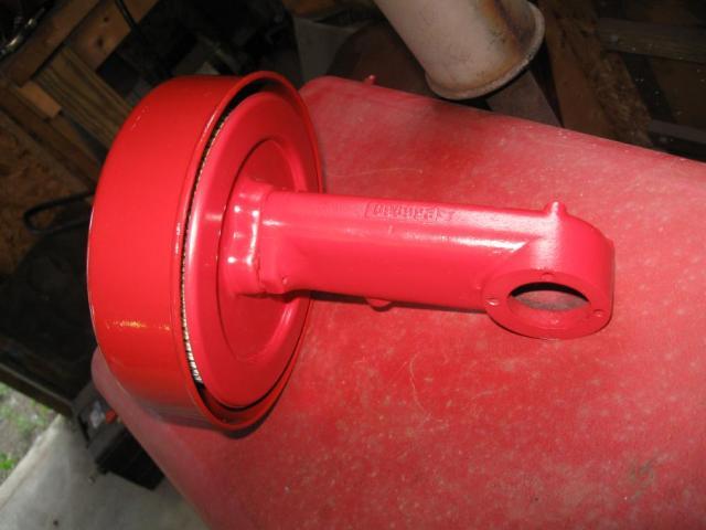

953 nut 64,169 #7 Posted February 16, 2017 Would the elbow from a GT-14 provide enough clearance? Share this post Link to post Share on other sites

Chris G 3,369 #11 Posted February 17, 2017 On 2/16/2017 at 6:26 AM, 953 nut said: Would the elbow from a GT-14 provide enough clearance? I never thought of that. But I think you may have solved a problem for my rat 702 build! 2 Share this post Link to post Share on other sites
