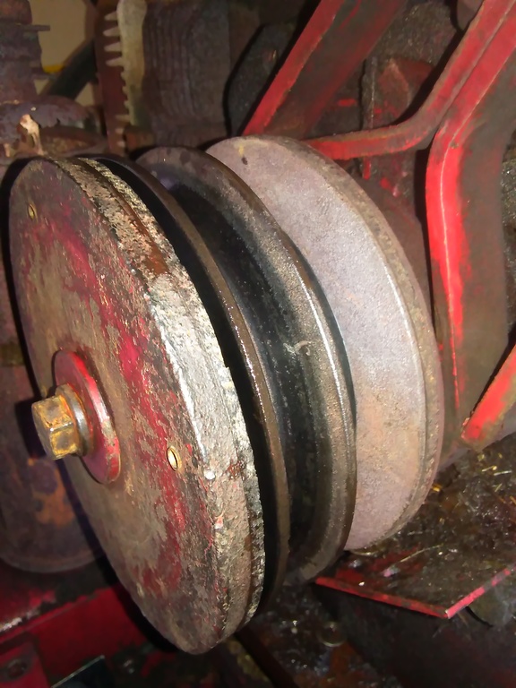

rexman72 210 #27 Posted February 18, 2017 28 minutes ago, 953 nut said: Water in a hydraulic system will flash to steam and produce heat when pressurized. Your pump is the low point in the system and oil floats on water; could be the problem. I think I found the issue.The guard on the pto is worn out and I don't even need to engage the pto to run the loader.I had the same problem when I was burning belts on the 417A.I changed the guard and that problem went away. 1 Share this post Link to post Share on other sites
rexman72 210 #28 Posted February 18, 2017 finally figured it out.the pully on the pto was stuck to the outside causing it to heat up.I freed the pulley. 1 Share this post Link to post Share on other sites
