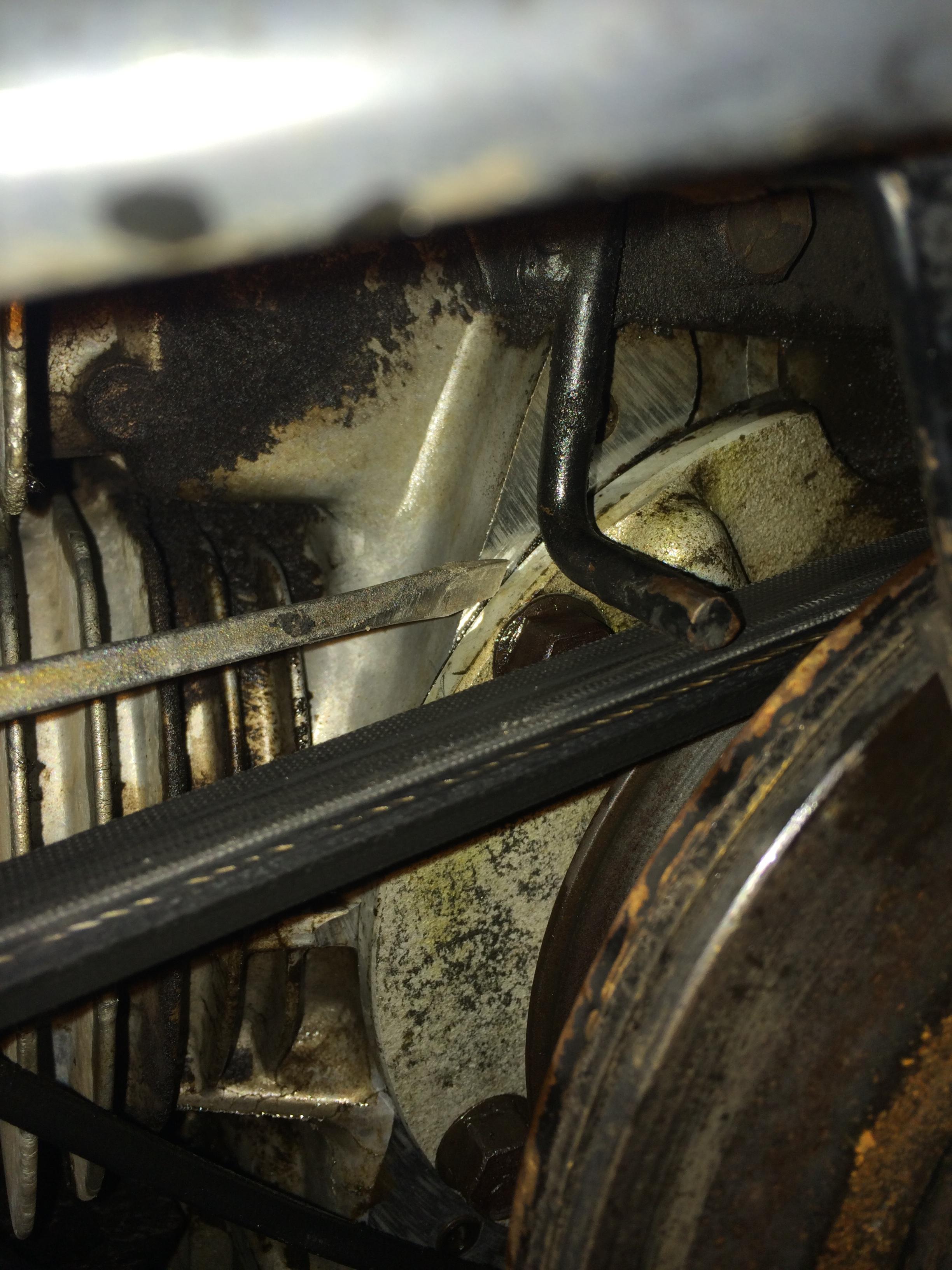

Josh Fairchild 1 #1 Posted February 13, 2017 Hello guys, new to this site. I have a wheel horse 518H with 18 hp Onan engine. Leaking oil pretty badly around the seal at the tip of the screwdriver. What is that? And would it be hard to replace? Thanks 1 Share this post Link to post Share on other sites
Jgoodsell 19 #2 Posted February 13, 2017 That looks to be the bearing plate. Part number is NN10008 or 101-0439-01. I am not sure how hard that as at the moment, but I would not wait to fix it at all. I located it in the Parts Catalog that you can got off from here. 1 Share this post Link to post Share on other sites
GMan 82 #3 Posted February 13, 2017 Josh, Might be just leaking around the bolts...........They are threaded through into the crankcase. If that is the case you could drain your oil and take them out one at a time, clean them and the holes with a suitable solvent, apply Locktite thread sealant and re-install them tightening them to spec. However, the gasket behind the bearing plate might be leaking in which case you might have to replace it. I would do the bolt thing first. What do you have to lose? Now, having stated all this, there is a seal around the crankshaft that is pressed into that bearing plate. If that is the case the clutch will have to be removed to access that seal but it can be replaced without pulling the engine...................Gary 2 Share this post Link to post Share on other sites
1995 520H+96+97 938 #4 Posted February 13, 2017 Show us a picture of the cap that looks like a frost plug, forward and up a little from your picture. Share this post Link to post Share on other sites
bmsgaffer 2,069 #5 Posted February 14, 2017 Also, just try tightening the bolts that hold on the bearing plate. I have read of a couple of people that just had to tighten that plate up to stop the leak. Or at least slow it to nearly stopped. 3 Share this post Link to post Share on other sites
