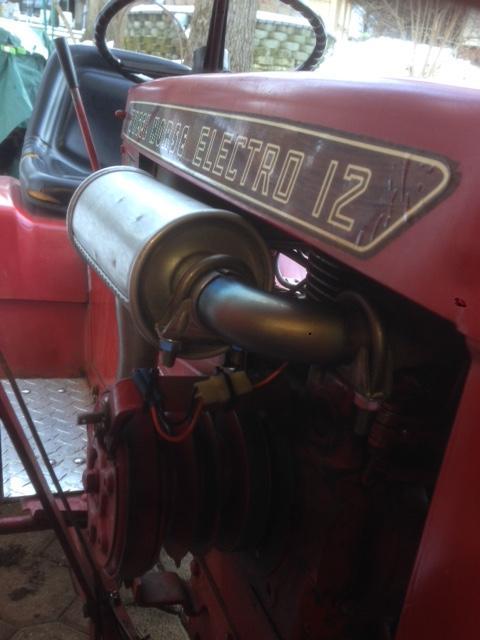

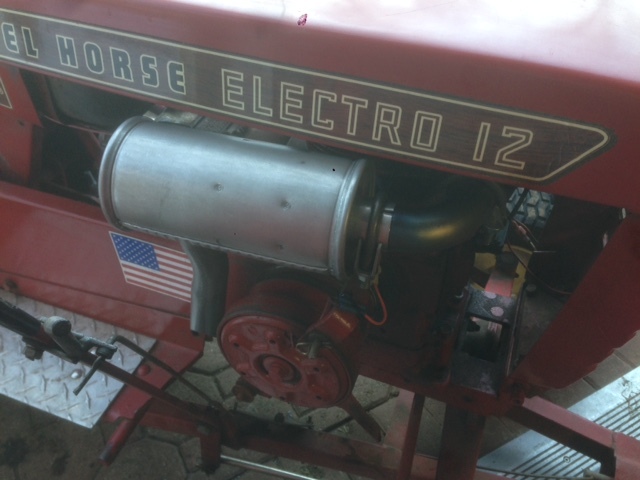

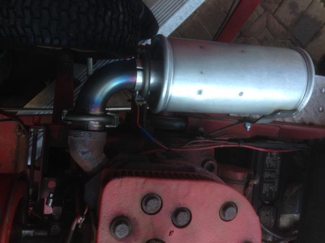

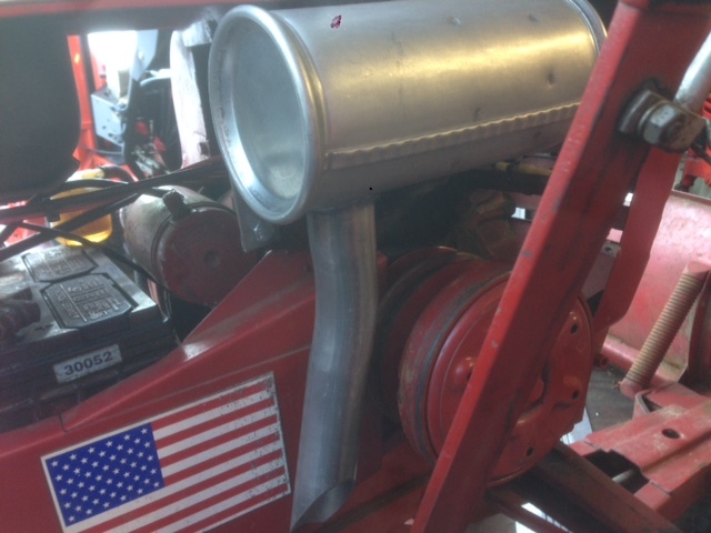

bottjernat1 2,197 #27 Posted September 10, 2020 On 2/14/2017 at 5:44 PM, formariz said: Well, call me crazy but here is what i decided to do with the "Jay Bee" muffler on the Electro 12. It was not bought for it but it needed one so I decided to use it. There is no room in front of engine and behind hood for it. From the air filter to the hood everything interferes.If the muffler's body was about 3" shorter then with some clever plumbing it would work but still be tight. If hood was as wide on bottom as on top even better, but it is what it is on this model. When I got this tractor from Ken B. it had a long muffler mounted horizontally which is the best way for this model as you can see on first photo. The only draw back was that the outlet on long muffler was too close to operator and one winds up having some exhaust on the face area. So based on how it was then I mounted this one also horizontally. Since it has the outlet on the side with the long pipe exhaust is directed much lower than before. No interference with PTO or implement belt changes. I will also probably fabricate an extension and have it directly under foot board aimed away from tractor. Fabricated metal bracket to attach to mufflers bracket for additional support . The Electro was always a noisy tractor specially at full throttle. Although still a bit noisy compared to others now one notices engine noise rather than muffler. At idle it is very quite and at full throttle it has a nice "throaty" sound. Sounds really solid unlike before. The original muffler fell apart inside with the loose baffles actually plugging the exhaust outlet and I bought another one like it for about $35.00 only to have exactly the same thing happen after one year. This muffler is heavy at 3Lbs 9-1/2ounces compared to a tall stack muffler with the flap on top which is only 3Lbs 1-1/4 ounces. It should last forever now. Is that an original style muffler for the electro? My daughters i just have a round simple muffler. Share this post Link to post Share on other sites

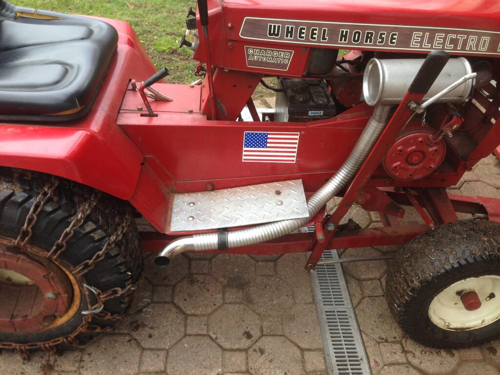

formariz 12,381 #28 Posted September 10, 2020 (edited) The small round muffler is the original type to it I am sure. I now have finished "plumbing" muffler pipe under foot rest coming out of rest's back. photo is earlier version of "plumbing", it now goes directly under foot rest.Very happy with the way it works and sounds. Edited September 10, 2020 by formariz 1 1 Share this post Link to post Share on other sites
